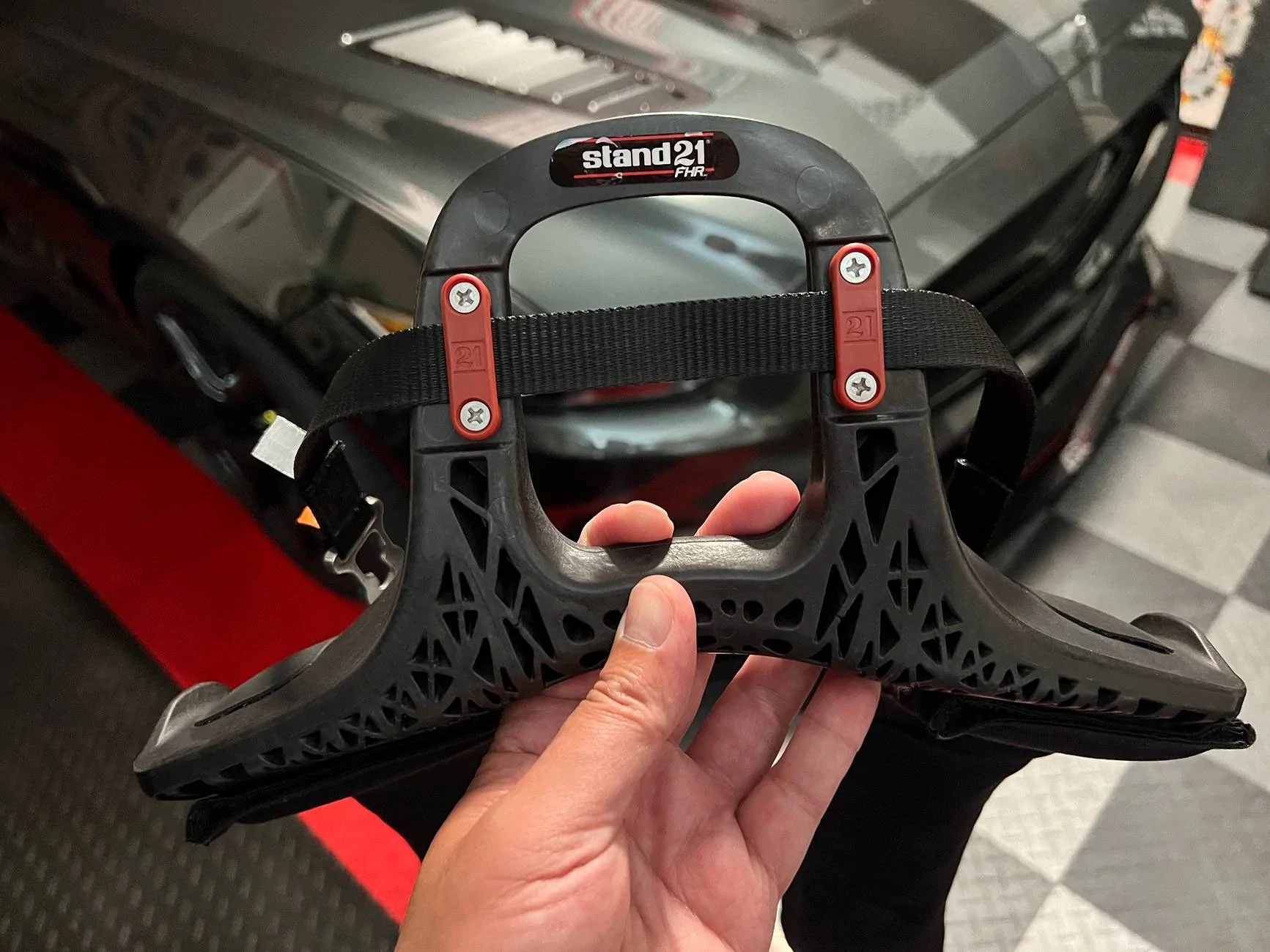

If anyone is in the market for a HANS, I would recommend the “Stand 21” brand. That manufactured HANS units (in France I believe) under license and once the license expired, they just made their own models under their name. High quality, strong as hell and half the price.

@CobaltFilly , you got a HANS right?
If not, look into Stand21. They were a licensed manufacturer for HANS brand but their license expired so they started producing under their own name. It a quality part.
Fresh to the sport and very young, trying to learn everything I can and not buy things twice.
So no, will grab one of those. Heard about them and have them high on my list of what to get next for car after brake cooling and better pads.
