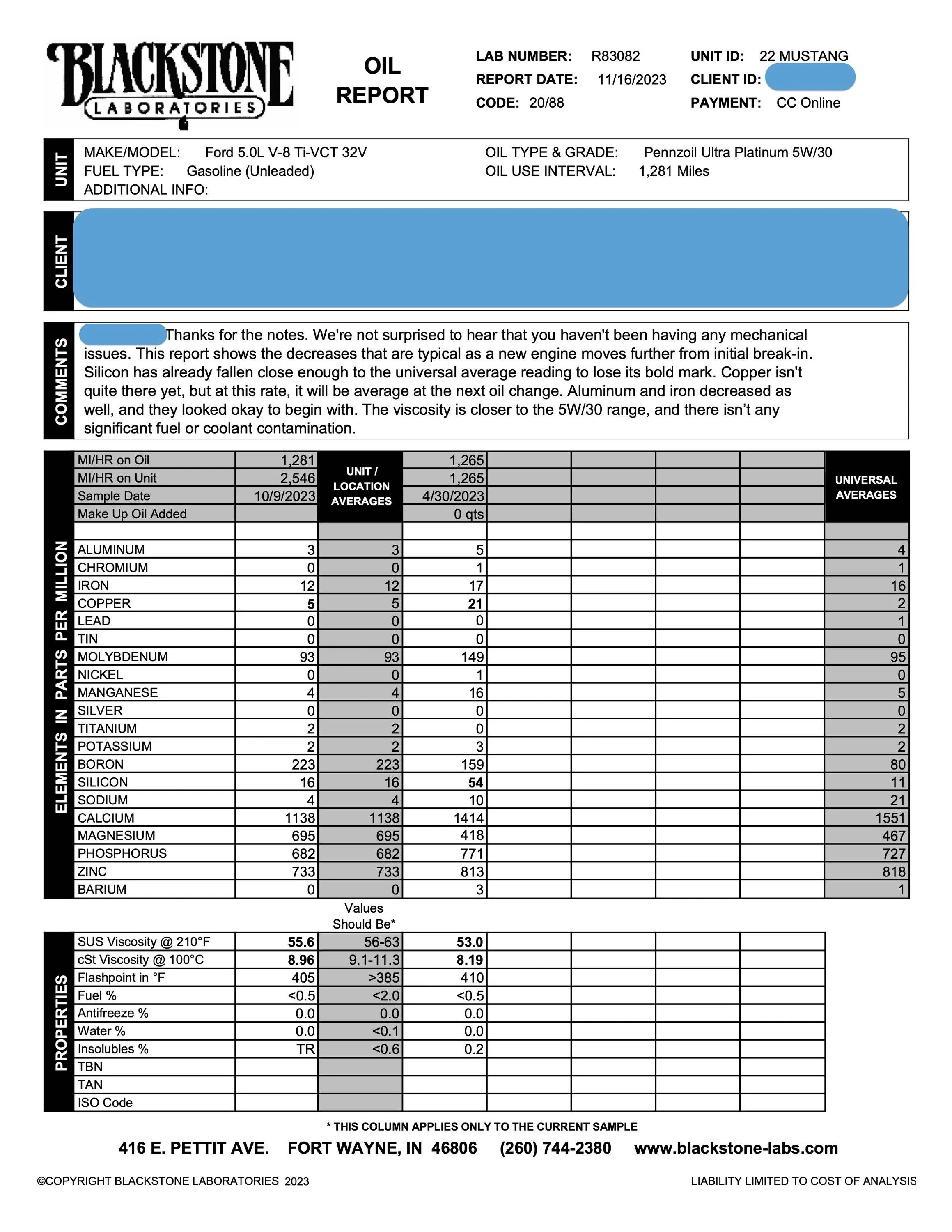

Stock 2022 Coyote. Low miles. Two oil changes so far. 5W-30. I do not use oil additives. I do not have the tick. Ford acknowledged the tick and advised nothing else is required. If I do develop the tick, I do not intend on using additives.
With respect to Ceratec, dealer interaction and warranties, maybe a sweet spot is waiting until the Powertrain Warranty expires while using a fully-synthetic oil which meets or exceeds factory specifications. While you do have a ways to go, pausing on using any additives will keep the matter from being an issue.
I've read several previous comments of Owners who take their own oil and filter to the dealer or someone they trust. If using a third party, the Ford Pass App will allow you to upload receipts, photos and your own record of the work accomplished.
Regarding the comments of Boron, attached is my oil analysis. Starting with the right-most column, the universal averages; this is what most people see in their Coyotes after 5,000 mi / 8,000 km. Moving to the left would have been first oil change and analysis of the factory fill. And the left most column would have been the most recent oil change, the first run with Pennzoil Ultra Platinum.
I did not decide to use PUP because of Boron and the tick. It's like using Shell for gas or Redline oil in gearboxes. It's a product virtually everyone has a positive comment about and many gravitate to.
Whatever brand you decide on, I do believe it's best to use the same oil product consistently. Yes, you can change over time, but I wouldn't be regularly changing to the flavor of the month.
I'm not a fan of changing the viscosity, changing to something other than specified in the manual. Engineers with a much better education have gifted me insight on what to use. I'd only consider changing oil viscosity if I'd modified the engine and the builder or Engineers of those parts specified a particular oil or weight.
YMMV.
