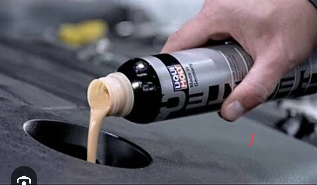

For those of you wondering how people can tell...
Your oil looks like a milkshake if you use the recommended amount.
Looking at that makes me nervous. That color is forbidden in oil 😨
