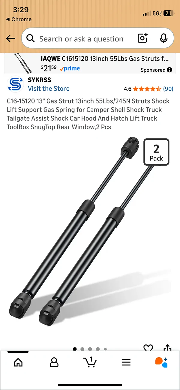

What's everybody using? I put a Steeda kit on my 20 when new and the gas cylinders have crapped out. I can't find enough info on them to locate replacement cylinders so I may have to buy another kit. The info printed on the cylinders doesn't get me anywhere on searches, I measure them at 13 inches extended and about 8 inches closed. Anyone have something similar that has the weight rating on them, I could probably find cylinders with that info. Thanks Jim

Very easy. You need 13” and 55lbs gas struts like those ones
Steed could have helped you a bit more
Open length and pressure rating is all you need to get lift struts
The ones in the picture are. $20 for the pair

Thank you, have you used that weight rating on a stock hood? I always felt the originals I put on were a little light, if the hood was up and you wiggle the car it would likely close. Jim
Yes, i use this rating on my 17
To replace the ford racing ones
Stiffer than the ford but all struts loose pressure after time.
It’s why it’s good to have cheap replacement

Thank You!
