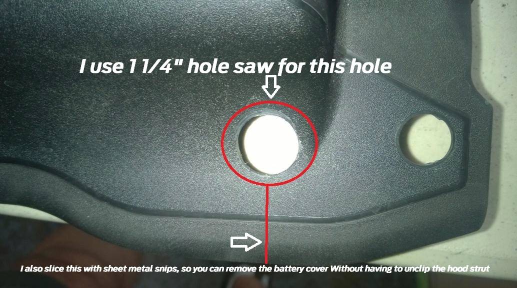

I've put several of these on regular S550 Mustangs, and the Ford Performance ones were a great Mod for my GT350.
I slightly change the Battery Cover procedure to this:

I've put the Ford Performance struts on both of my Mustangs and they've worked great. The washer line runs right adjacent to them and there's never been a problem. You do have to modify the battery cover, but with patience and a step bit it isn't even noticeable. I agree with the other posters that you'll also want to cut a slit to be able to remove the battery cover without removing the strut.

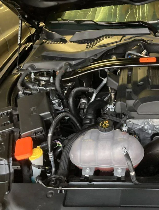

Mine are the Steeda variation. They work as desired/required. WRT the necessary hole for one end of one strut, I did that and the slit/split to allow battery cover removal. I'll point out that someone pointed out (after I split the damn' thing) you can just pivot the battery cover around the strut mount to accomplish almost any necessary battery-area work. I also added "Steeda" stickers to the prop bodies. Cute.
