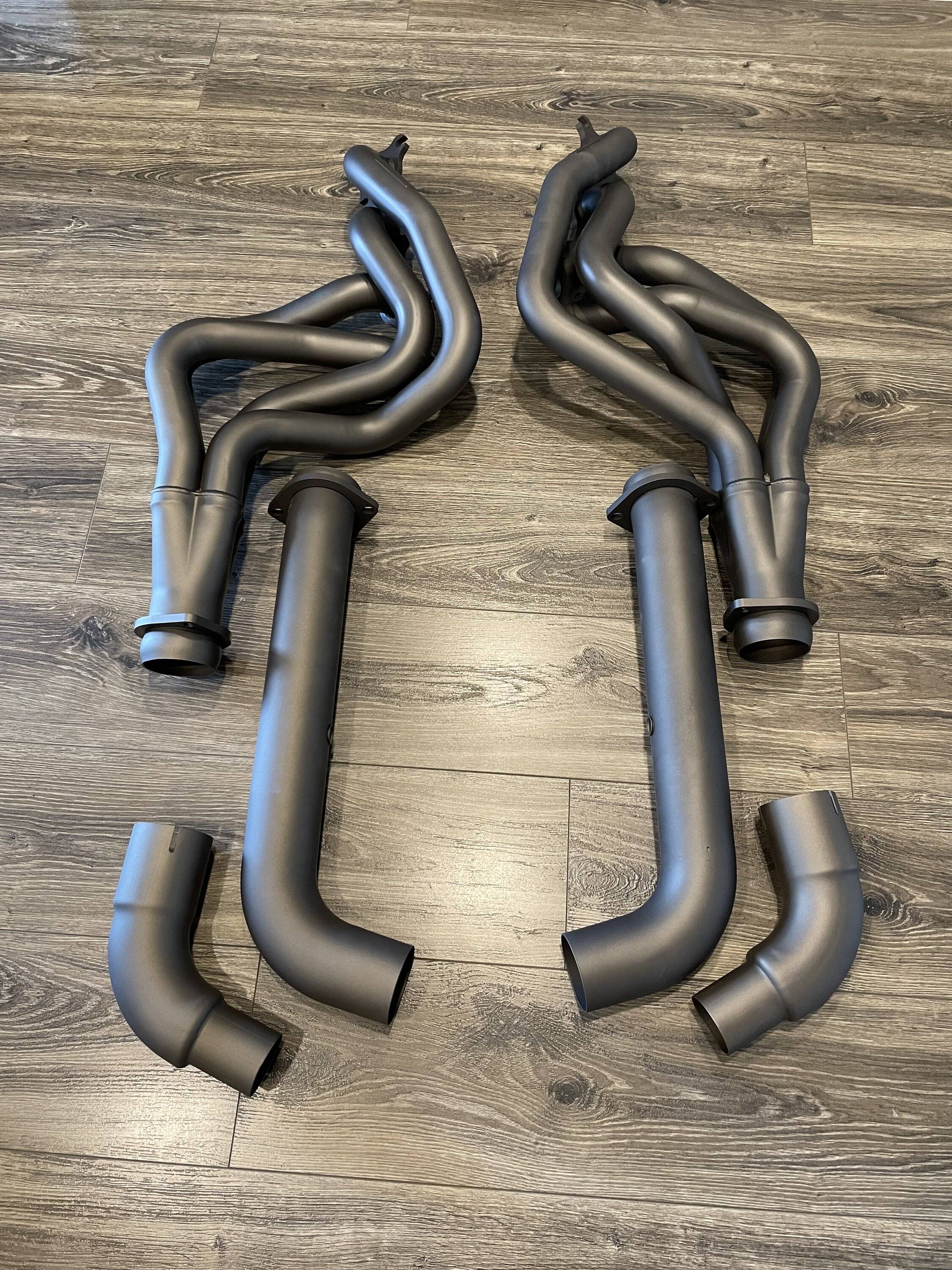

I have a 2018 GT and I am planning on getting long tube headers soon. I have been researching ceramic coatings and have come down to either Cermakrome which is a polished chrome look or Turbo x which comes in either black or blue. Turbo x seems to have the edge in reducing under hood temperatures but I like the visual of the chrome Cermkrome. My decision might end up being based on whether the headers are visible in the engine bay(I don't use an engine cover). Can anyone who has done the chrome headers let me know.
I have now done this on two cars, each time with Cerakote Glacier coating. The attached image is their Titanium color. It makes a DRAMATIC difference in underhood temps. Within a couple minutes of shutting the engine off, you can touch the headers with your bare hands.
https://www.cerakote.com/shop/cerakote-coating/C-7900/cerakote-glacier-titanium
