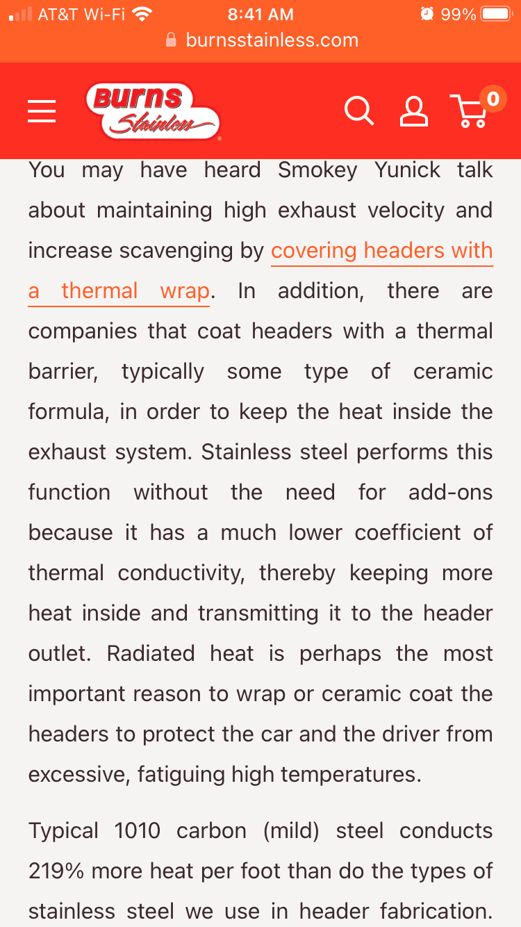

@DB83
Just throwing this out if you have 304 exhaust system. As mentioned in post #9 OEM 409 stainless exhaust systems dissipate twice the heat vs. 304.
Wrapping or Ceramic coating 304 /321 stainless exhaust tubing is unnecessary.

I do. I've got the kooks long tubes, which are 304 stainless. I've heard of people have corrosion issues even with 304 stainless with header wrap as it can trap moisture if not used frequently to keep it dry, so as an added preventative i will paint them.
You’d be better off having your headers “stainless steel cut wire blasted” if that’s available in your area.
The only corrosion issues with grade 304 SS would be from either mild steel surface cross contamination during manufacturing or exposure to heavy road salts and or calcium chloride de-icer’s
