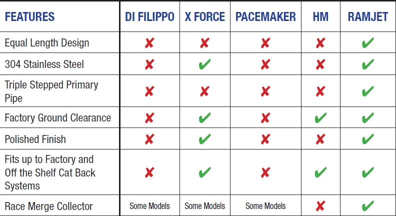

I'm curious why so many people are picking Pacemaker headers?
I know the table below is marketing but Ramjet seem to be the best buy on the market for RHD.

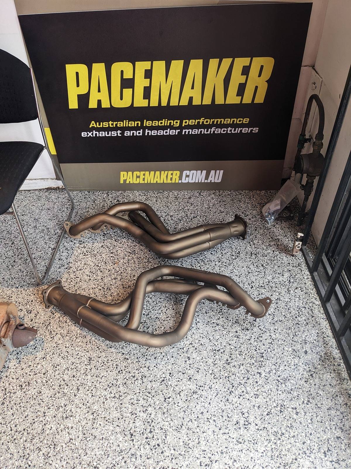

Well after a bit of talking around I would say yes, that the Ramjet's comparison chart is certainly a bit of one eyed marketing. I am not saying that they are not a great header but in the end I have pulled the trigger on Pacemaker. They are mild steel, tuned length, and importantly made in Australia not China.

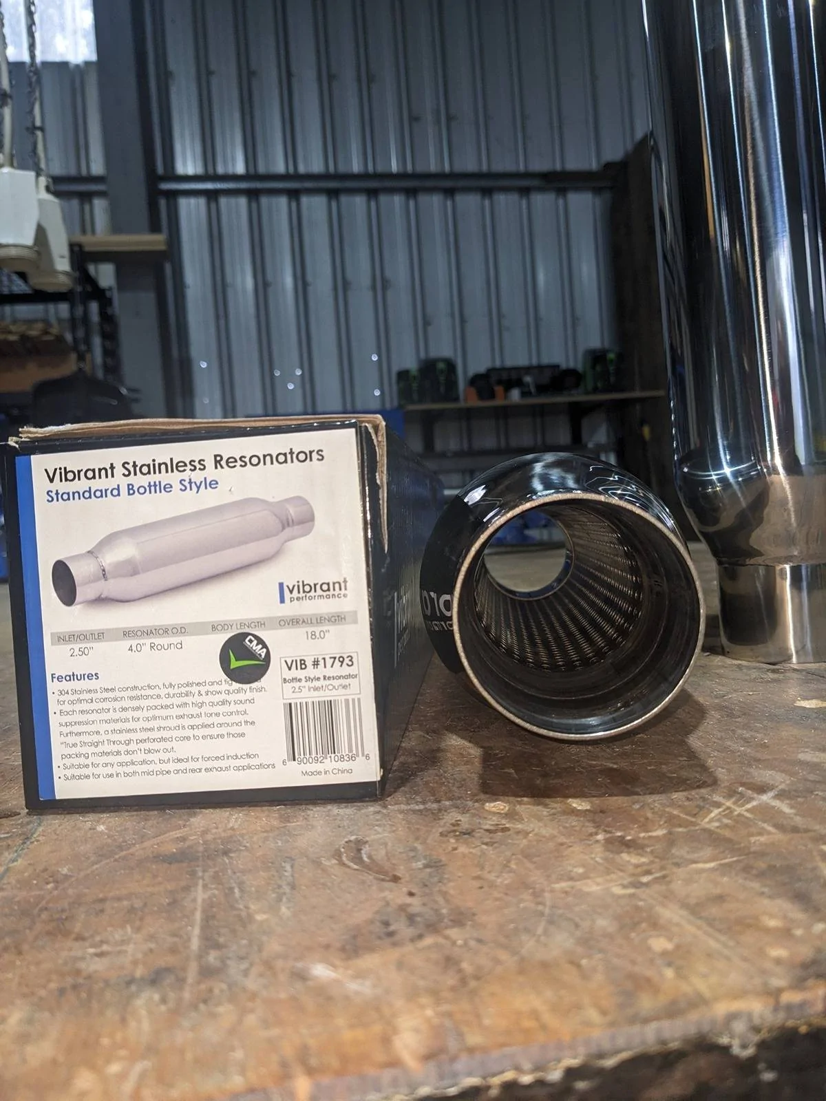

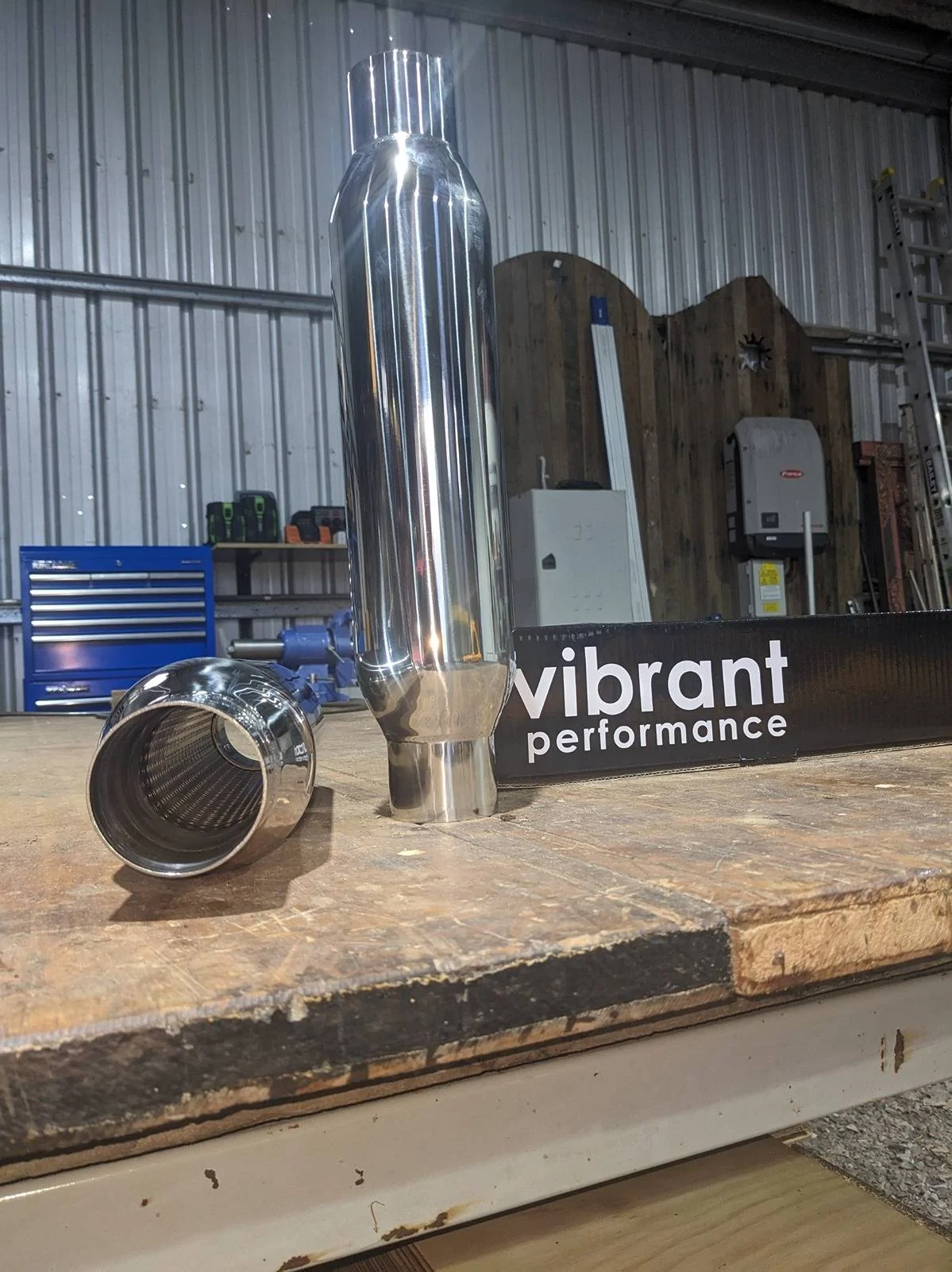

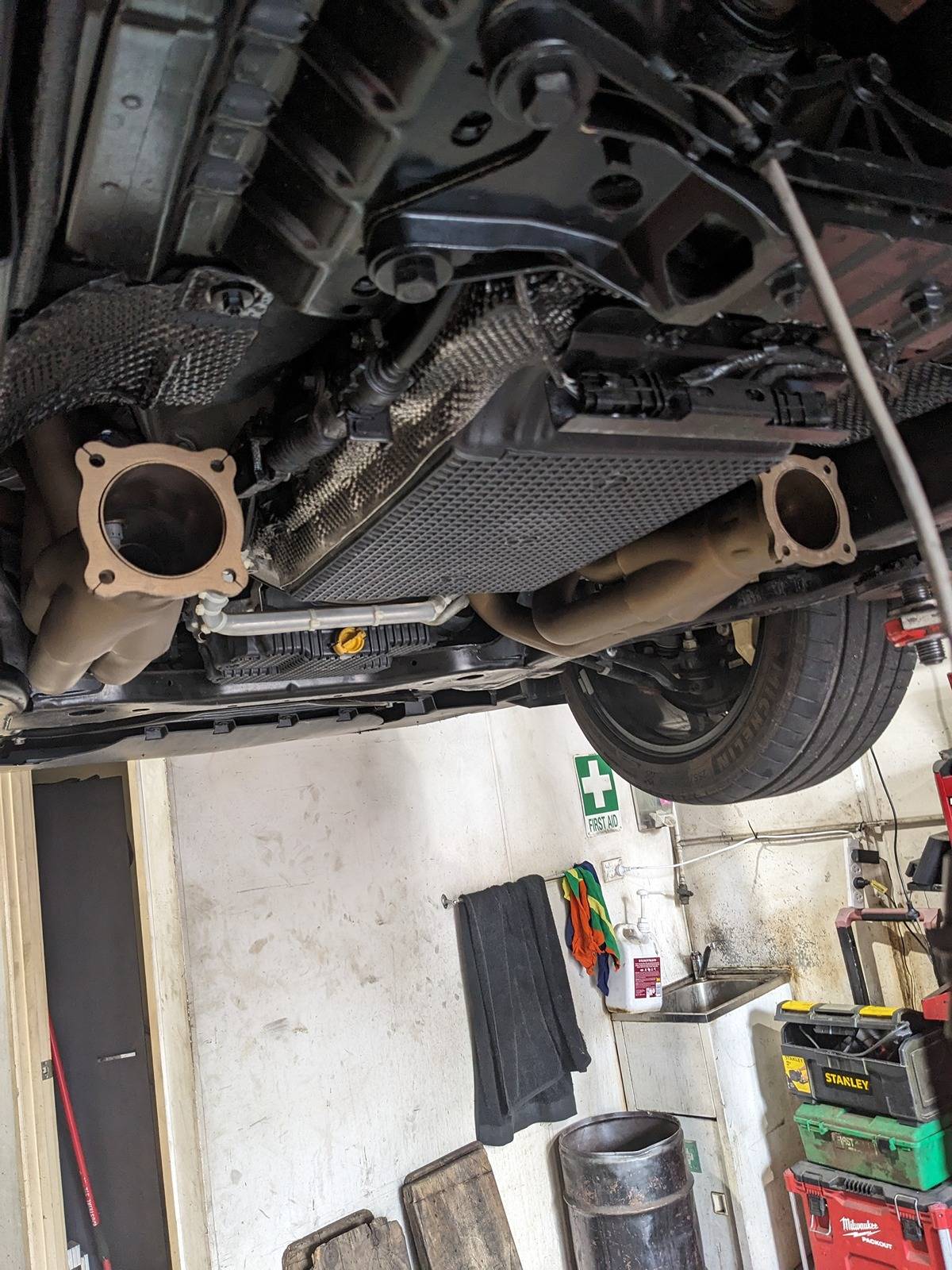

I have had my double coating done now for several months but I have not put many miles on the car since having the extractors fitted. The reason being is that 1/ the exhaust sound is not as nice as it was before when I had the OEM active exhaust complimented with the Borla Switchfire X pipe and 2/ after fitting the extractors I got a CEL and I am consequently getting a dyno tune. I had to postpone my first tune appointment when I decided to have a couple of Vibrant resonators fitted to take out the newly acquired shrill exhaust note. The tuner advised best to fit the resonators before doing the tune work.
After a long wait I now have the resonators and in two weeks they are due to be fitted. My tune is booked in for the following week.

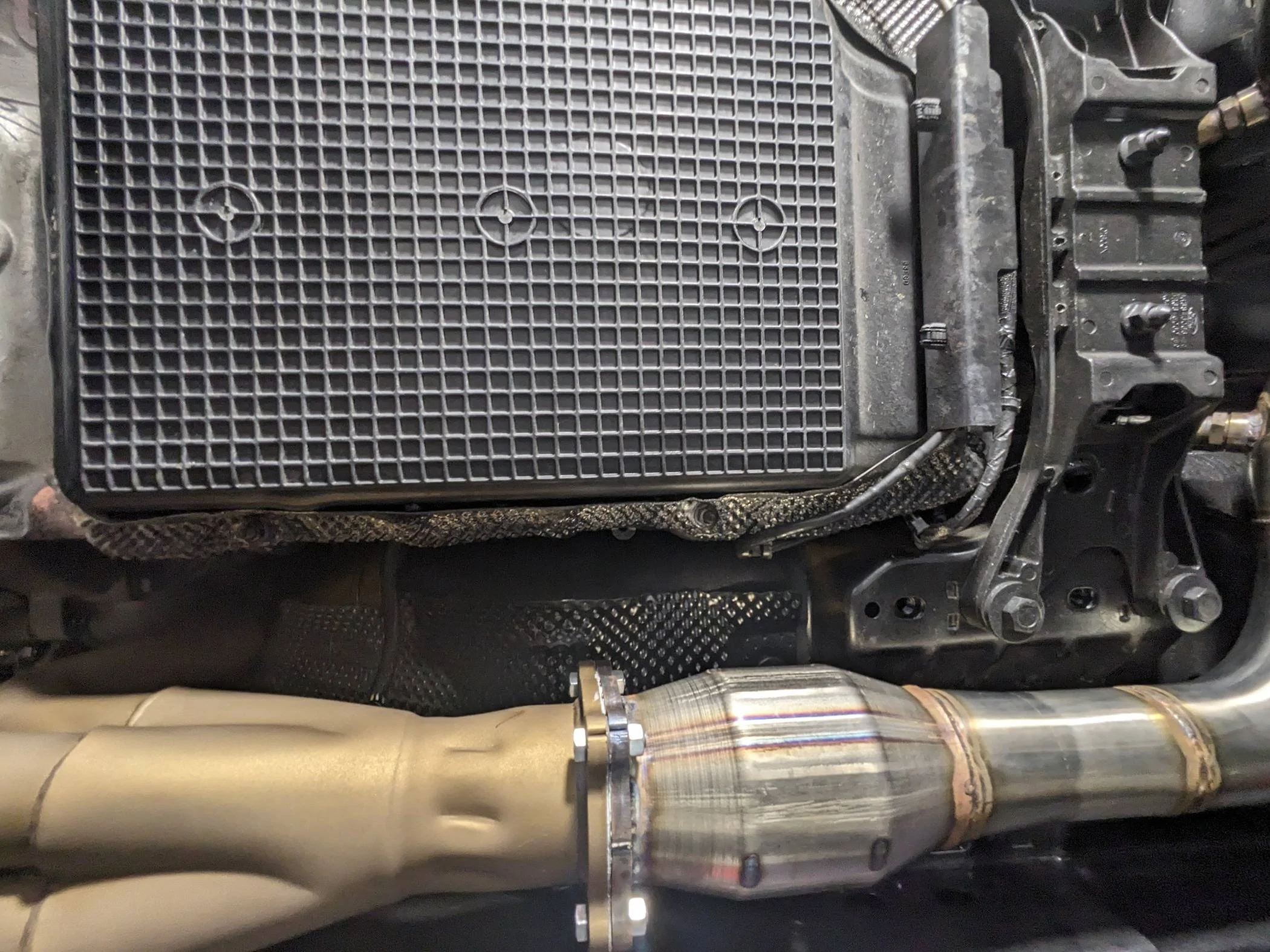

Do those headers used like some kind of gasket? Looks like they flanges on my dads old 71 Mach 1.
PKs
PKs
PK's
Aug 20, 2016
1,347
1,595
Gold Coast, Australia
Peter
2018 GT Fastback
I guess it is a preformed gasket, I did not enquire at the time.

I would have gone with the REX headers. Equal length is tuned length and the photos you posted above are no where near equal length.
Mild steel will rust out, even coated. Do not wrap them or they might only last a year.
I did consider the Rex but it seems there are pros and cons for both stainless and mild steel. I ended up choosing the Pacemakers as they are a trusted Australian manufacturer and not a non disclosed mob. The Pacemakers are "tuned design". Time will tell if I made the correct choice.
I know me and a few others have been pestering REX to build a set of equal length headers for the LH drive model. It makes a difference.
