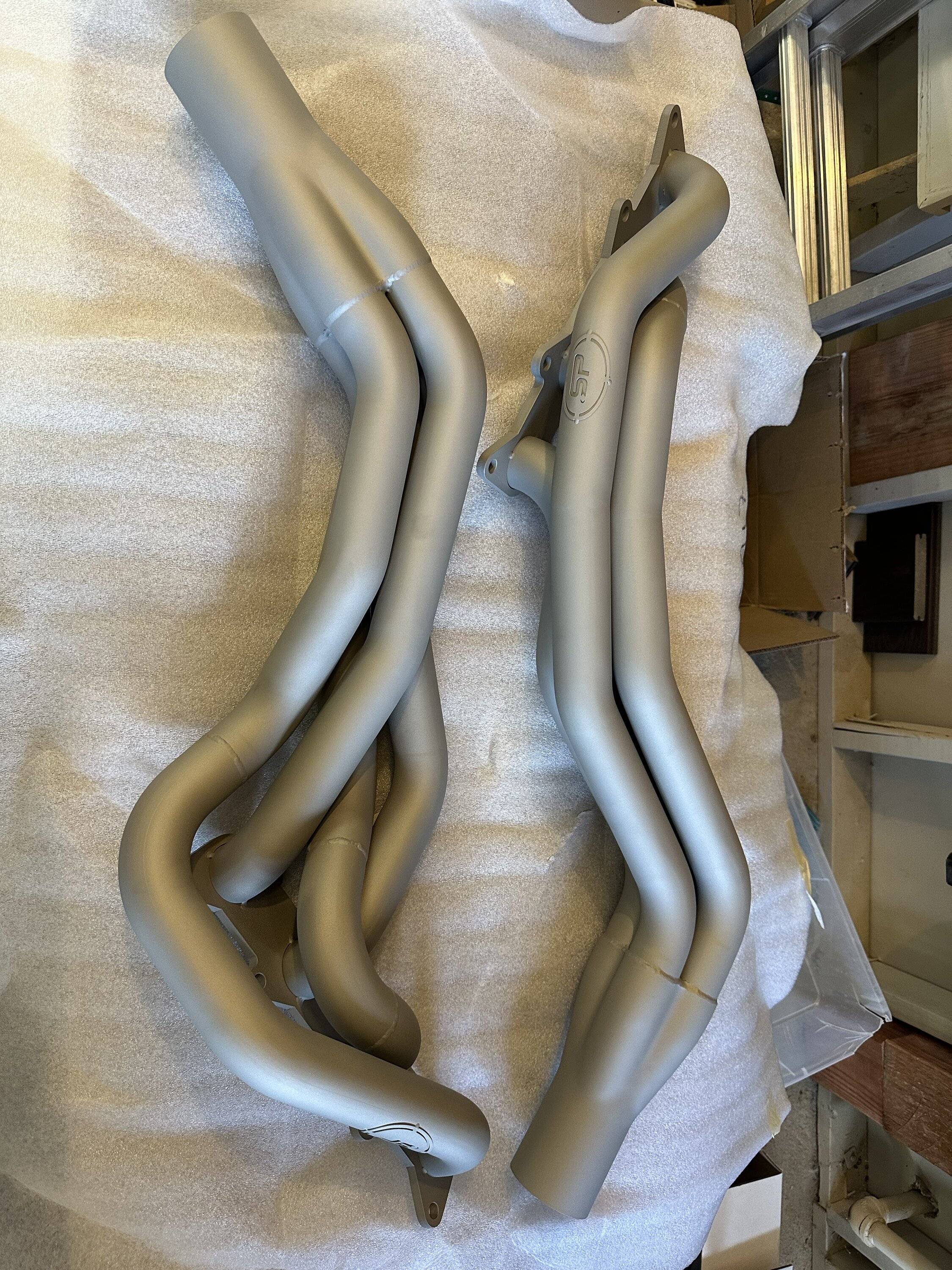

I have now done this on two cars, each time with Cerakote Glacier coating. The attached image is their Titanium color. It makes a DRAMATIC difference in underhood temps. Within a couple minutes of shutting the engine off, you can touch the headers with your bare hands.

Nice. How visible under the hood are they, bearing in mind that I don't do the engine cover.

The engine cover doesn't obscure the view to the headers. You can see them, especially on the drivers side if you peer down in there
