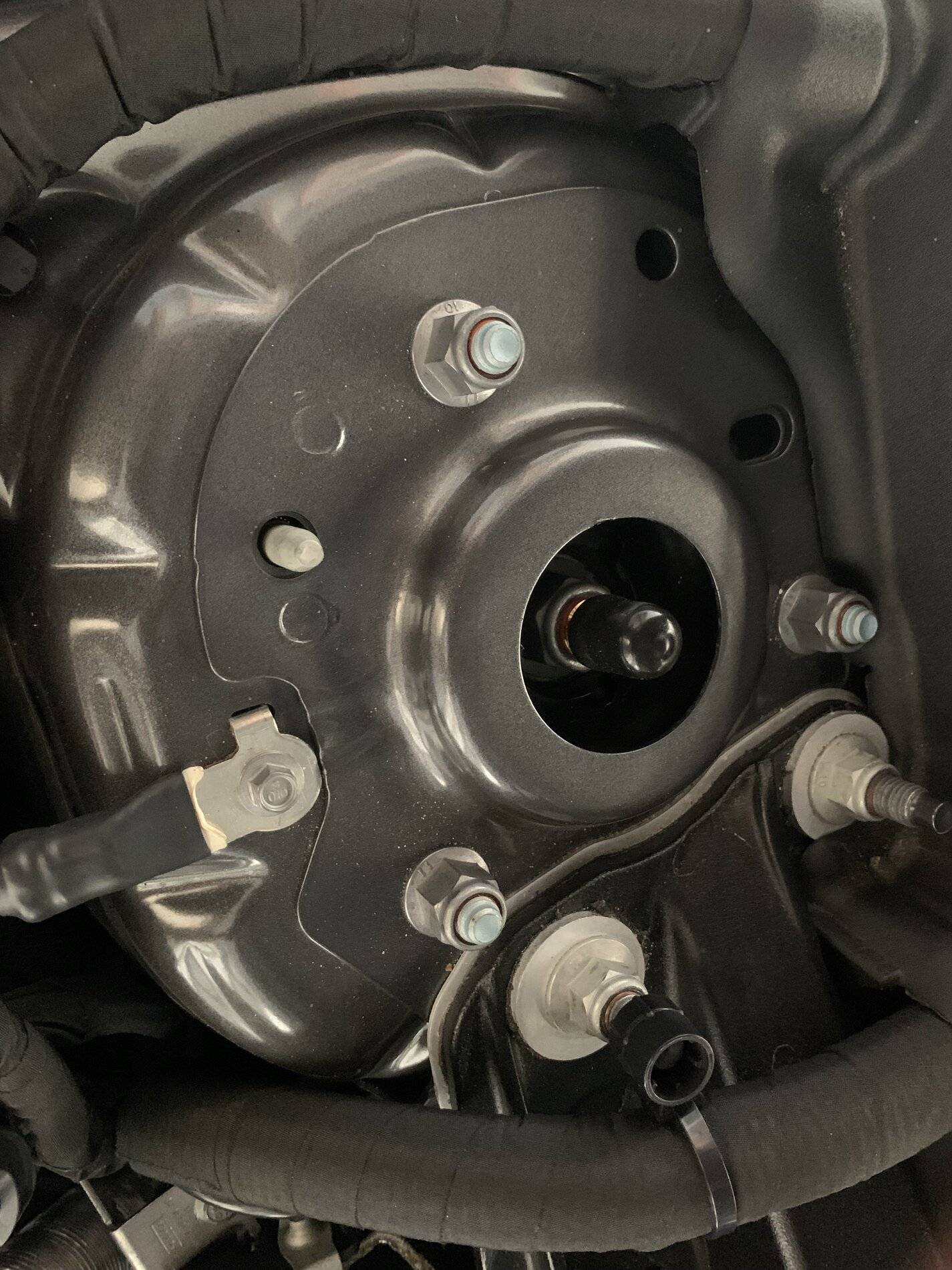

Adjustable?
Yes. The pin indicates the adjustable plates. You'll have to do some disassembly to remove the factory installed set screws first though.

I believe they started showing up on Job2 cars (that were optioned with adjustable camber plates).
From a functional perspective, they are best suited to the "set it and forget it" crowd. They aren't as user friendly as say, plates from Vorshlag. If you track or are likely to make a few adjustments over time with your car I would absolutely consider Vorshlag over the factory adjustable camber plates.
