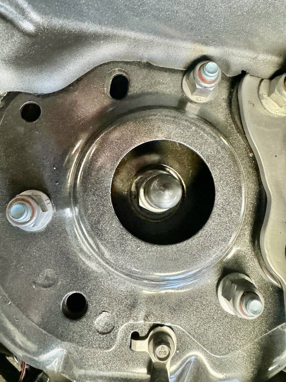

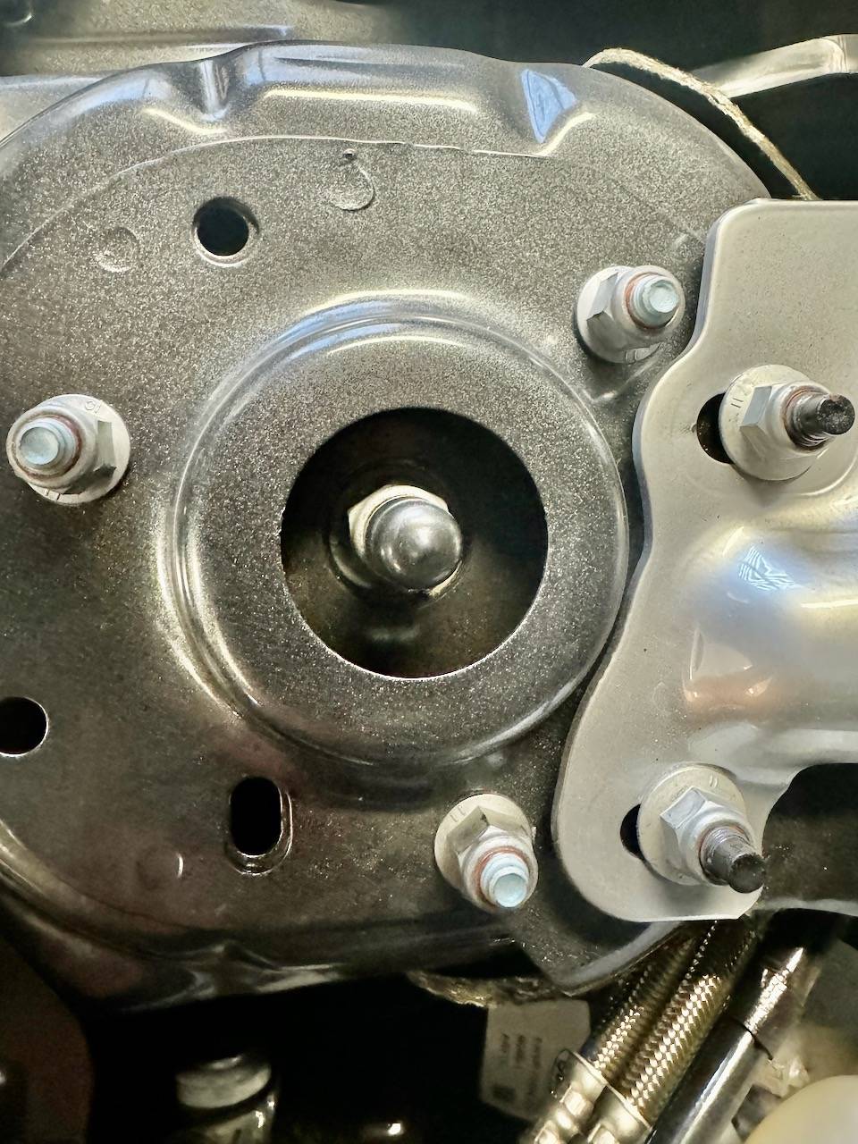

@jmn444 I've been back and forth with my selling dealer about this recently. I live in NC, bought the car new out of state from a dealer in Iowa. Took it to Mooresville, NC Ford before going to VIR, they said "we can't do the performance alignment, because you don't have the plates installed." Selling dealer isn't being very responsive. Do I have these plates or not? Photos below.
That is identical to mine. That is NOT HP setup.

are you saying those two pics are showing the same part?? because they are def not....
You have no pins protruding through the empty holes.
What does your window sticker show, HP option or no HP option?

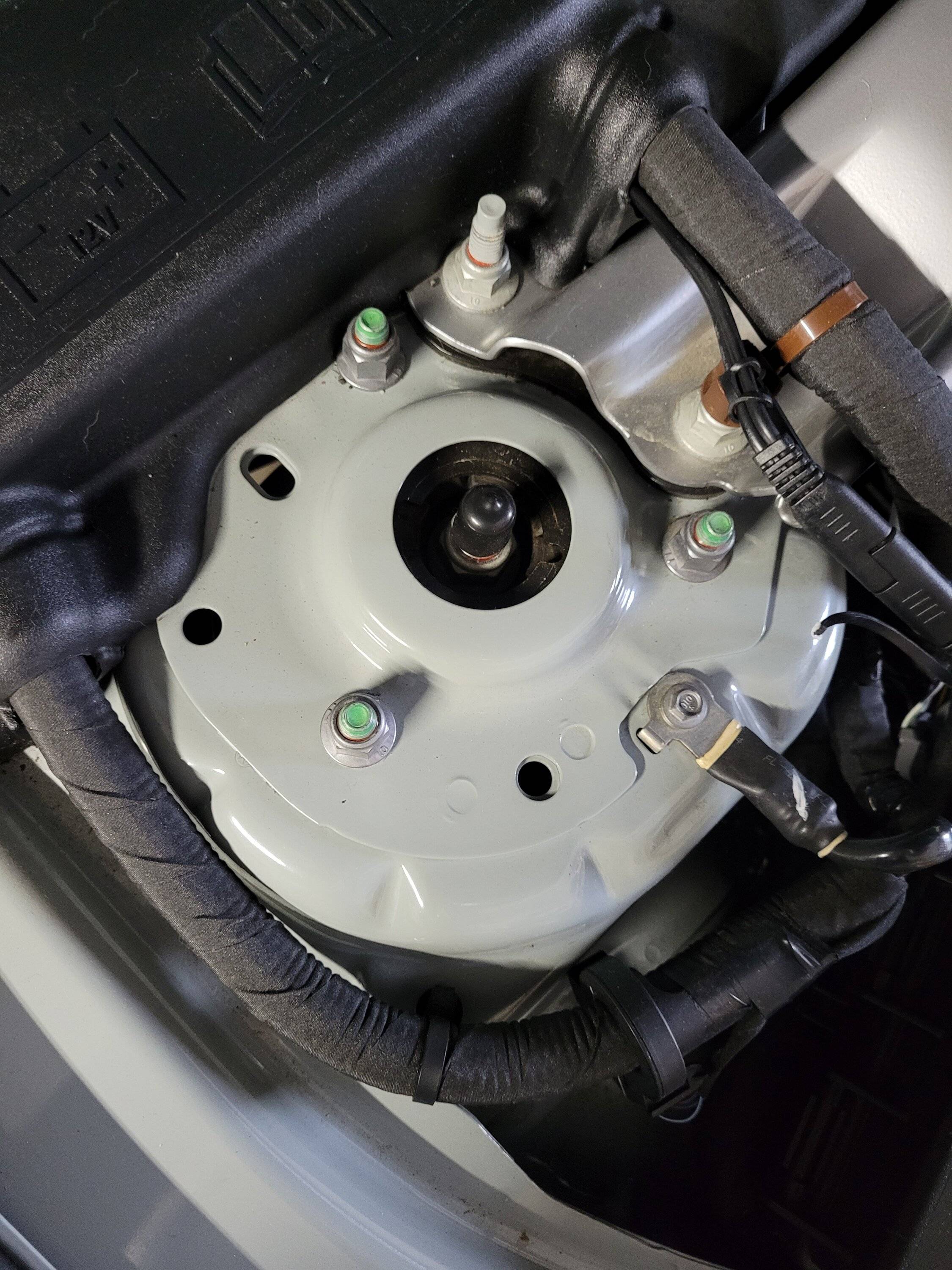

pins thru the empty holes???
that other pic isn't my car, but if you look at what's in the opening where the top of the strut goes thru, then you will notice that your strut mount is significantly different than the one that the other guy posted. watch the video link i sent. yours and his are 100% NOT the same.

Mine says HP, and I have the correct plates. Watch the video, then come back and tell me how yours and his are the same please.

hint: his match mine, but do not match yours.
