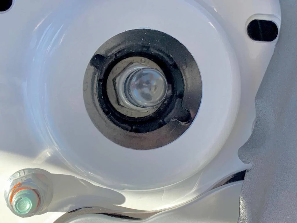

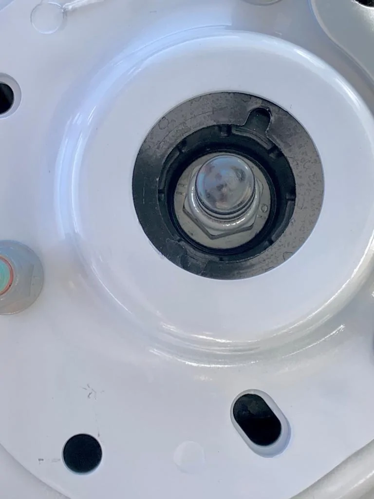

I am going to assume these are NOT the adjustable struts on my R? Tramlines and pulls all over the road like a team of wild horses btw.
09cs
Oct 22, 2019
959
684
CA
2019 GT350
Not the adjustable ones. My non R tram lines with the Cup 2’s as well
09cs
Oct 22, 2019
959
684
CA
2019 GT350
thanks bro...calling the dealer in the morning then.
Good luck, been arguing with my dealer for 2.5 months looking for my adjustable plates that are supposed to come with the handling package
