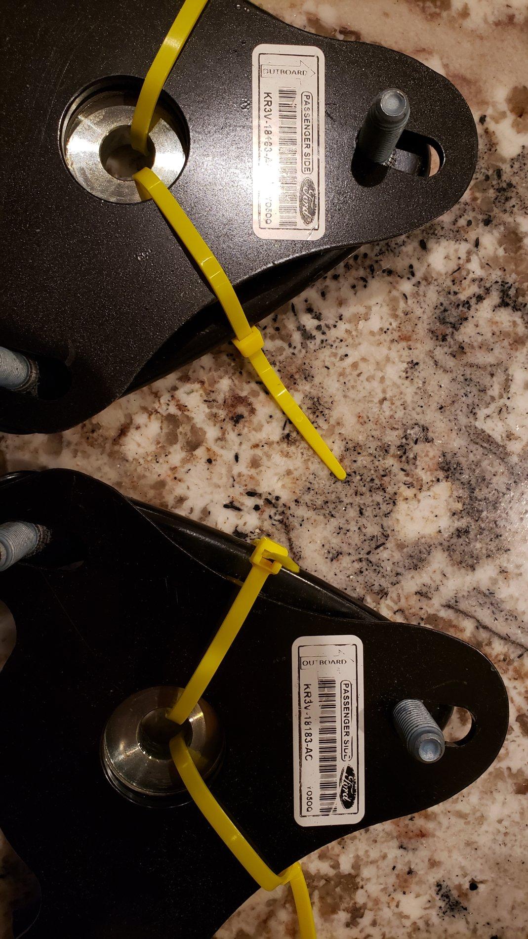

Well, my dealer ended up sending me two passenger side plates.
Gotta send one back and wait for the other.

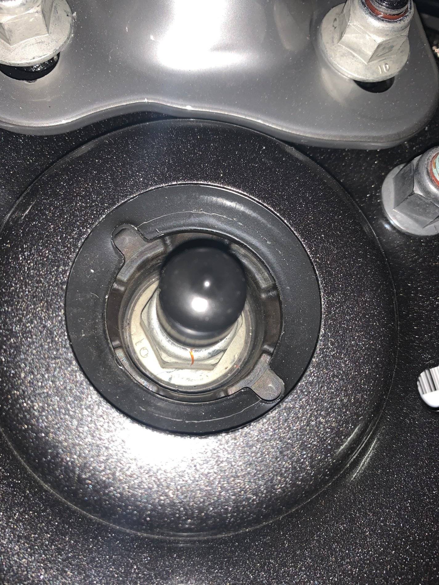

Can one of you experts please advise if my plates are installed on my new 2019 I picked up this weekend? Thank you!
09cs
Oct 22, 2019
959
684
CA
2019 GT350
nope. those are normal ones, not adjustables

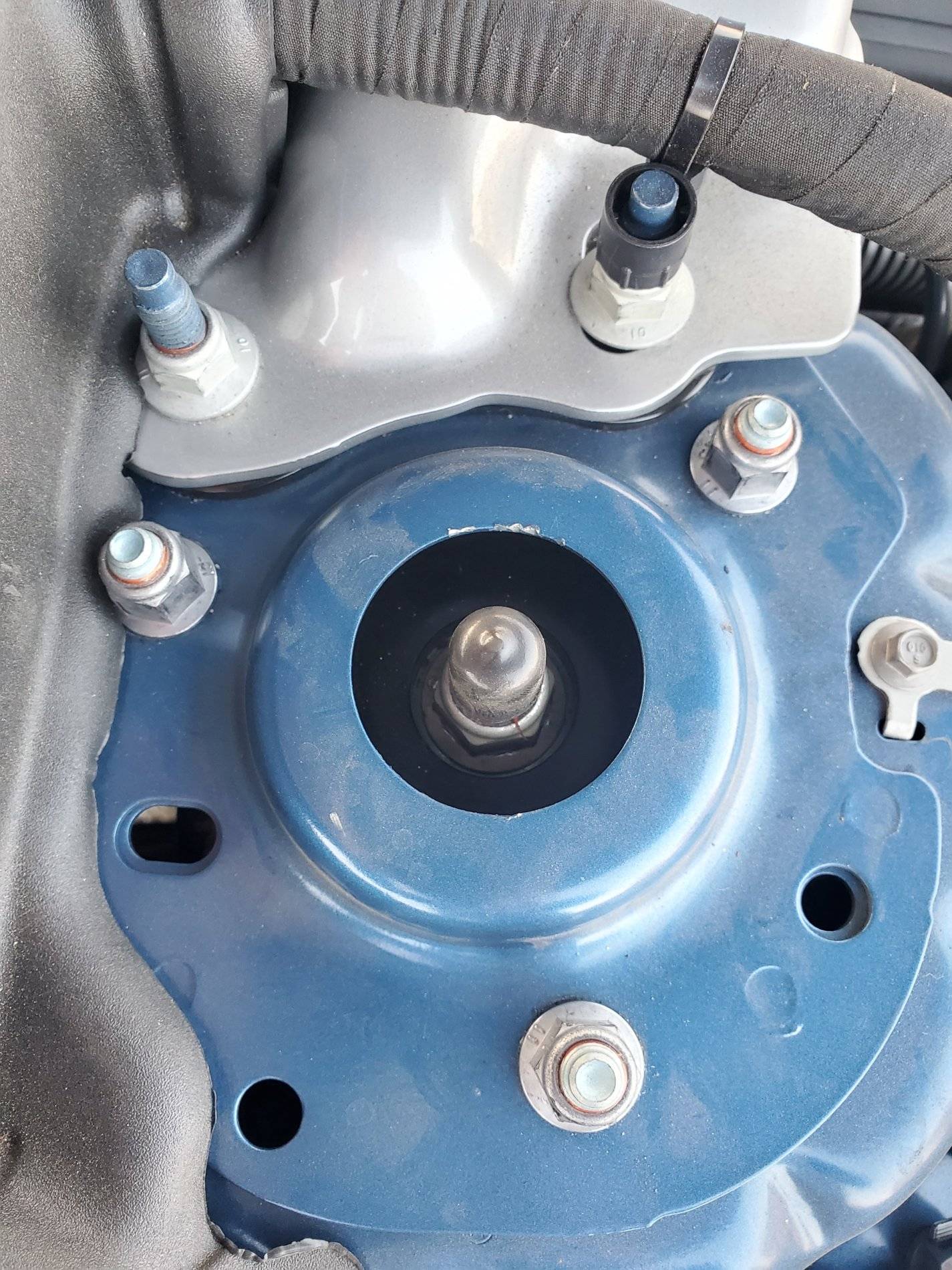

I just got mine installed this week. Stupid question incoming.. do you just jack the car up loosen the top 3 nuts, slide it over, and then slide it back at end? Any idea on the torque?
I've yet to see clear instructions on how to adjust them!
Also, will they (should they) already be at full street side, or do they use this adjustment as part of the aligning process so it may be somewhere in the middle already?
Thanks! Lot of questions.. but I'm at the track this weekend now is the time to know :) !

No you do not just loosen the top and slide the plates in. You have to pull out the struts and install the plates from the bottom. Adjusting the plates is part of the alignment process. They are adjusted for more negative camber for track use and less negative camber for street use and must be adjusted on an alignment machine.

The plates are already installed I just mean for track day adjustments.
I'm assuming since they can align cars without adjustable plates, that the adjustment on top is not part of the process. The instructions indicate that they are installed (and then aligned) while in the "street" position, which then would allow you to slide to max camber temporarily.
But, that's just an assumption :) trying to verify.

You will need to jack up the car so that BOTH front wheels are off the ground before you can loosen the three top nuts and slide the strut tops in or out. I tried jacking up just the side I was working on the first time I wanted to adjust the camber on my car, and I couldn't for the life of me figure out why the strut top wasn't moving... :facepalm: Torque value for the nuts is ~30 ft.-lbs., I believe.
You WILL need an alignment after you adjust the camber, as your toe-in will change (possibly dramatically) when you increase the negative camber from stock (I had significant toe-out after going to roughly -2.2 degrees camber in front).

Haha ok great thanks, I definitely would've tried only one side. I was planning to go max camber just for 2 days then back to street. I realize that the toe will be affected, but I'm going to try it. Afterwards, I'll put it back to the street side. Would I still need to realign? It should be back to the same, but I imagine it could change enough to warrant a realign.

Proper toe will affect your steering feel quite a bit. Honestly, I wouldn't want to drive on track with a lot of toe-out... Even just driving on the street, the steering felt really loose until I got the toe set back to near-zero. The good news is that it's relatively easy to get the car back to near-zero toe with just a measuring tape and a couple wrenches on the tie rod end and nut.
