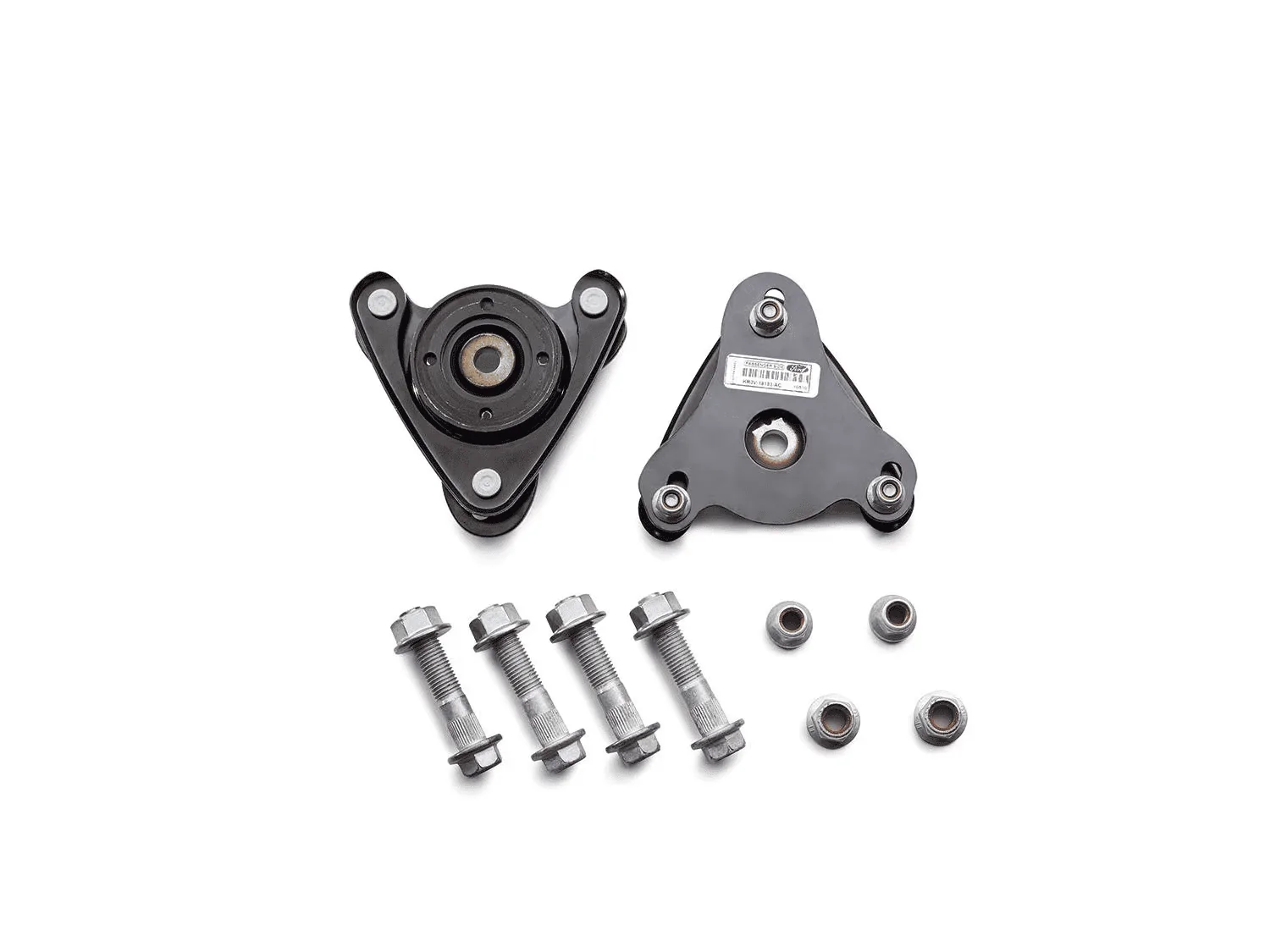

@jmn444 I've been back and forth with my selling dealer about this recently. I live in NC, bought the car new out of state from a dealer in Iowa. Took it to Mooresville, NC Ford before going to VIR, they said "we can't do the performance alignment, because you don't have the plates installed." Selling dealer isn't being very responsive. Do I have these plates or not? Photos below.

those look like the adjustable ones to me. jack it up, loosen the 3 nuts (do not remove them though) and see if the strut moves inboard/outboard. it takes some effort to move it even with the wheel off the ground, maybe mark where it is currently 1st unless you live very close to where you will get it aligned. those nuts probably have a torque spec too so you will want them torqued to spec before driving it again as well.
Thanks. Should there be a part #/sticker visible somewhere as well? At this point, I'm leaning towards the fact that selling DID INSTALL them and Mooresville Ford didn't know what they were talking about.

i don't think the part number sticker is always visible, but not certain on that. here's a pic of the part off the car, so that you can understand how it allows the strut to slide when the nuts are loose...
