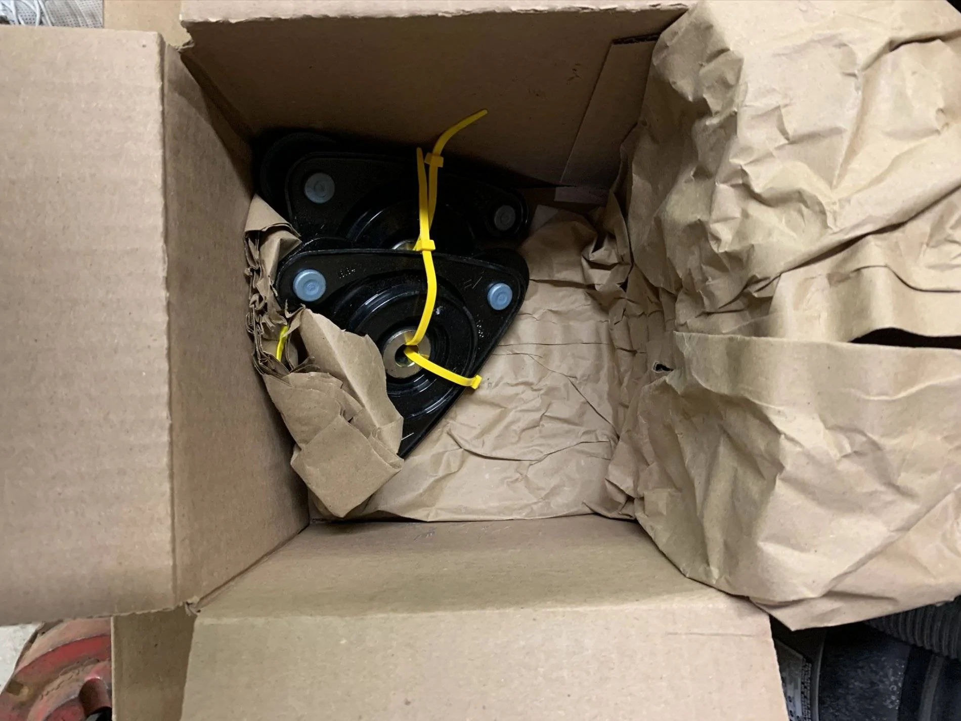

I have the handling package with my 2019. The plates were still in the box in the trunk. I didn't even think about it being a dealer installed item and that Ford pays them to install the stuff. Problem is the dealer is over two hours away and there is no way I would run it back down there for them to install them. I am going to reach out to the dealer though and see if they will basically pay the local Ford dealer to install them.
Needless to say I have them in a box if you need to know any information.

Hi George,

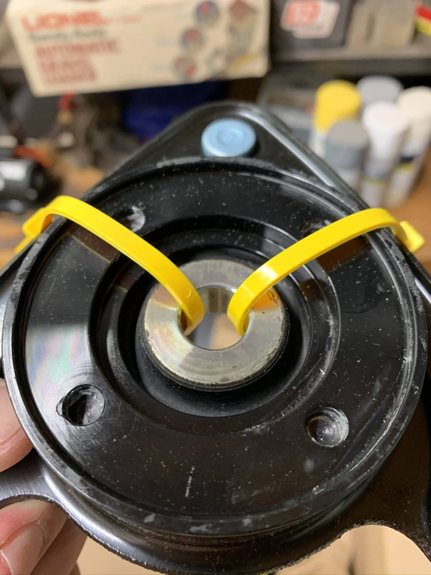

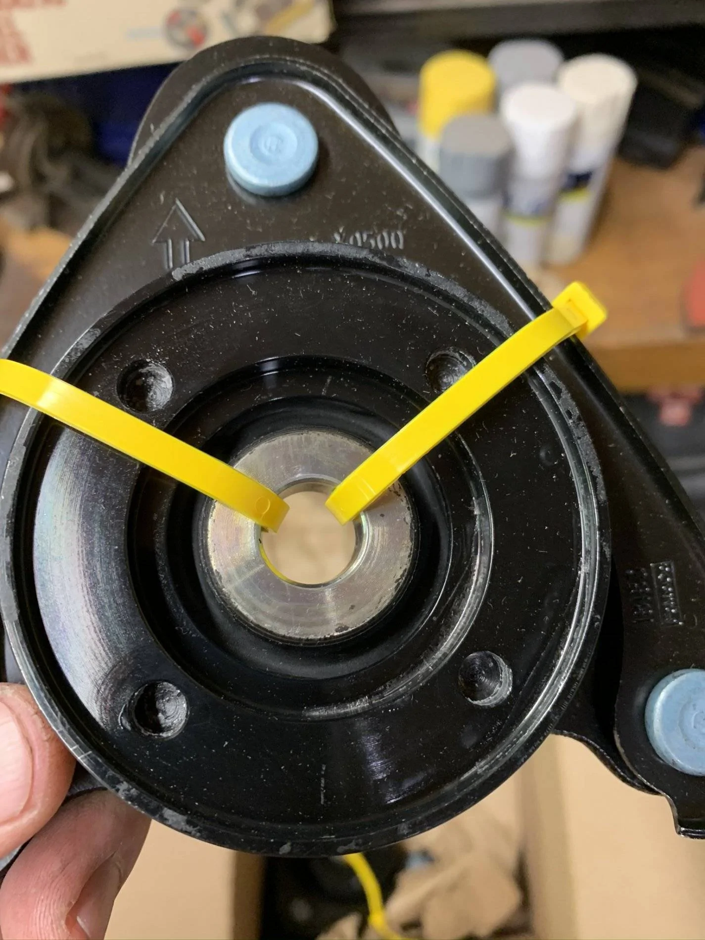

Have you opened the box with the plates? Here's the thing I would have liked to have looked at - what material holds the strut rod bearing or bushing in place? Is metal or hopefully a more compliant & stock like dense rubber puck that would cushion while holding and centering the bushing? Since the strut rod gets nutted to that then its the last way vibration could possibly couple to the topmost plate and then the shock towers etc. If I saw rubber there similar to what is in the stock upper strut mounts have then I'd think any NVH is due to some sort of installation error.

I will take some up close pics and see if I can't scan the directions when I get home tonight. I did send a message to my salesperson at the dealership and she said I can take it anywhere I want and they shouldn't charge me and if they do send the receipt to them and they will take care of it.

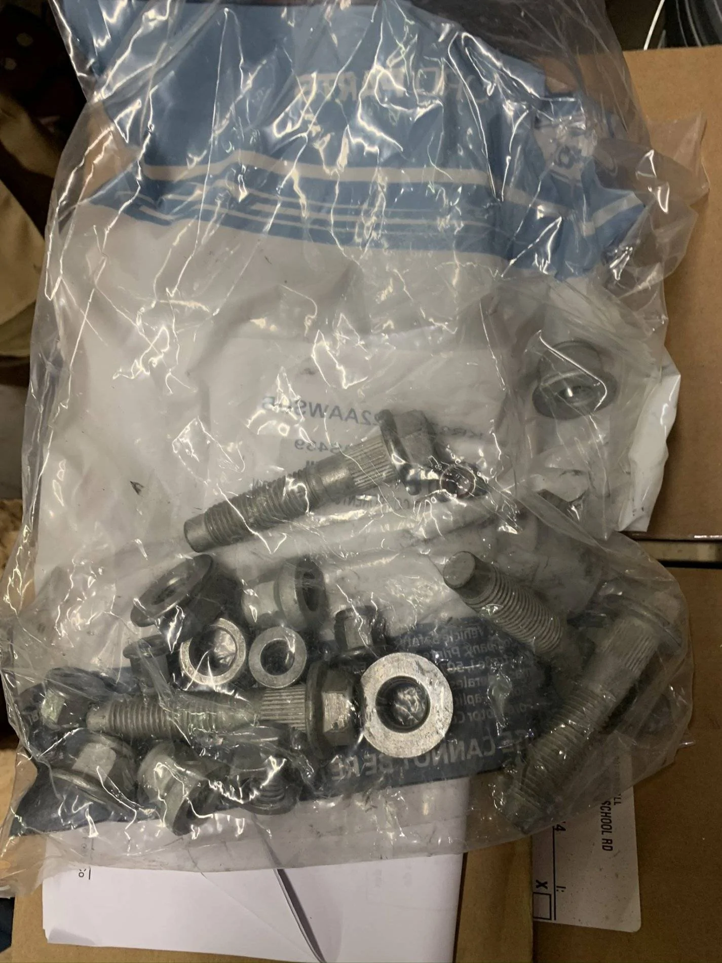

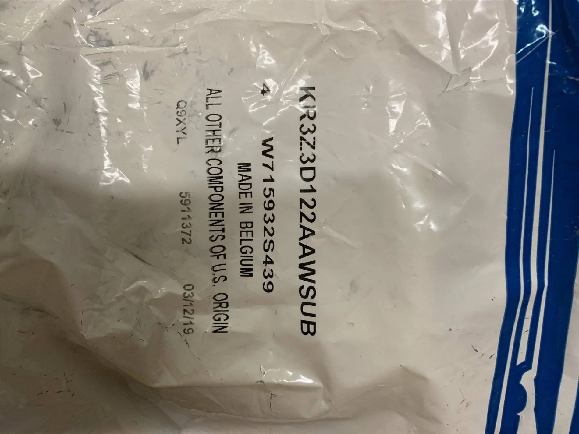

Here are the pics I took of my camber plates a while back since they were still NIB in the trunk when I got the car.

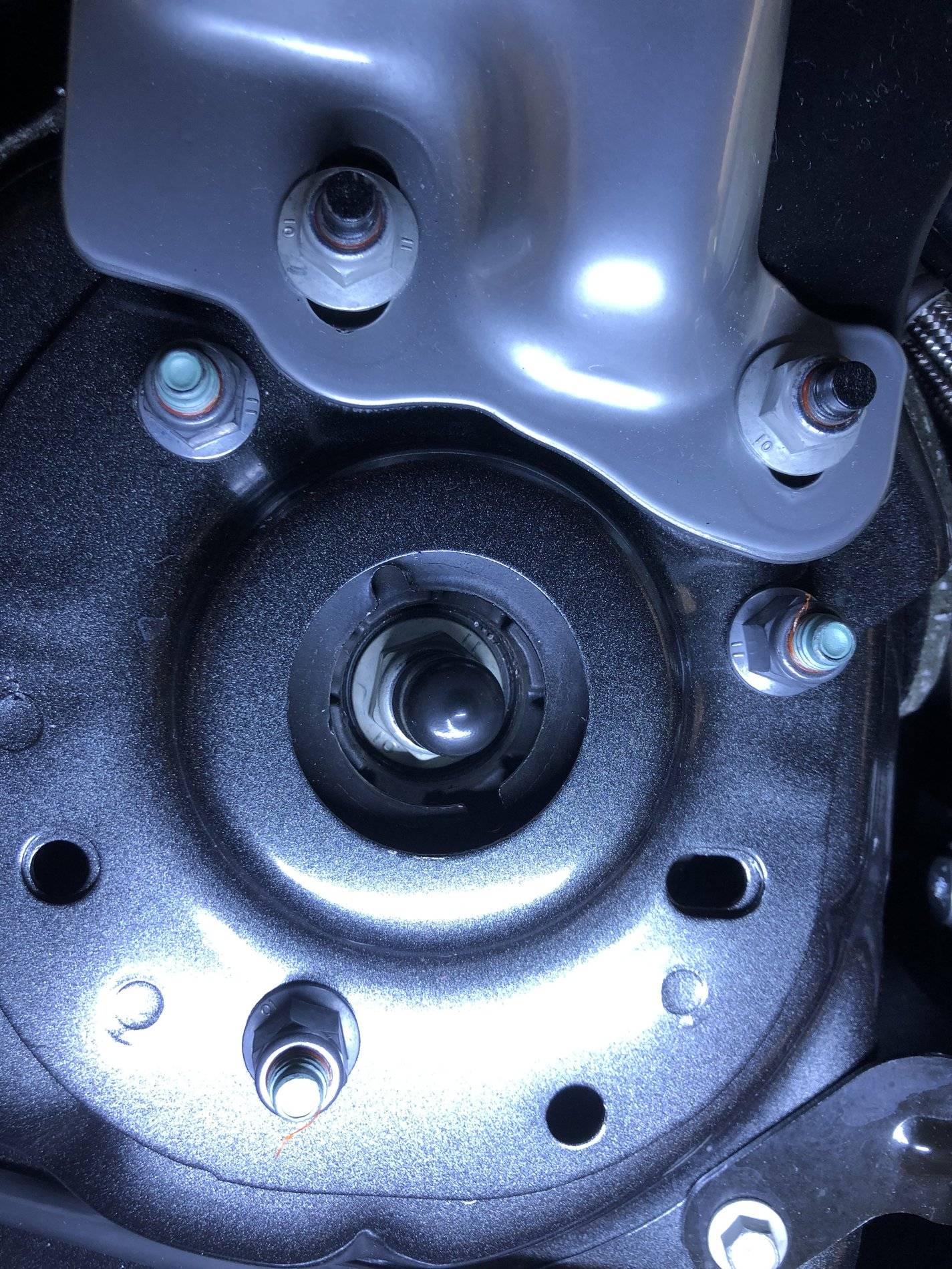

When you look through your strut tower, if you see notches, they are not installed.

I just purchased a 2019 R at the end of last month which I discovered did not have shipping blocks removed and front spoiler not correctly installed. I now suspect that the adjustable strut mounts were also not installed. Could someone verify if they were installed from the attached picture. My local dealer tech told my service manager they were, I don't see it.
