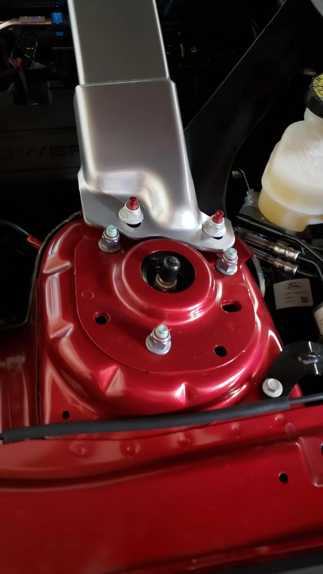

they are visibly different from the top opening, the non adjustables look like this (notice the multiple levels and notches across from each other):
nc_oc=AQk09XVXLQiwngwbw-XV4Tpk9-hqNsO0yvFXFgx1NwAEpmMHK4nWzkfOdzkiwz03X5E&_nc_ht=scontent-ort2-1.jpg

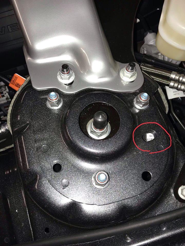

And the adjustable ones look like this (ignore the circled part, but note the flat surface w/ no notches):
nc_oc=AQn7d8uCYzXe5Xc2EQ1CHzrSxnnjSLqAOp9SId6NzfdDsCoKuznmPw1mOPiKZ23smfM&_nc_ht=scontent-ort2-1.jpg

Great pictures!!!!!!!!!!! I found my instruction sheet for my camber plates in the trunk but was still unsure if they had been installed. Now I know for sure, Thanks

The pics i posted are definitive. Simple to tell just from looking in that opening.
