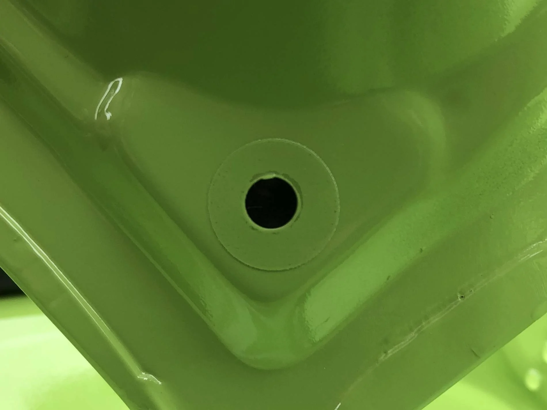

More cheap tat from eBay, the brackets were painted in super troll prior to putting them on :
Plenty cavity wax in these doors ...

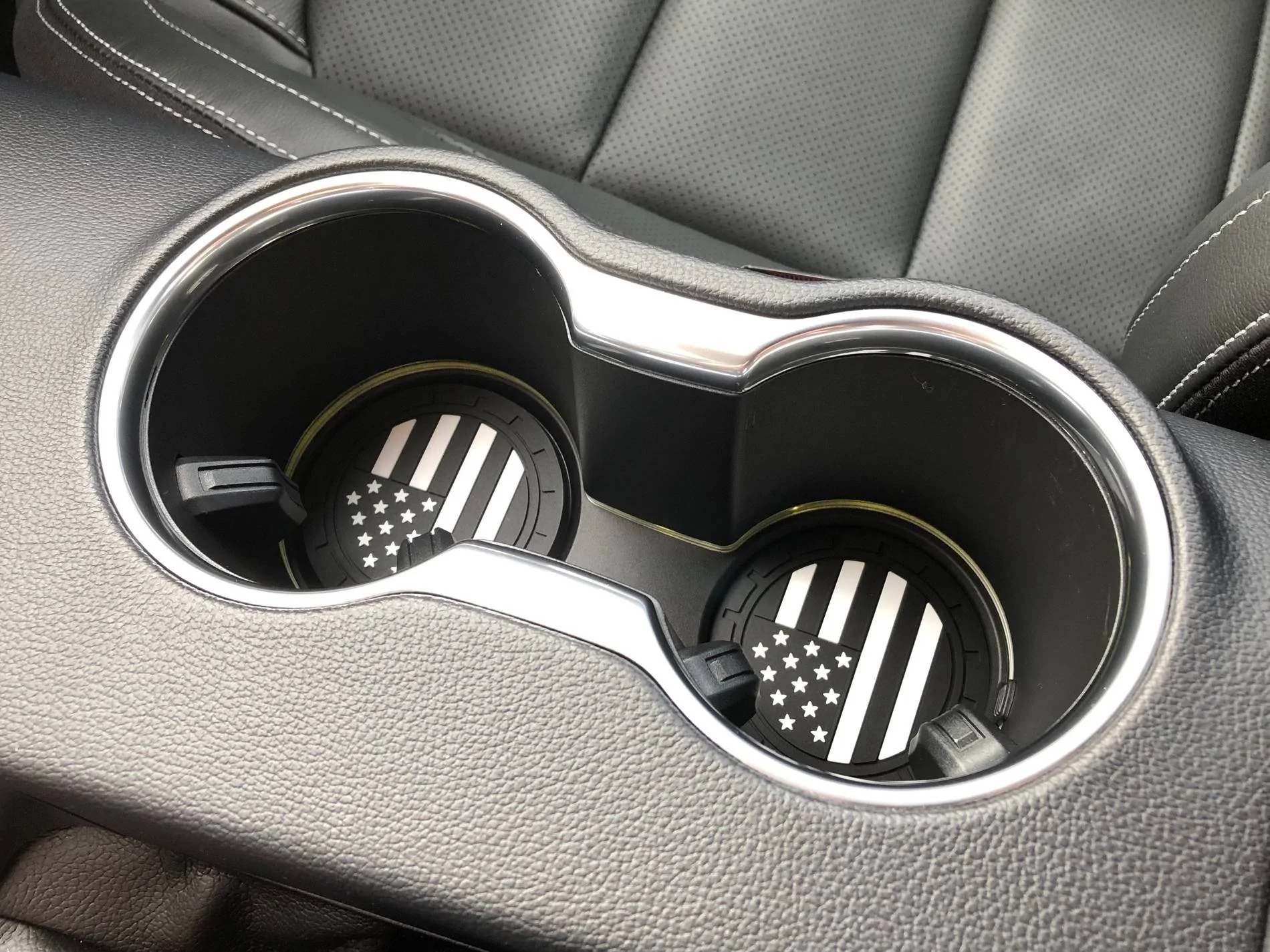

I did add a bit of patriotism so it doesn’t miss home :

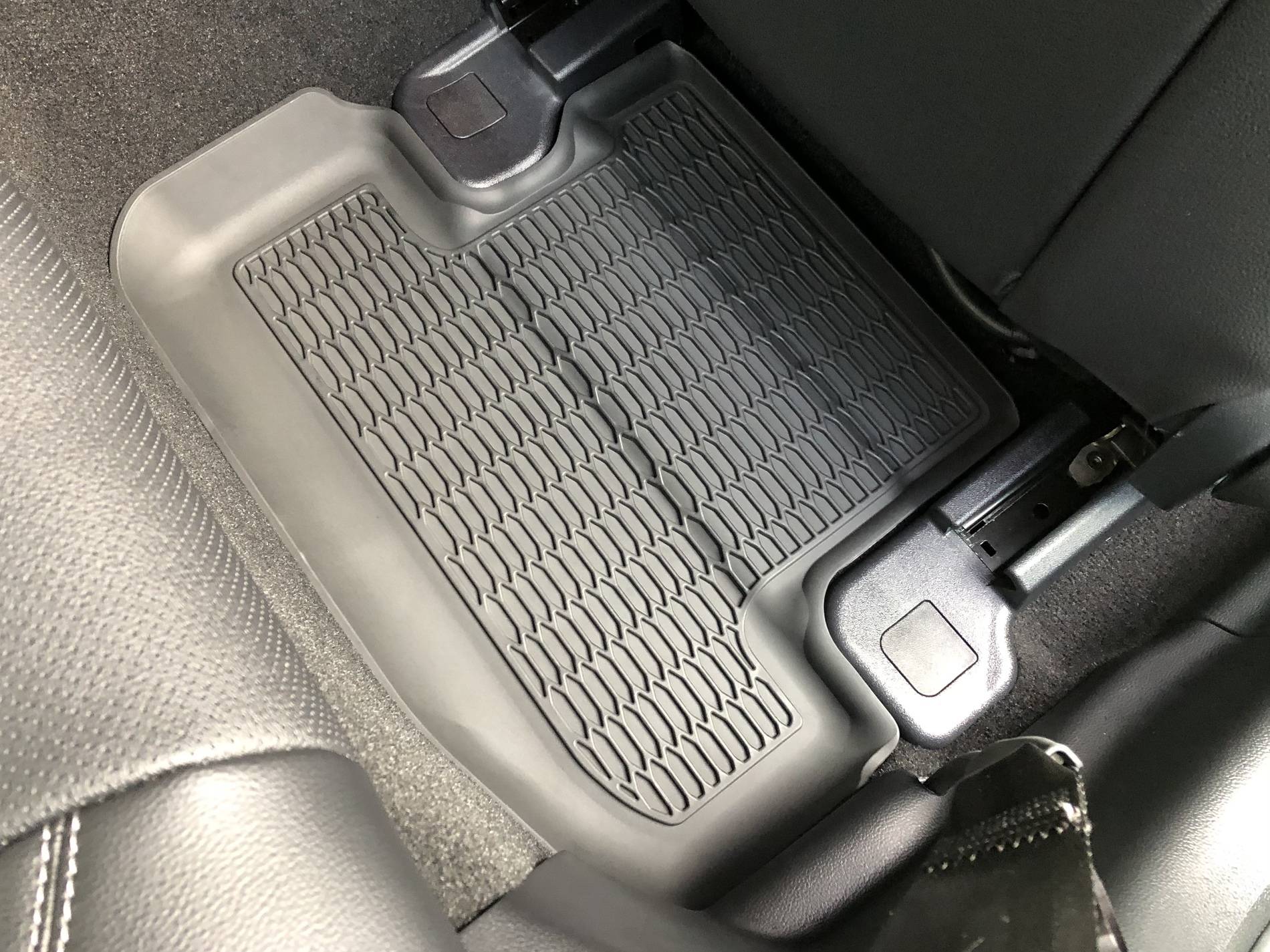

The best rear car mats I’ve ever had :

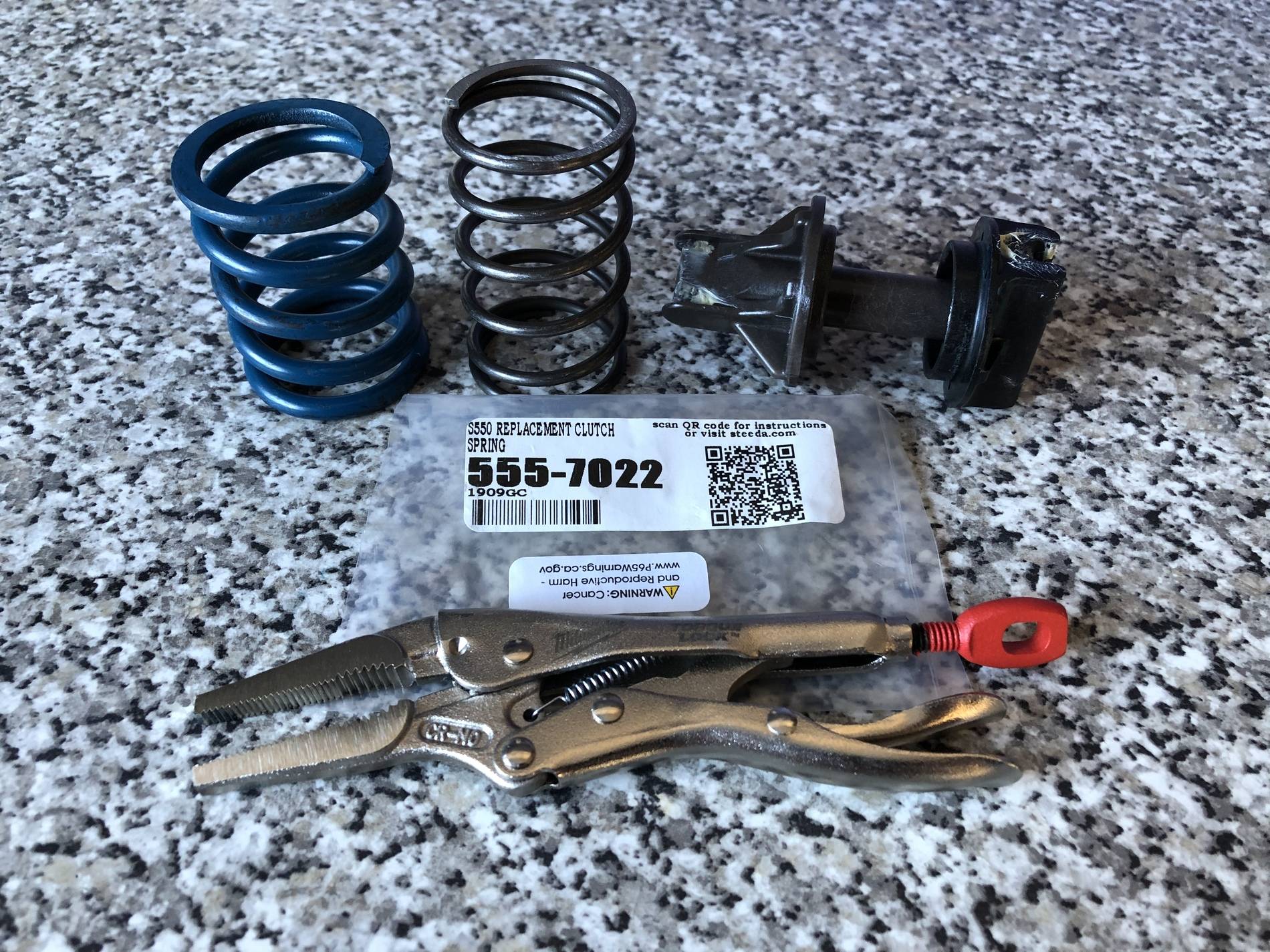

And the Steeda clutch return spring :
I think the locking pliers cost as much as the spring ... :facepalm:
The springs easy to fit with that tool and following the instructions - I’m not quite sure just how heavy handed you need to be to break the perch ... ? (Or perhaps Ford have beefed it up a little as the years have gone on ?).
Impressions ... ? Well, bear in in mind I’ve drove manual for 27 years and didn’t really have a problem with the original setup, but the spring was cheap and I already had it in the spares box so I had little to lose. Normal driving it only makes a little difference on initial setting off, it kind of feels like the pedal is a little harder, BUT only through a bit of it’s travel (about a third of the way through its travel as you release the clutch). It does kind of feel a bit more ‘linear’.
So after driving it around the estate so I had plenty stop start driving, I could take it or leave it - no real benefit (for me). However, I reverse up my drive through a gate on a bit of an incline at a speed where I’m right on the biting point of the clutch - in that scenario there was a marked improvement in feel / control. On those grounds alone I would recommend it (for me), especially considering the nominal outlay :like:

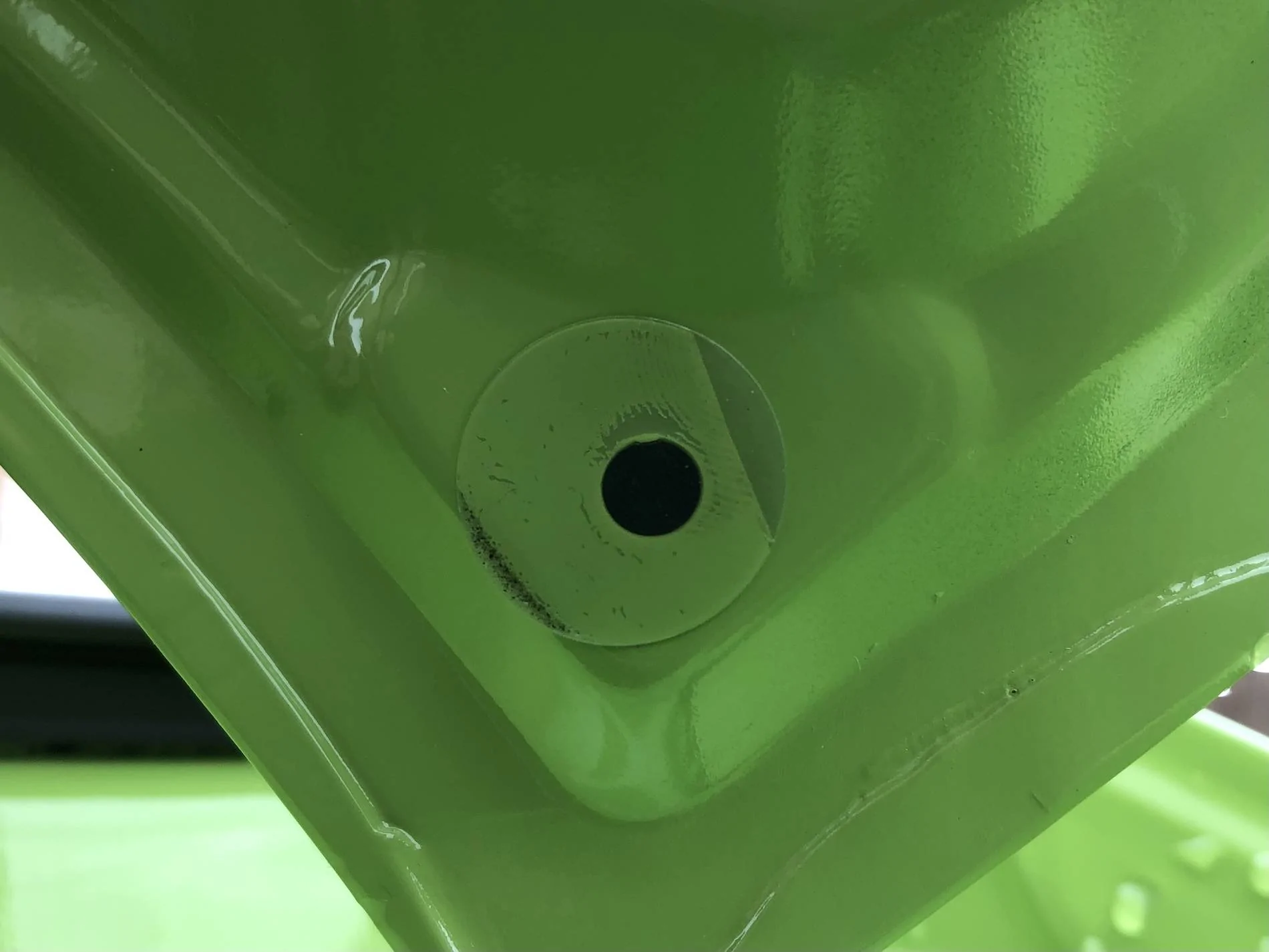

Removed Fords ‘poorly fitted already got shit under them’ decals :

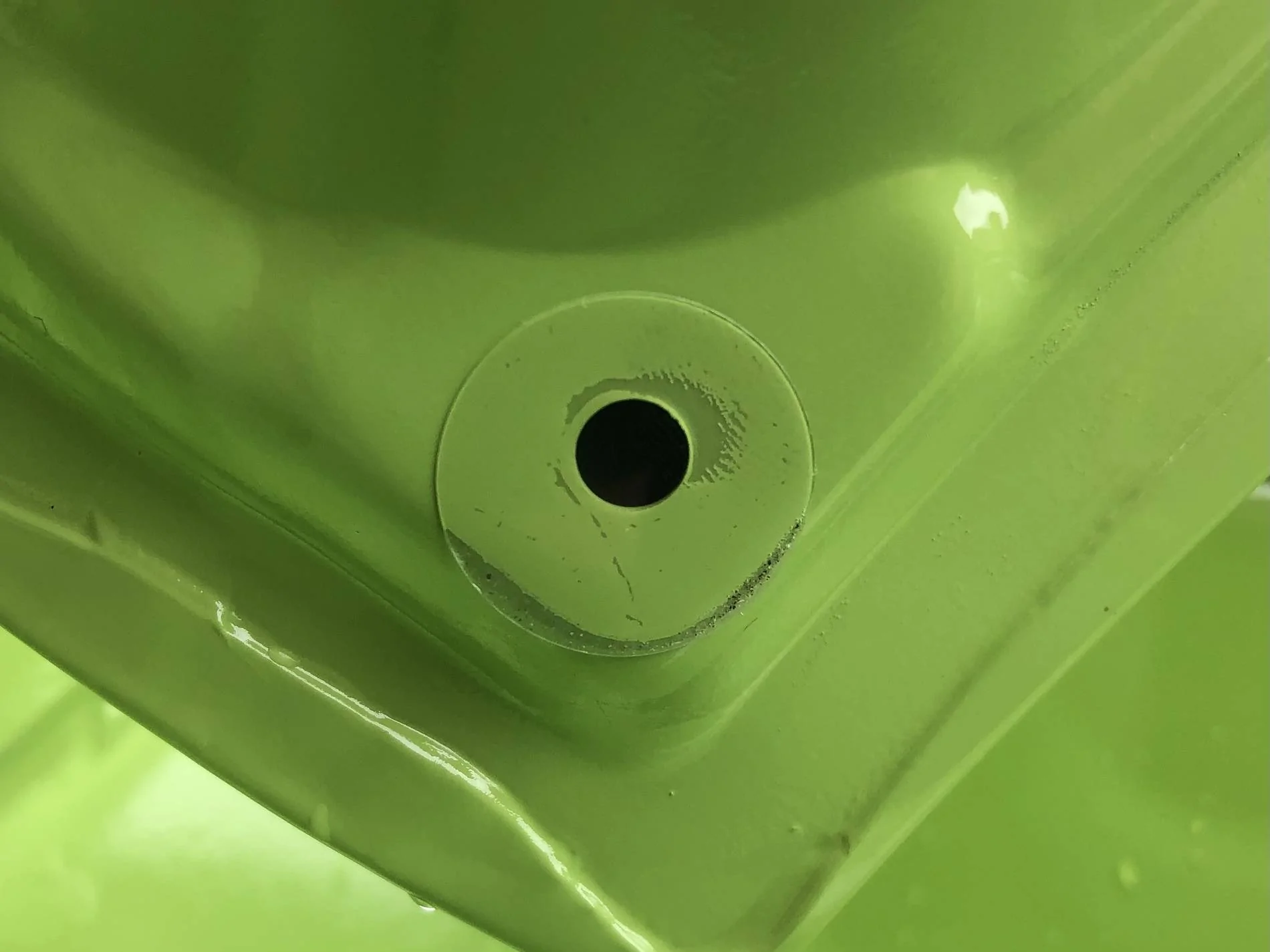

And replaced them with the ‘bit more care and attention’ version :

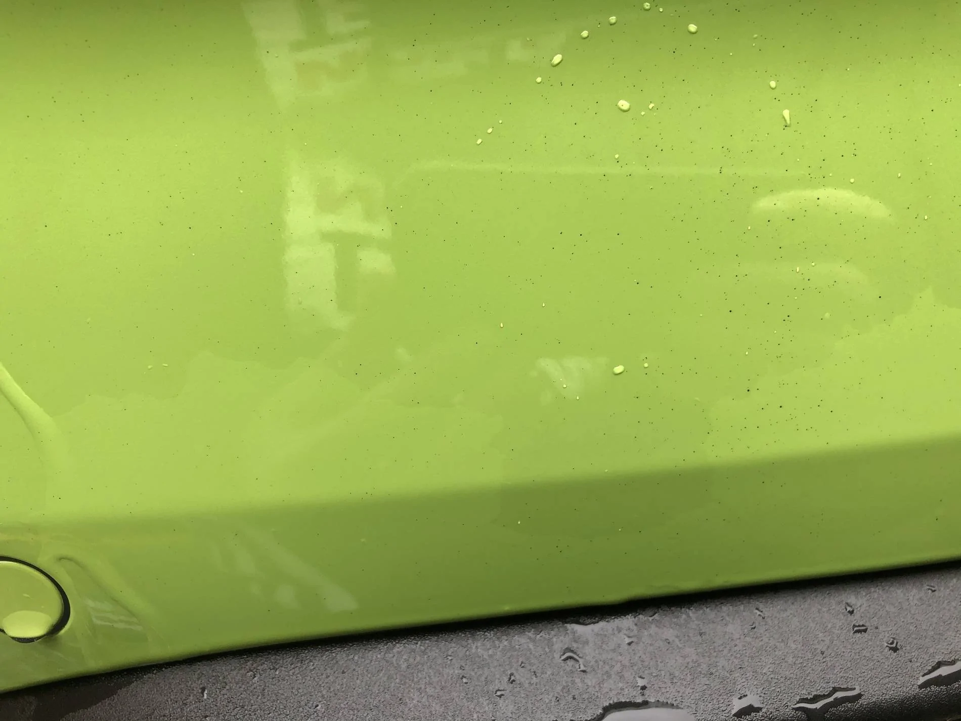

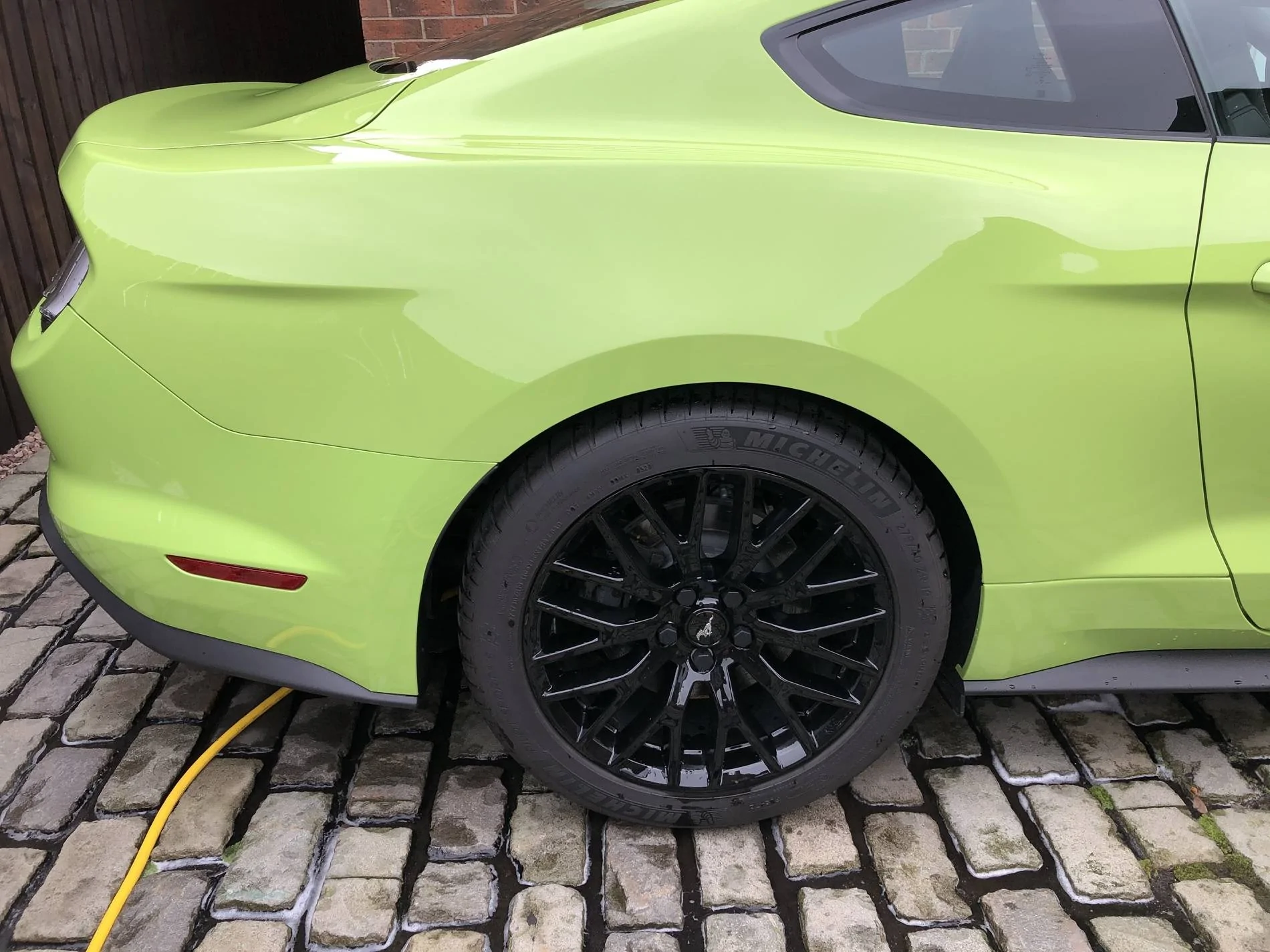

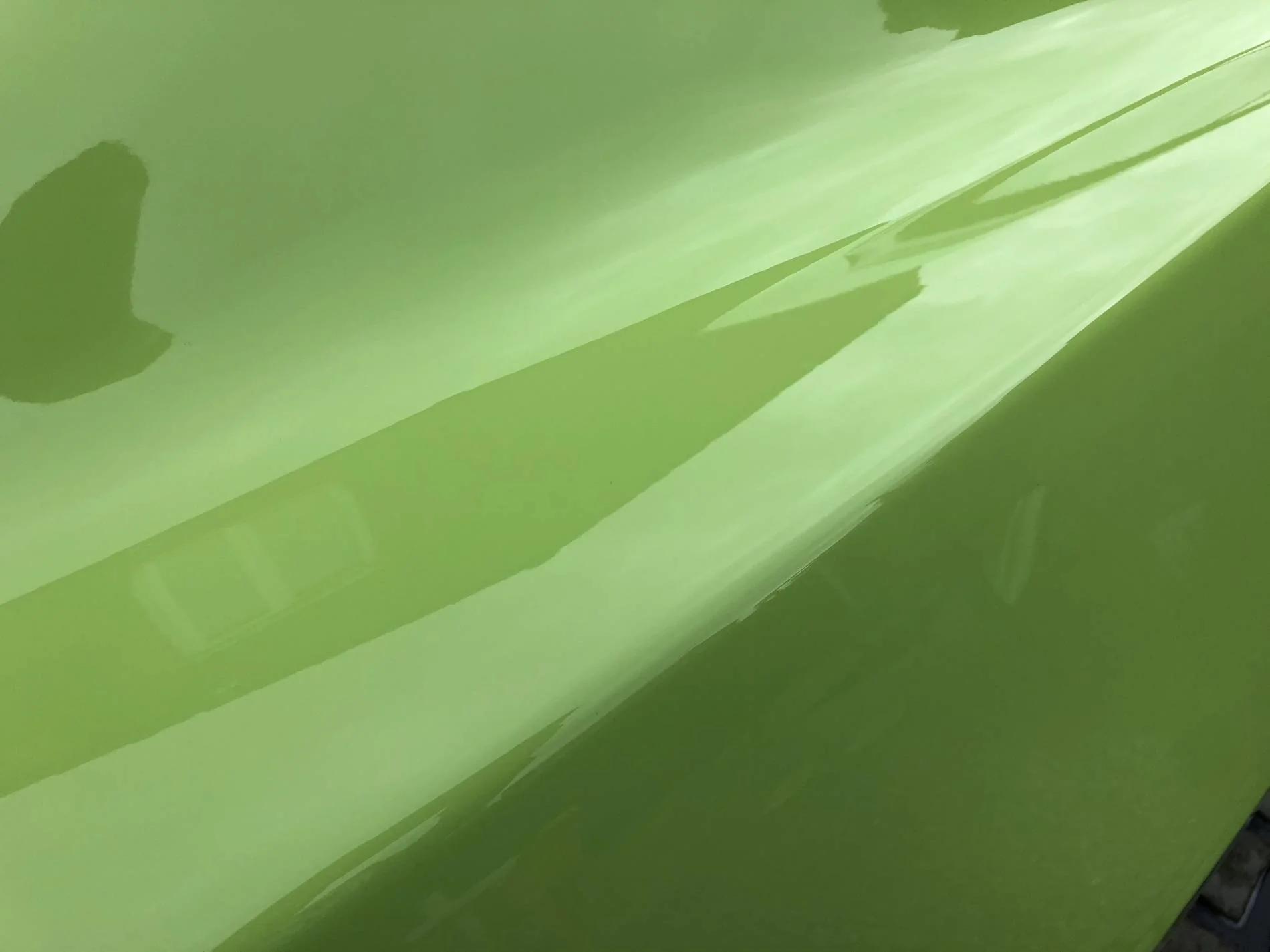

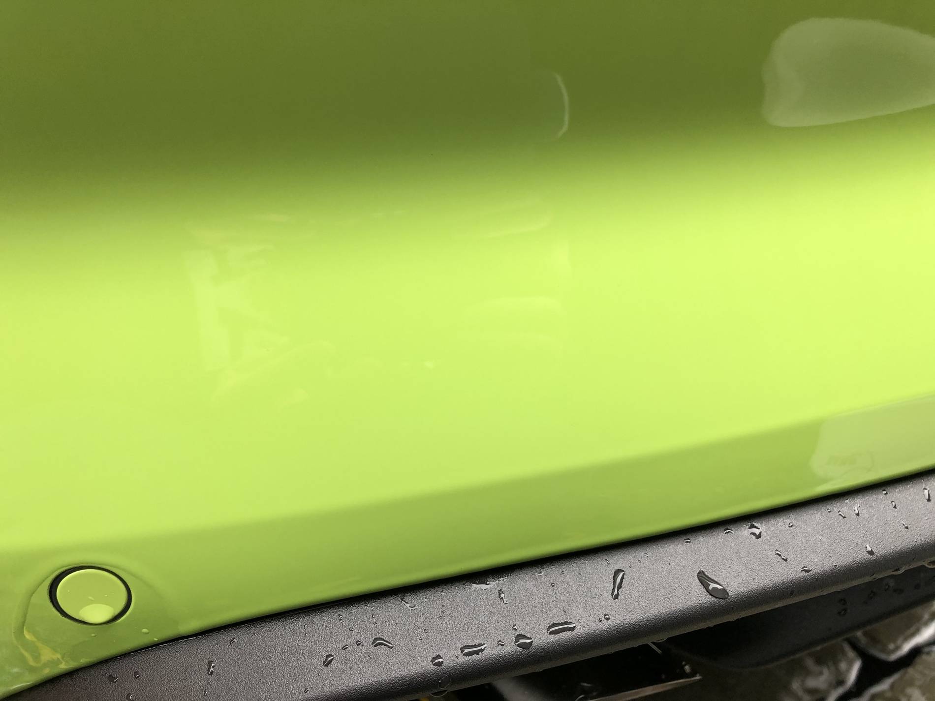

Started with the paintwork detail. Plenty of fallout on a U.K. version by the time it’s completed it’s journey. Any upwards facing surface that wasn’t covered during shipping is bad with the rear end being the worst, particular on the left hand side. This is the top of the rear quarter :
That bad it felt like it needed a shave ... :cwl:

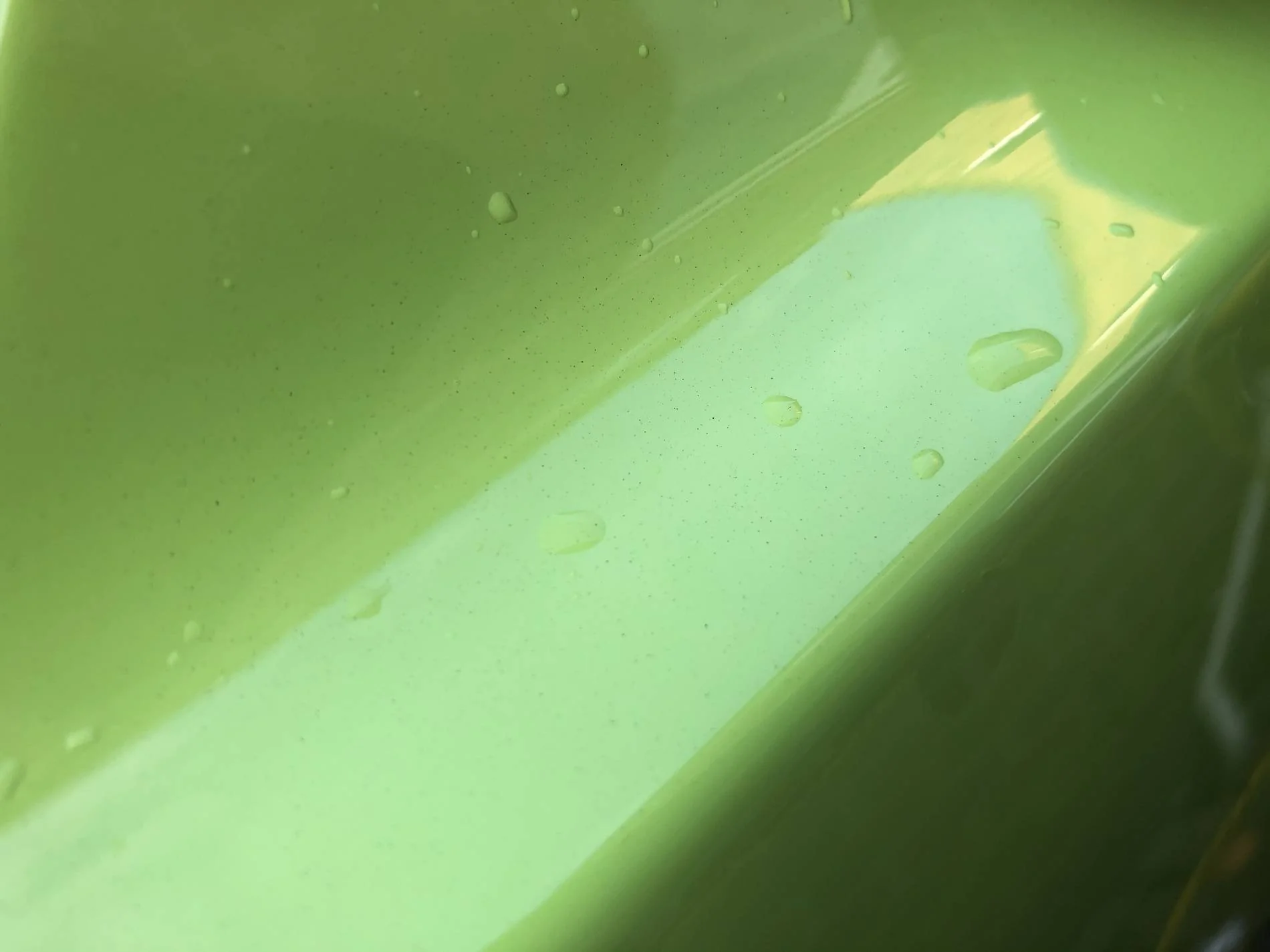

To make things even more fun, we also get the under seal overspray to deal with (parking sensor in shot as a size reference) :

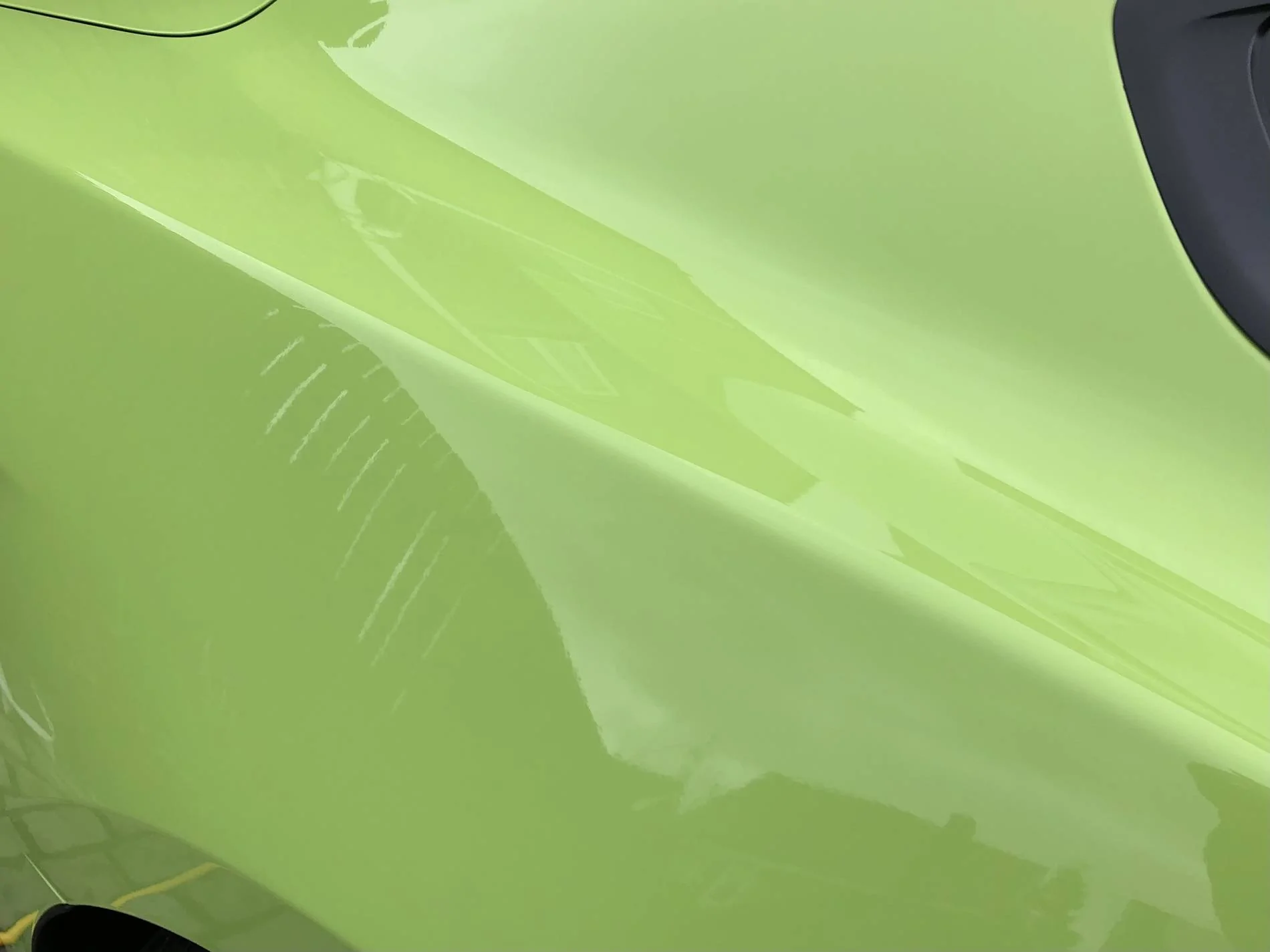

Looking much better now :
I used a clay mitt for the first time today. It’s a great time saver (I reckon it saved me about two hours), but for me it’s not a full substitute for a traditional clay bar. I still had to go old school with a small piece of clay to get into the more intricate areas, no way was the mitt getting right into the tight corners :
• Shut lines between rear fender and the sill piece.
• Shit (:cwl:) lines between rear fender and bumper.
• That gap under the rear lights.
• Return edges and around inside filler cap.
• Around the parking sensor black rings.
• Edge between bottom of window trims and paintwork.
• Bottom of A pillars on wing joint.
• Door returns.
• Door handle edges.
• Wing mirror edges.
• Those pesky little indentations on the top of the door handle.
Etc.
I lubed the mitt with an extra sudsy wash mix - worked great with zero marring :like:
Im still of the impression that the paint is in great shape, I’m not going to need the polisher at this moment in the cars life (I’d rather leave as much clear on it as possible - you never know when you may need it ...).
Some pre wax snaps :
Hopefully I will get some quality wax on there soon :like:

Well at least its got some protection on it now ... :whew:
I opted for Megs ultimate quick wax as A) I had a bottle in the garage and B) this stuff is so easy to use on wet panels / in damp conditions.
It beads really well and lasts quite well too, which is good considering the weather we have coming in this week.
In fact, I forgot how impressed I was with this stuff, how quick it is to use and the looks it provides - I'm now considering using it as a drying aid every few weeks to get me through the winter season :sunglasses:
I still found a few areas that needed a little more spot claying and I would still like to spend a bit more time on the rear lights. Other than that its just the front bumper that's not been touched - I want to leave that as long as possible due to the transport damage respray.
I think I've got about 12 hours invested in the paintwork now, but remember that I took this car from the ford dealer 'untouched'. Judging by what the dealers seem to turn out it's been well worth it, (IMHO) the paintwork is now to a much higher standard than I have seen on anything in the local showroom :like:
Wheels are the next thing to get detailed - not really looking forward to that job ...
WD :like:
