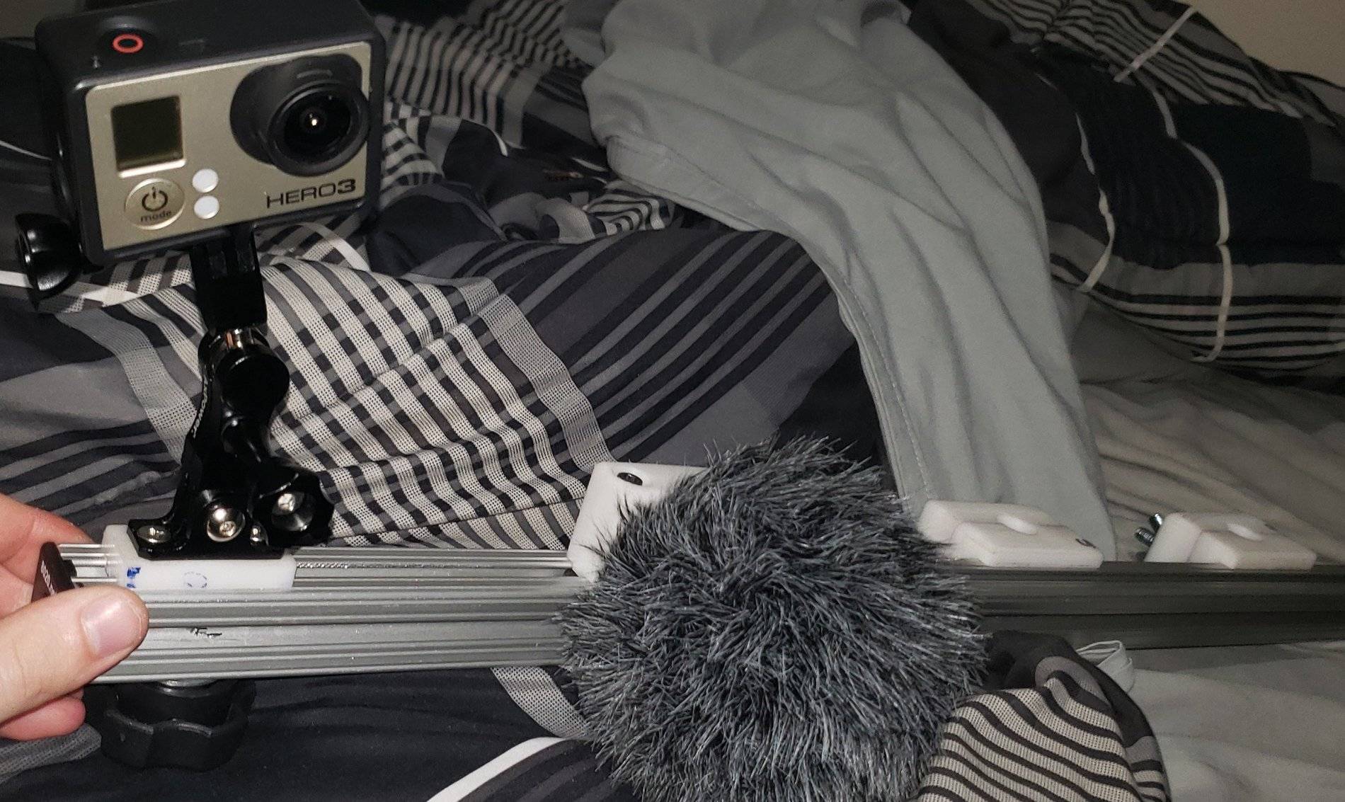

i cant chime in as far as apps, but i would love to see your ecoboost go around road america.
as far as mounts go i prefer the perspective from headrest view over windshield view.
(external mic isnt plugged in)
It's important to me to have the driver's hands in the frame. It's really tough to diagnose handing issues with just the windshield or roof-center view.
Yes, I was thinking maybe I'd try using the suction cup on the rear window. However, that would be a bit of a pain to start/stop. In the "old days" my VHS camera was mounted on a harness bar in my 911, which gave an excellent view of the driver, dash, and windshield.
Assuming I can get everything to work, I'll try to post some Eco Road America footage next week.
