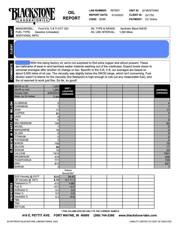

Oil analysis attached; it's normal. My analysis mirrors others posted here and elsewhere for a new Ford: high copper and silicon.
I've also attached a document explaining the different metals and elements found in an analysis, along with their possible sources.
My belief is the specks of metal are from the screen material in the separator itself.
Regarding high copper content in the engine analysis of a new engine, I've found several threads in multiple forums reporting same in Ford V8s (Mustangs, F-150s, etc.), catch can or not. New parts seating, machining leftovers, etc. There is also the effect of "passivation", when untreated copper (engine parts, coolers, tubing, etc.) encounters engine oil, and some copper is leached in the process.

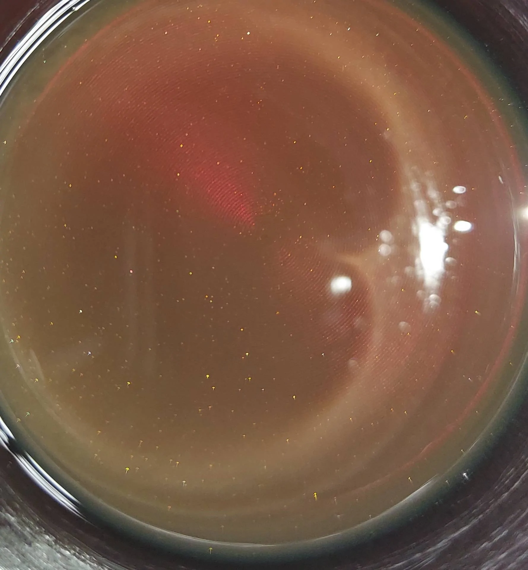

Last week, I removed and inspected the oil separator canister. I was surprised to see small metal specks within. The canister itself had maybe a tablespoon / 14.7 cc of fluid inside, possibly more. Below are two photos.
The first photo was taken at 250 mi / 402 km. I didn't notice it at the time, but there are small metal specks of material present then.
The second photo was taken at 1172 mi / 1886 km. The canister has been rattled to distribute the material, to give me an idea of amount seen. There appears to have been an increase since the first reading.
I have not measured the amount of metal material collected, but will do so at first oil change.
Studying other threads on different forums, these specks seem to be somewhat common. The vehicle make, model or engine does not matter. Many owners see these materials consistently, in varying amounts. No owner has reported engine problems. For the drivers which have performed oil analysis and reported back, they have gotten good tests.

I did not study the separator mechanism itself before installing. I remember there was a very fine mesh screen in the upper section I briefly touched and then left alone. Some say the specks are simply from this screen and "brillo pad" like material used within. Part of the manufacturing process, the harmonics of the engine rattling the can, etc.

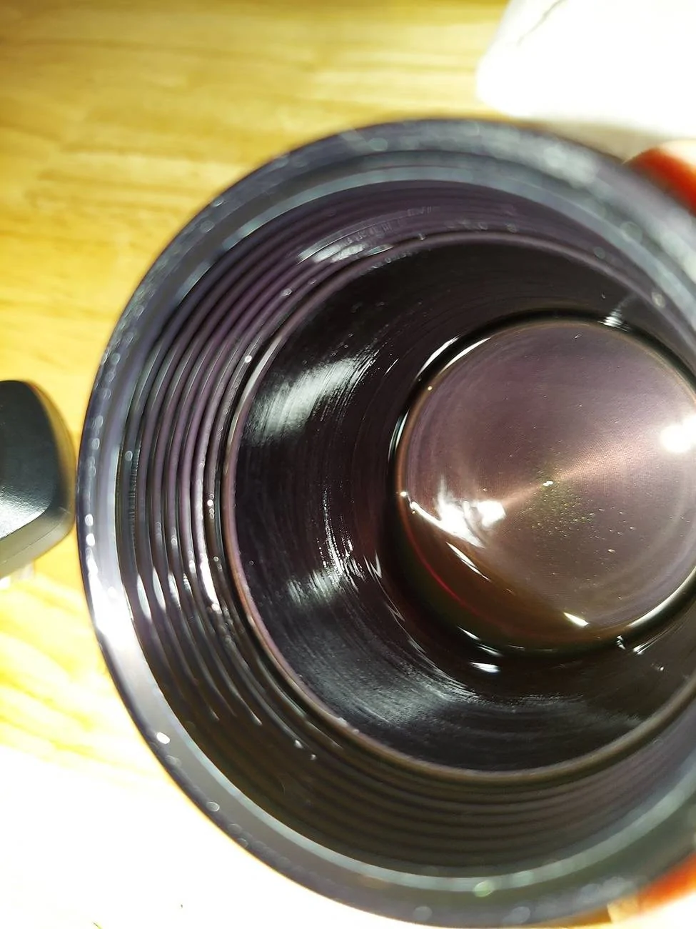

Completing my second oil change today, thought I'd come back with some photos and a follow-up.
Picture 1 is from the first oil change, 1265 miles / 2035 kms. Oil analysis is posted above.
Picture 2 is from the second, 2549 miles / 4102 kms. Oil analysis kit will be sent off tomorrow.

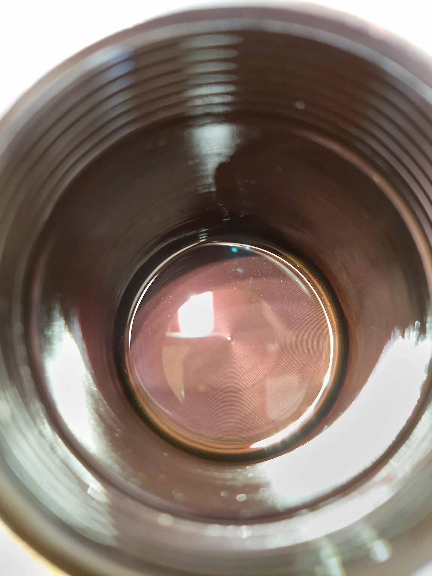

Picture 3 was taken at 3775 miles / 6075 kms. Oil change will occur in a few weeks.
I clean out the oil catch can during the oil change. I'm accumulating 1 tbs / 15 ml at each interval. This is not a lot, but if I were to extend this several thousand miles, as with a DD, the amount being captured then becomes quite a bit.
Regarding the glitter and interest of this thread, the amount seen this time is markedly less than before. I'll post pictures of the drain plug and analysis later, but the particles seen on the drain plug look nothing like these.
My experience leads me to believe the glitter seen is from the JLT canister, leftovers from when the brillo-pad like screen assembly was created.

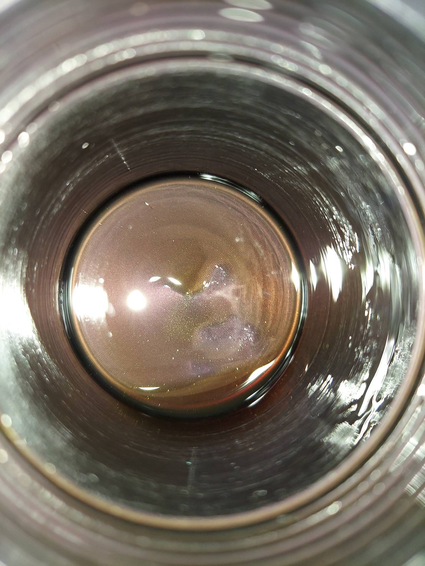

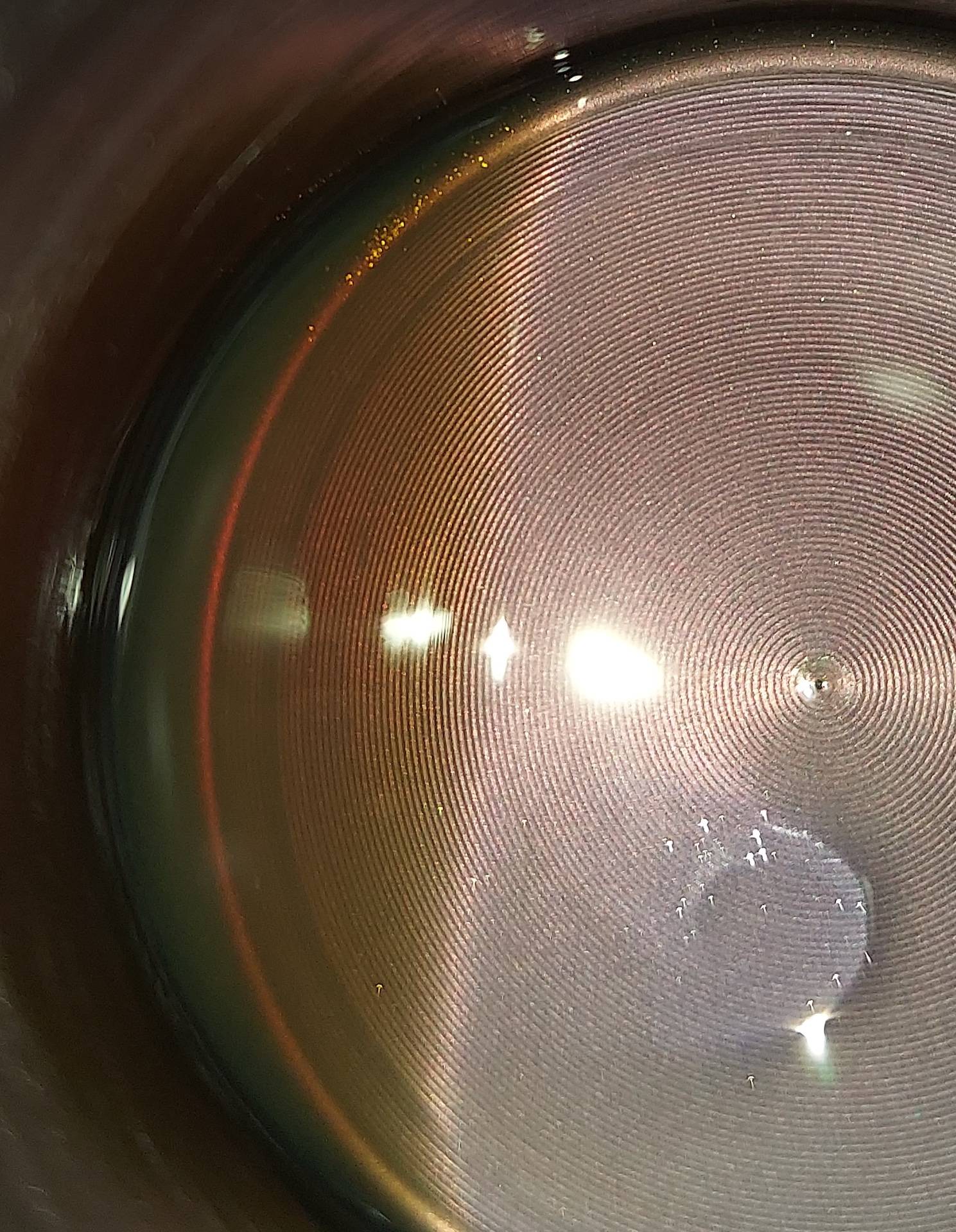

Edit,
Attaching a third pic today, highlighting how even less is in the can this season. I continue to consistently draw between 10-15ml each season, which, extrapolated over a 10,000 mile / 16,000 km interval, would be 1/4 cup, 59 ml.
July, 2025, Attaching fourth pic today. Over time, the glitter has become less and less. Oil analysis has proven things in the engine are OK. I continue to draw 15ml of oil each season. So...the golden glitter seems to be nothing but the catch can itself, the mesh material inside.

ORRadtech
Sep 12, 2019
4,141
4,102
Atlanta, Georgia
Well, that Blackstone report should ease your mind.
