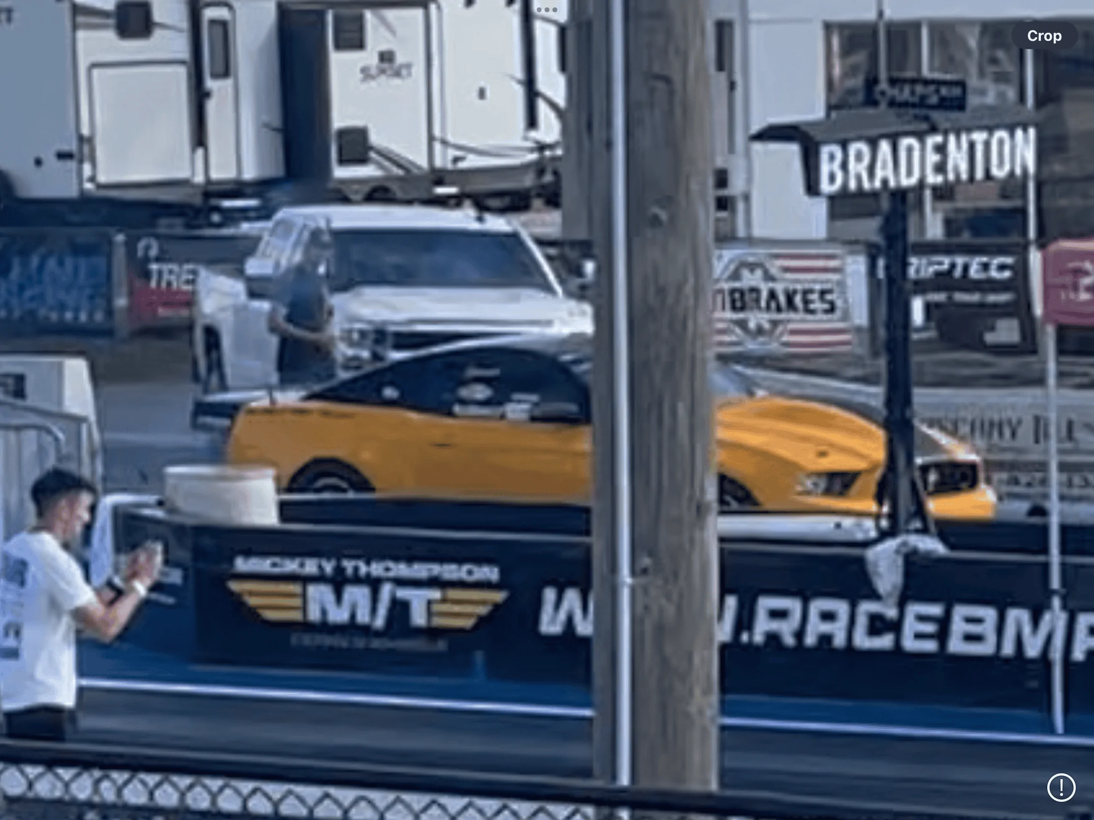

The Boss is a very nice car. I saw this one which was heavily modified at my local drag strip. Very clean and subtle, but also very quick too.
