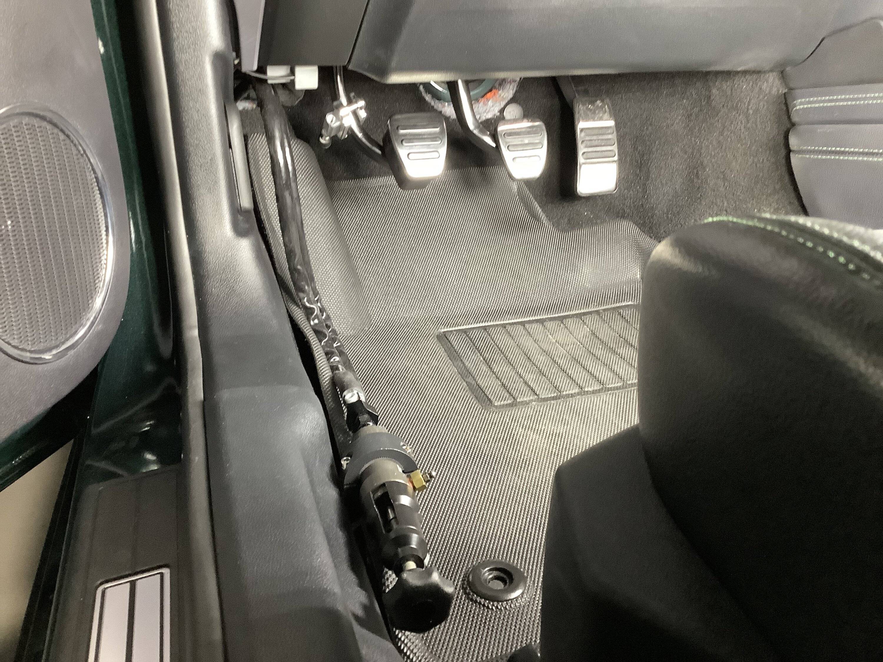

Have you thought about installing a clutch pedal stop to fine-tune and get rid of some of the excess slop? I put one in my car and it works great. Here’s the link to where II bought mine. I purchased the one for an ‘05-‘09 Mustang.
https://werksjdmstore.com/products/...CrEVT2SUdDjgJXxmf9g5SwIFIpt7a-l53RC2_7xUvb5_k
