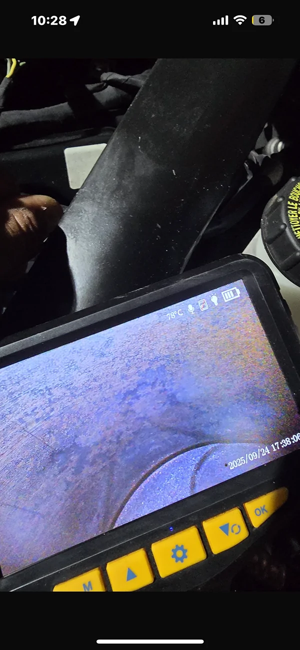

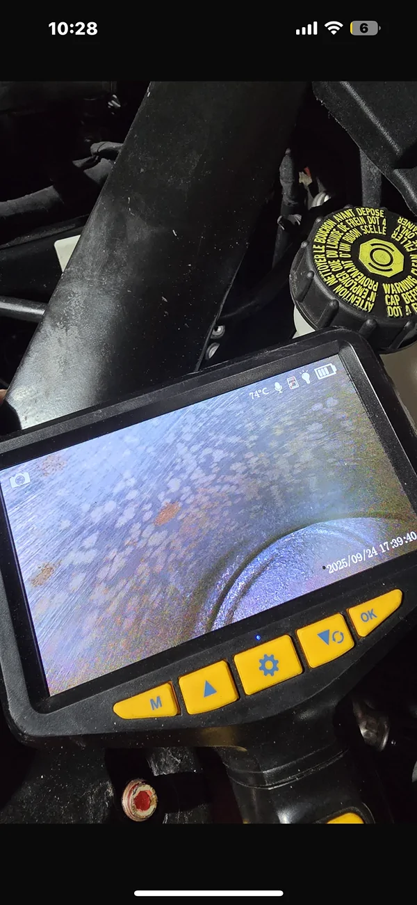

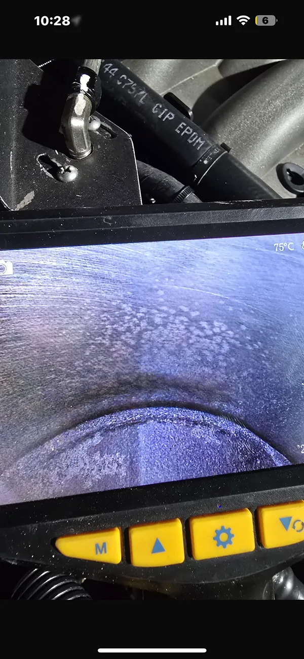

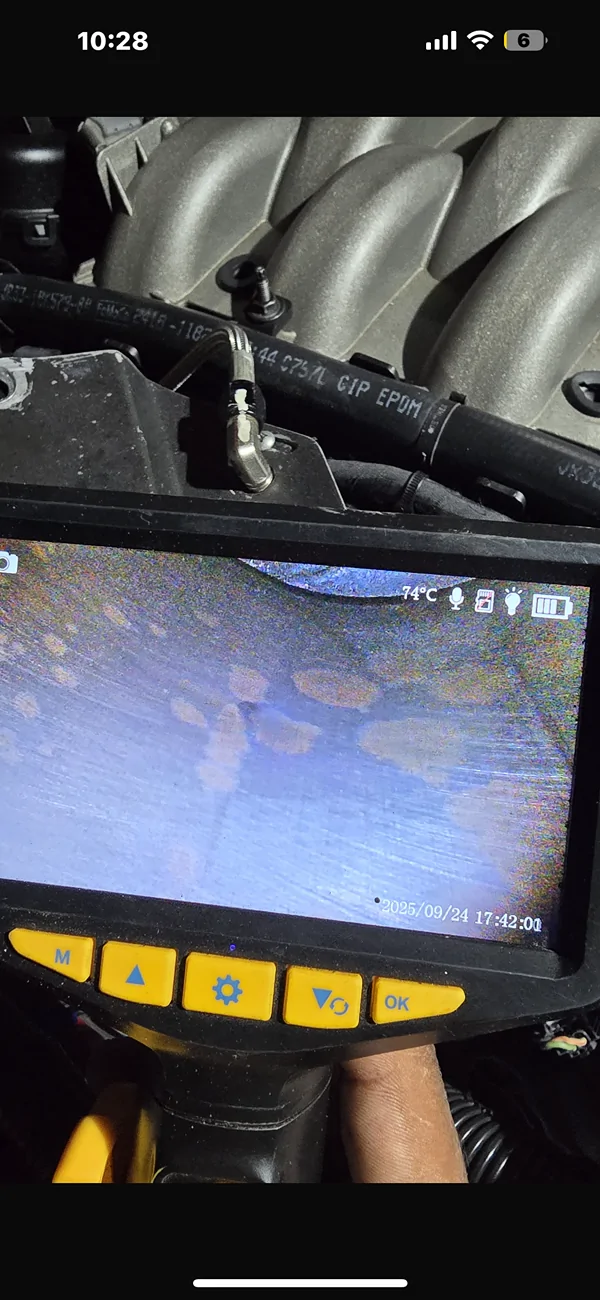

Hey so I have fiends car that give maintance, a gen3 coyote mustang 2019 and we are having some problems and wanna ask if someone here has ever have this problem.
The car temperature while you cruise o have normal drive it’s always good between 195 en 208 f but as soon you give WOT the car raise the temperature crazy, up to 250 f (coolant temp) we have a Ford performance coolant pump, new thermostat, mishimoto 3 way pass aluminum radiator everything and the temperature raise really quick and that high, no problems on the coolant no extra pressure on the hoses no smoke nothing.
After that we check the cylinders with a camera and we saw this on the pictures that I attached
It will be very helpful I you can give me an idea of what can be causing that

Those cylinders look kind of dry , patchy and rusted ?
how do each cylinder look on a compression test ??
are you running E85 ??
also are you sure both fans are operating correctly ??

In processing the marks on the cylinder walls...
Car is a 2019. Does this engine have a history of repair? Cylinder heads off? Pistons removed? Prior internal mechanical failure and damage?
I don't know what I'm looking at, the "splash" marks on the cylinder walls. I feel like the engine block has seen some prior damage. Either the original engine has been rebuilt, or this block is a donor from another vehicle.
