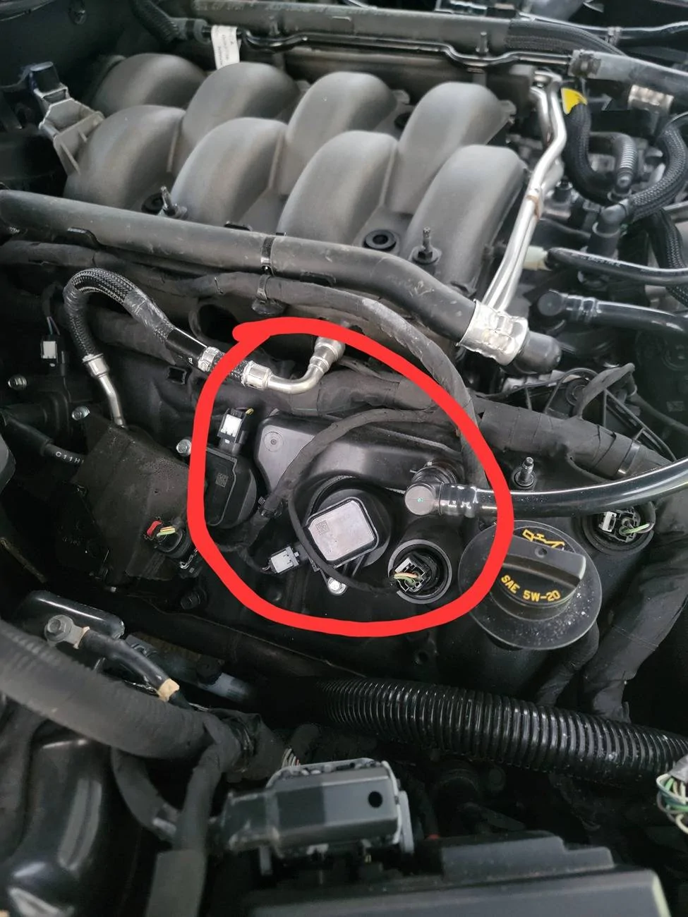

Here's mine and my noise.

Cam phasers are very near there .. also the high pressure fuel pump is like 4" behind that on the passenger side cam cover

I don't think keyword think it's cam phaser just cause it's behind it and usually cam phaser is a throaty rattle if that make sense. I'll swap back old hpfp this weekend and see if it goes away.

Noise has died down a bit, I think part of my issue is when I put in new hpfp I didn't oil it properly causing more noise to sleep through valve cover. Noise has died down as well ever since I put in old hpfp
