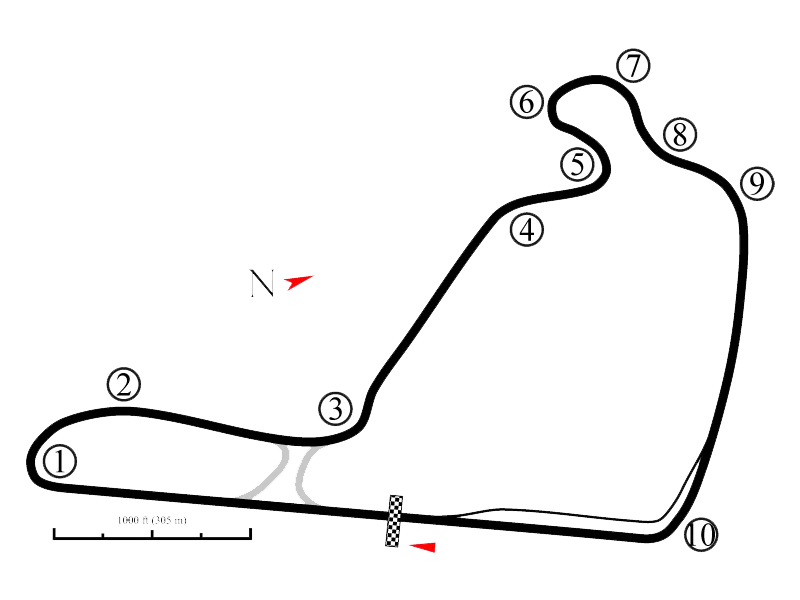

Here is the track I was on this past Friday. Happy 4th of July!

The event I did was a 2-days event with 5 run groups (beginner, intermediate, int-advanced, advanced, and instructors). Each group gets 4 30-minute track sessions per day on Saturday and Sunday. We were on the same circuit (Summit Point Main). Running the whole track in 4th gear will def. keep temps down.
I shift into 4th on the start/finish straight, go down to 3 in turn 1, and use 3rd gear from 1 all the way through turn 9, then go to 4th between 9 and 10, and back to 3rd to enter the front stretch. I'm kissing redline before turn 3, and again before a slight lift/brake brush going into 4. I'm running to redline on the start/finish straight, hitting ~142-143 in 4th before braking for 1.
Next time I'm there, I'm going to experiment with downshifting to 2 in in turn 1 for a better exit, and getting into 4th for ~2 seconds before downshifting into turn 3. It may end up being a wash if the complexity of the extra shifting messes me up on turn-ins.
That sounds eerily close to my shift patterns. I loved staying in 3rd after turn 1 and holding it close to redline through turn 9, sometimes holding 3rd gear all the way through turn 10 and then shifting to 4th on the straightway until turn 1, down to 3 again. Also, I experimented shifting into 4th after turn 9 until the bridge, then downshifting into 3rd again,,,this was to experiment with my apex speeds; both entry and exit. One thing I noticed, was that I was never concerned about the brakes, no matter how I drove the car.
Did you also have the factory pads, tires, and wheels during your sessions? What group were you in? Since I had the instructor, I could feel my car straining for speed at the end of the straight from 10 to 1.
How much track time do you have at Summit Point? This was my first time at that track. Thanks. :cheers:

I've got ~10 track days at Summit Point. Last time I drove that circuit was in 2004 - it didn't end well. My student decided to put my side of the car into the tire wall off on the left side before T5 at like 75MPH on the 1st lap of the 1st run of the 1st day! Totaled his car and I was banged up pretty badly (nothing permanent). Prior to that I got my first session in. I now had to swap my tires right away, pack up and head out for a long, painful drive back to Jersey. The next time I was there was 2006, but we did the Shenandoah, which I did not care for.
In any case, I remember doing a lot more shifting, but I was driving AWD cars and a well set-up FWD car. As I recall, 2nd into T1, back to 3rd before T3, 2nd into T5, 3rd before T9, 4th then back to 3rd before T10, back to 4th on the front straight. I also used to throttle steer in T8 (brief lift off the throttle, then back on momentarily lightens the rear and increases grip at the front which helps rotate the car). Not sure if this is necessary or would help on a GT350 though.

I'm only nosing in to say that the shifting described here for Summit Point Main is effectively loafing around that track. Really loafing. Don't get me wrong: taking it easy is perfectly ok when getting acclimated and learning a track. The point is you had fun and enjoyed your car. That's all that matters. Period.
I am curious, though, if you were paying attention to your revs, particularly coming onto the front straight in third gear? That's "typically" a fourth gear corner (and full throttle). I ask because it's when we work up and down through the revs and try to max power that we generate the most heat, which can result in the infamous "limp mode." I would expect that you'd be around 7K revs or higher through that turn in third.
