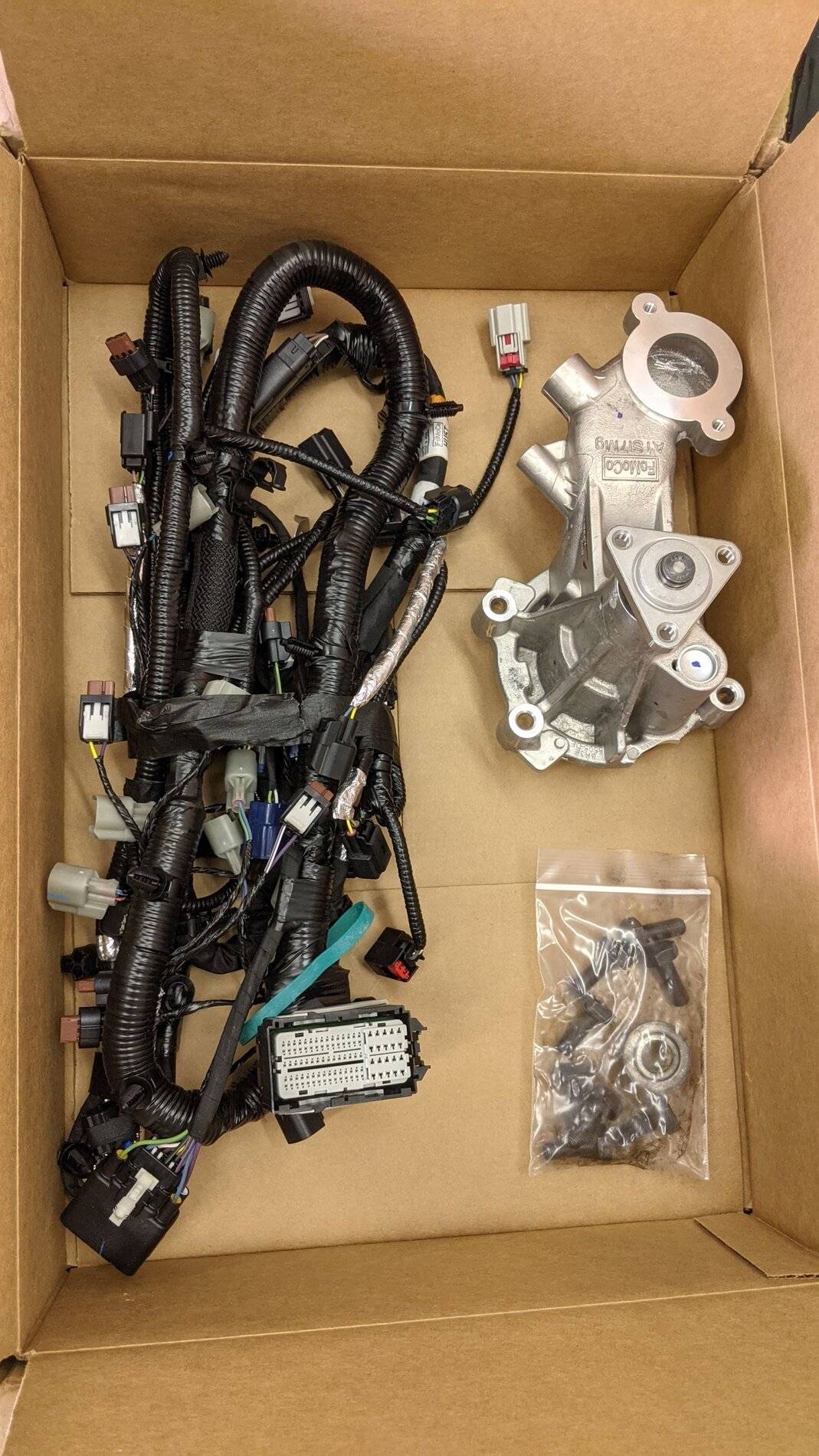

Still waiting on engine builder and should hear something soon. I did receive the manual trans engine harness and new water pump

You got the Control pack ?
I have a gen2 control pack which comes with a specific harness. Pic posted today is the engine harness, which is not included in the control pack. Manual and 6r80 harnesses are specific.
olaosunt
Jan 10, 2015
72
4,291
1,575
Indiana
Guard,base,M6,KB-2.DIB,auto,Hellion TT,2016 GT 350/Gen 3 Whipple ,2018 Mustang GT/Gen 5 Whipple
Go it .
I also have the Gen 2 control pack with seperate harness for a 6r80 .
I think it’s only different from the manual one in that it has a connection to the control pack for the 6r80 (since the ECU does not control the manual )
I could have used the manual one with my TH400 but wanted to have the option to switch to a 6r80 ... without having to buy a new harness

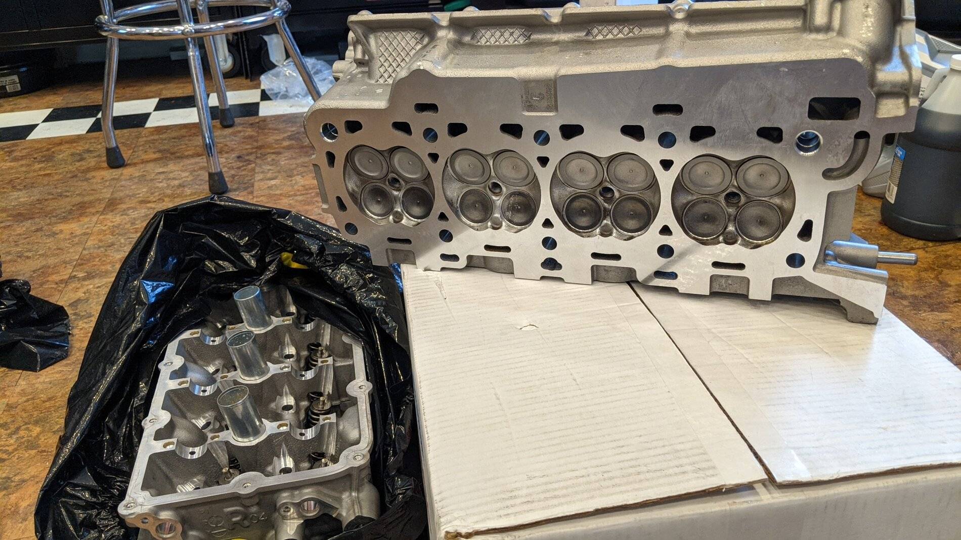

Heads done also, milled, new boss 302r springs (stock gen2 LOL), new valve seals and valve job.

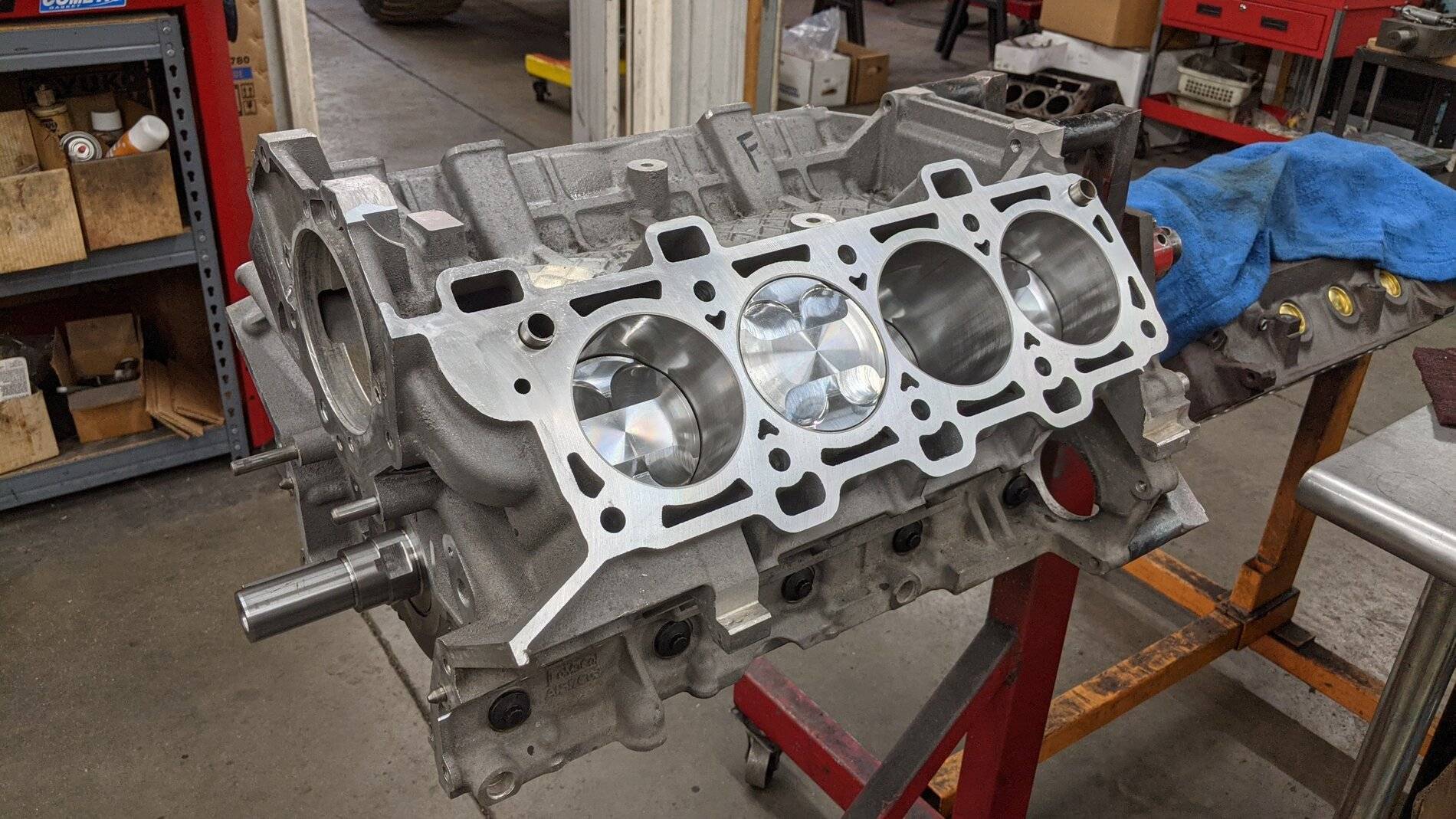

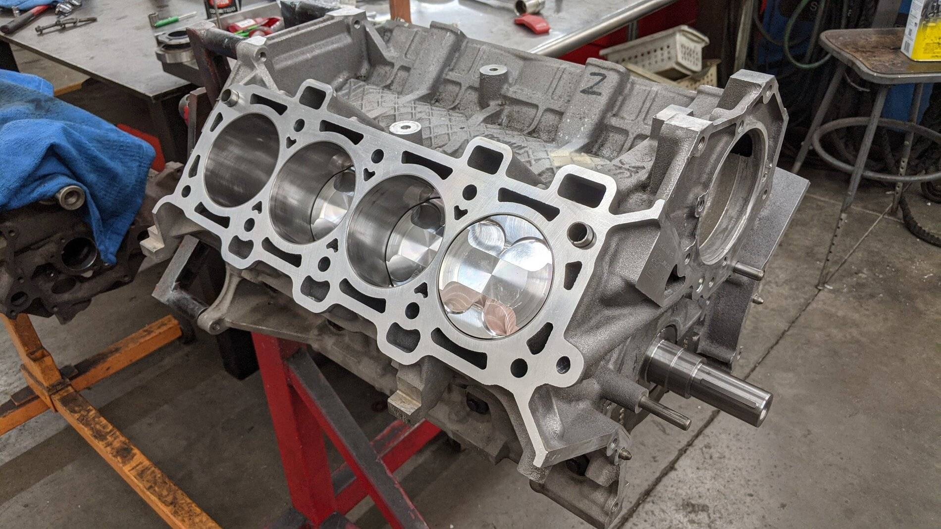

Unloading these boat anchors... Gen2 shortblock core available. Hit me up.

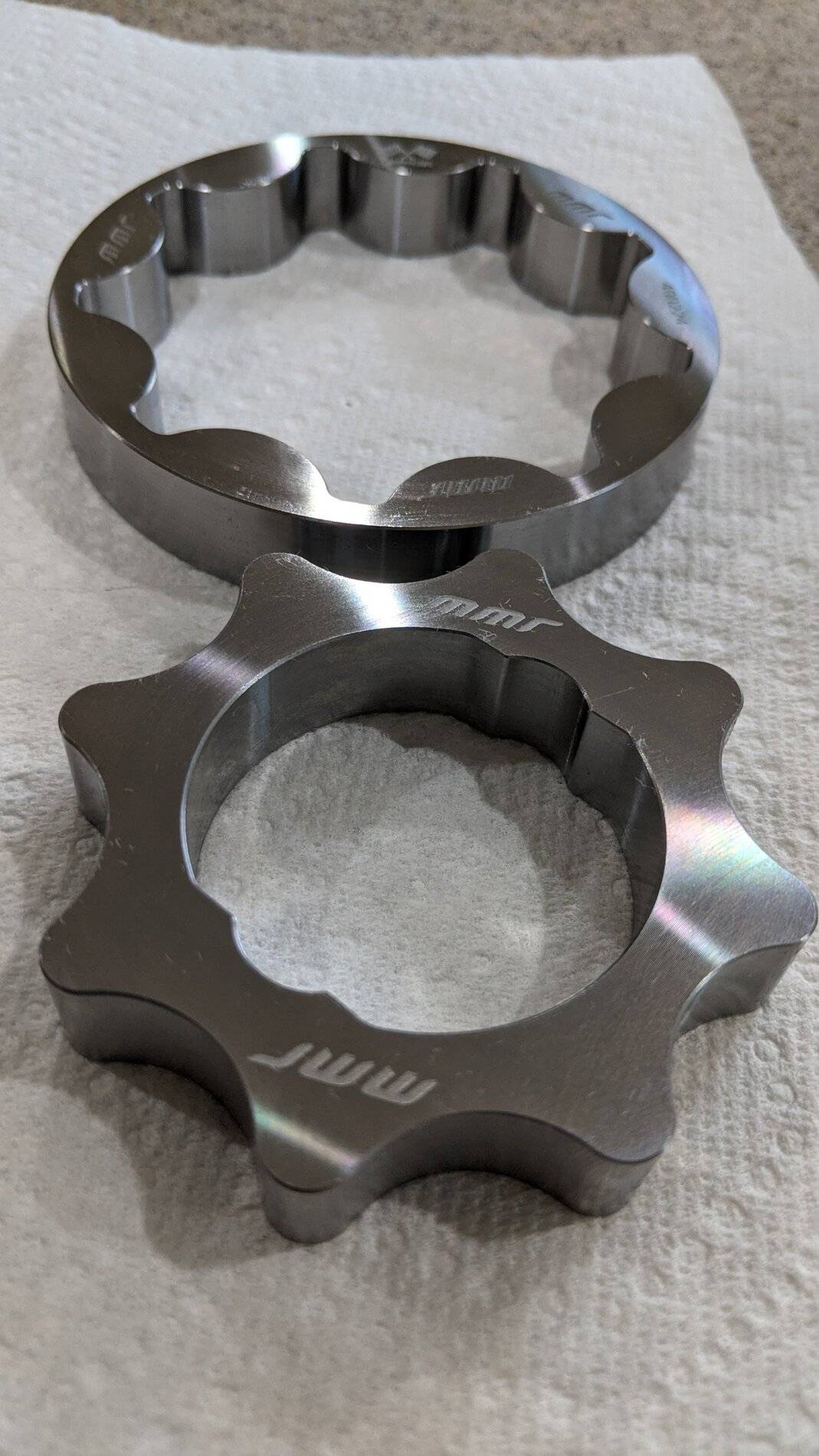

Grabbed some OPGs from @beefcake , few more valvetrain related items trickling in then the engine assembly will begin!!
Went with MMR vs the FP for this setup. Why not run the FP in this too?
