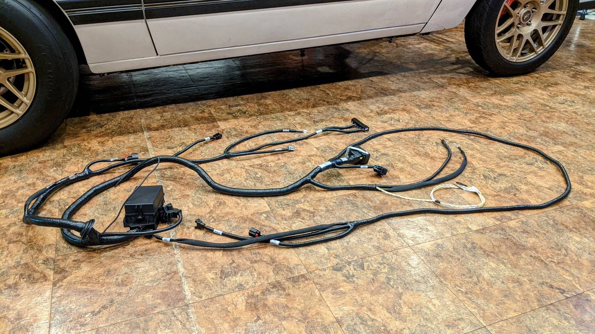

At least another week on the shortblock and heads. I plan to pull the existing wiring and wait untill engine and trans is in the car before installing the control pack. I want to make sure everything is routed as such, and want to make sure nothing has to be moved once the engine is in.
