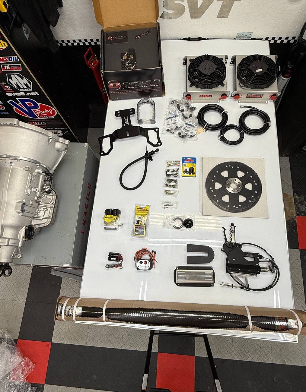

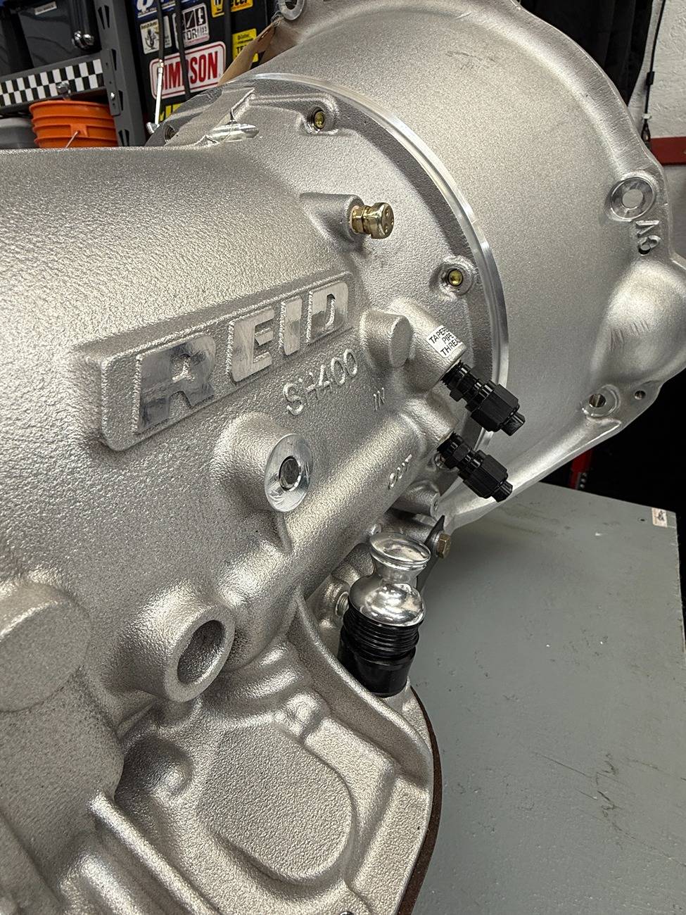

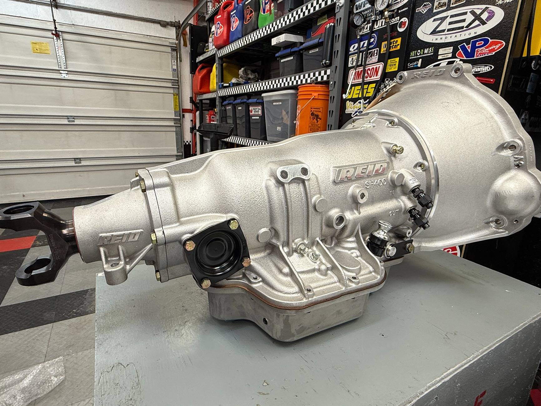

I finally decided to make the change from a fully built 6r80 wanted something simple and reliable so this TH400 build got underway. A friend was selling a TH400 that he had built by JH Transmissions in Edmonton for his terminator, but he never got around to installing it. I scooped that up along with his new Derale 13870 Trans cooler. I ordered most other parts through JPCracing and CircleD in the middle of November 2024 and had them shipped to a US border store so I could haul everything back to Alberta over Christmas.
I miss how busy car forums used to be before so many people started going to FB groups. There was so many great How To posts with detailed writeups that got me through projects over the years. Just cant get the detail on a fb groups so I wanted to make a contribution with this thread. I will try to update it as I install throughout this winter.

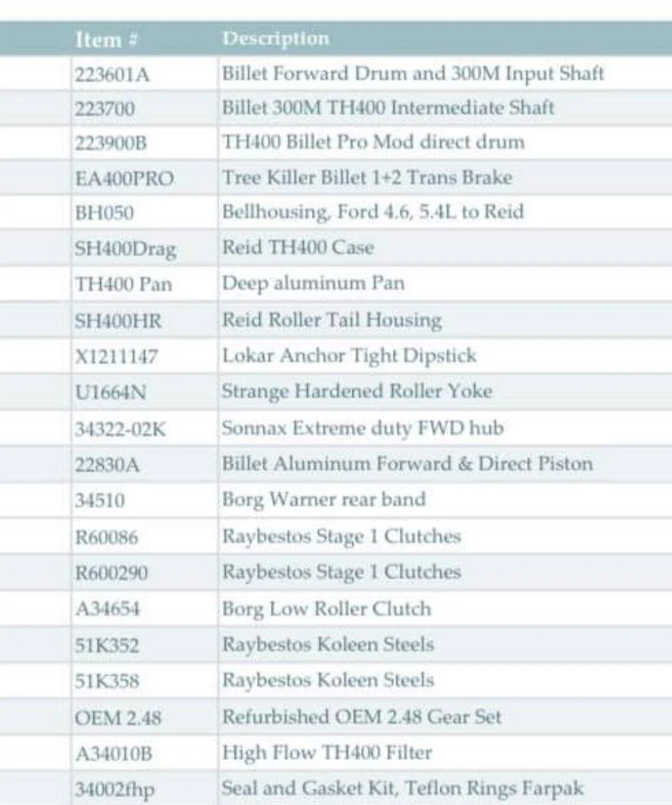

TH400 Build Sheet
From Mike Riddle @jpcracing I ordered their Th400 Completion Kit minus the converter and a bunch of other stuff.

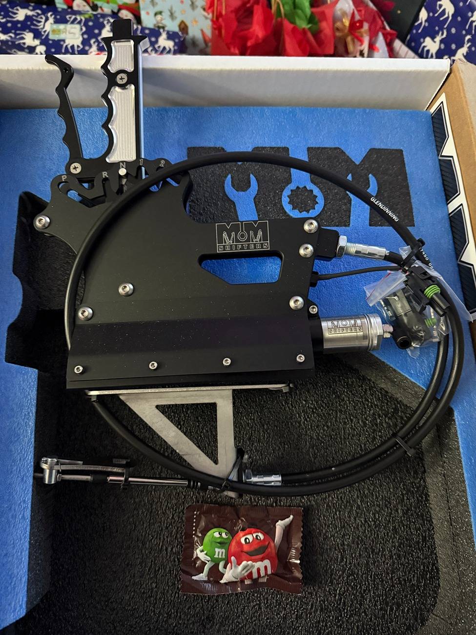

-M&M Co2 reverse pattern 3spd shifter w/Polished handle
-PST Carbon driveshaft
-Trans Mount/ DS Loop
-Proformance dual dumpvalve
-Derale 13870 cooler w/ptfe hose & Fragola fittiings
-Mike Thomas Fab shifter mount
-AEM autometer X Temp gauge
-Remote Dipstick
-SFI Flexplate w/pilot adapter

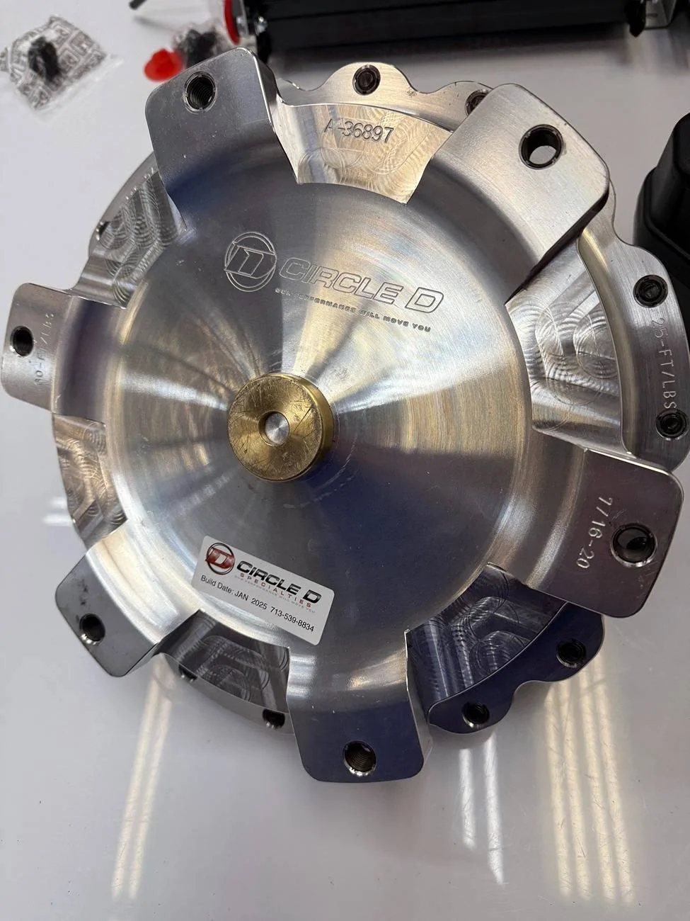

Converter was ordered from Dan Palmari @CircleD - TH400 Pro series Bolt together 252mm
Smooth Stager and EVAP delete fitting from @BeefcakeRacing
Extra PTFE hose and fittings from @Racetronix
All of those guys are great to deal with and the companies are great!

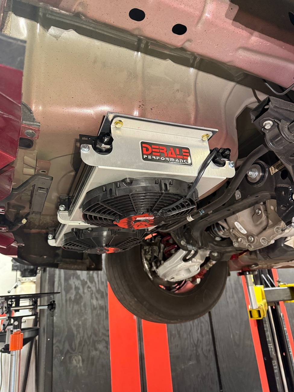

Trans Cooler Install

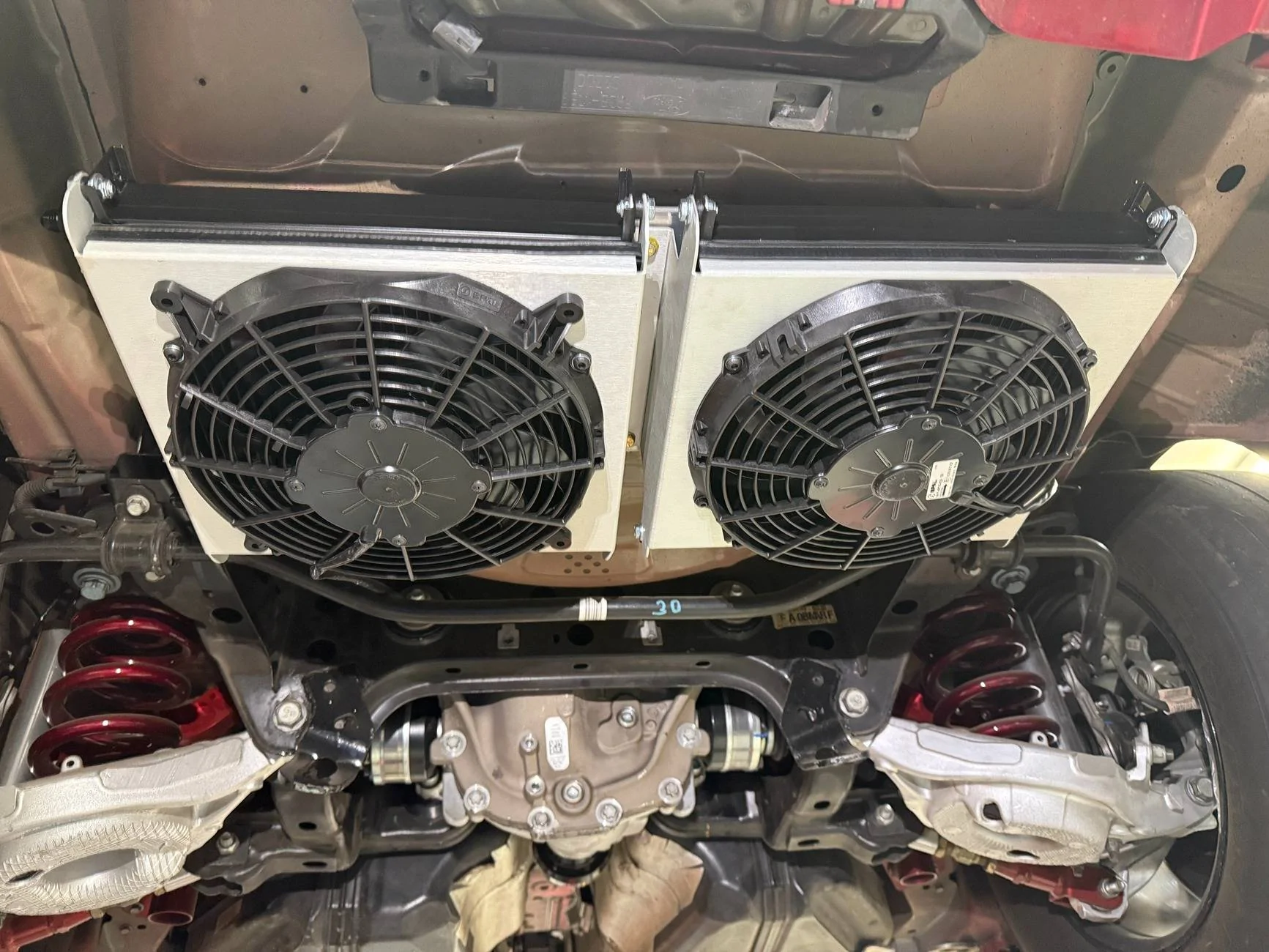

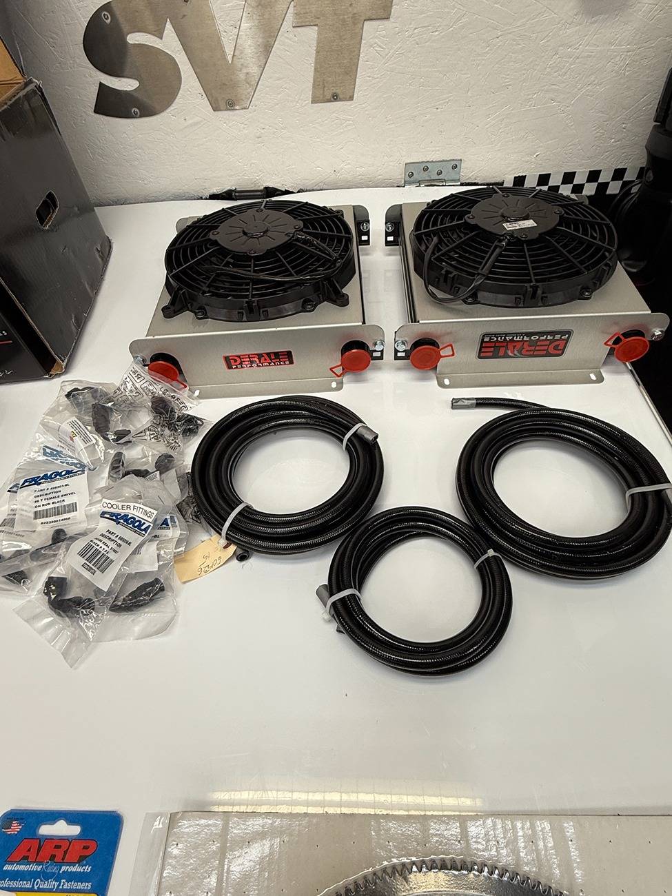

Two Derale 13870 800cfm trans coolers plumbed in Parallel, wired up to a temperature switch which will turn on at 160f and off at 145f. Also wired a relay so that I can run an LED switch to the center console so I can override to force the fans on.

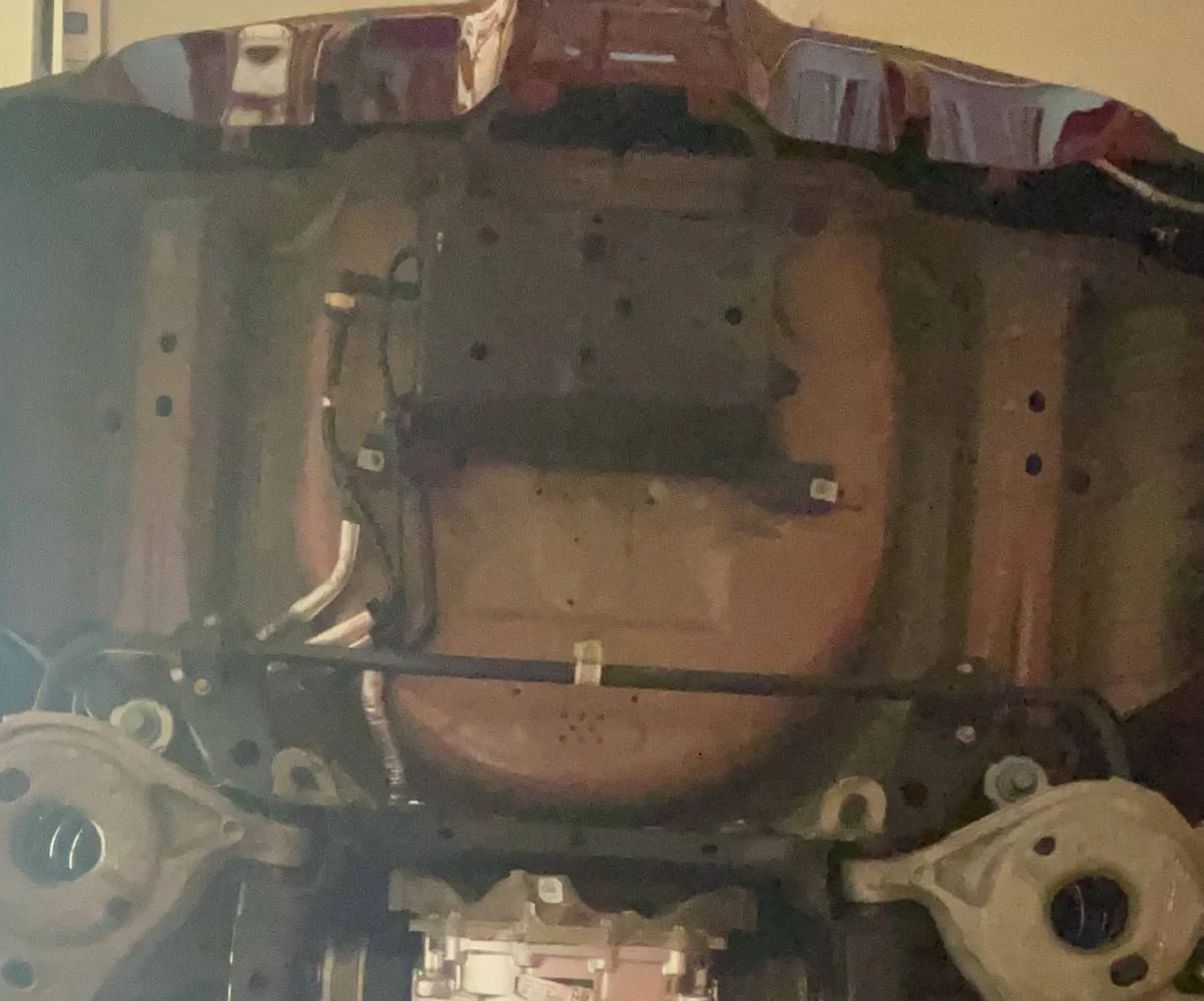

Before I could start the install I had to remove the factory Evap system then figure out how I wanted to mount the coolers.

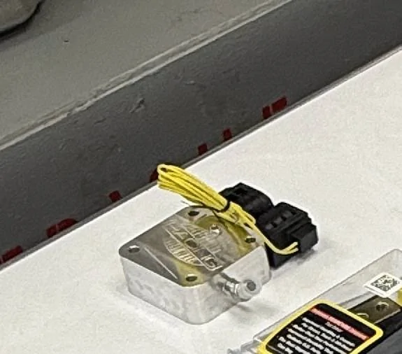

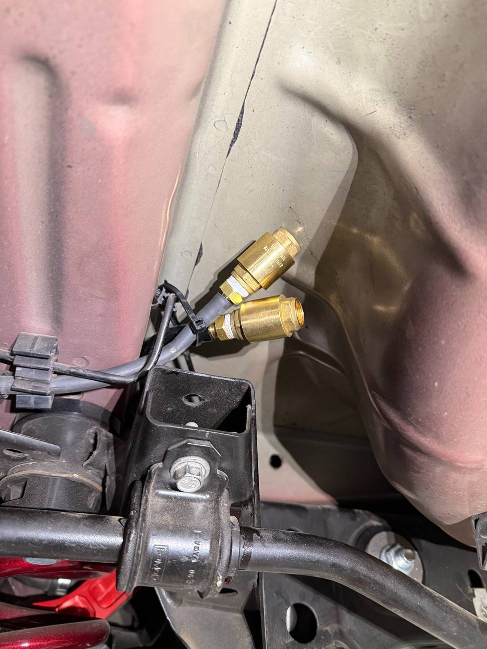

I cut the evap lines and unbolted the cannister, got two 3/8" brass one-way industrial check valves with a couple different sizes 3/8" barb fittings for the tank and neck vents. The factory had them connected with a hard Y but i wanted to tuck them out of the way.

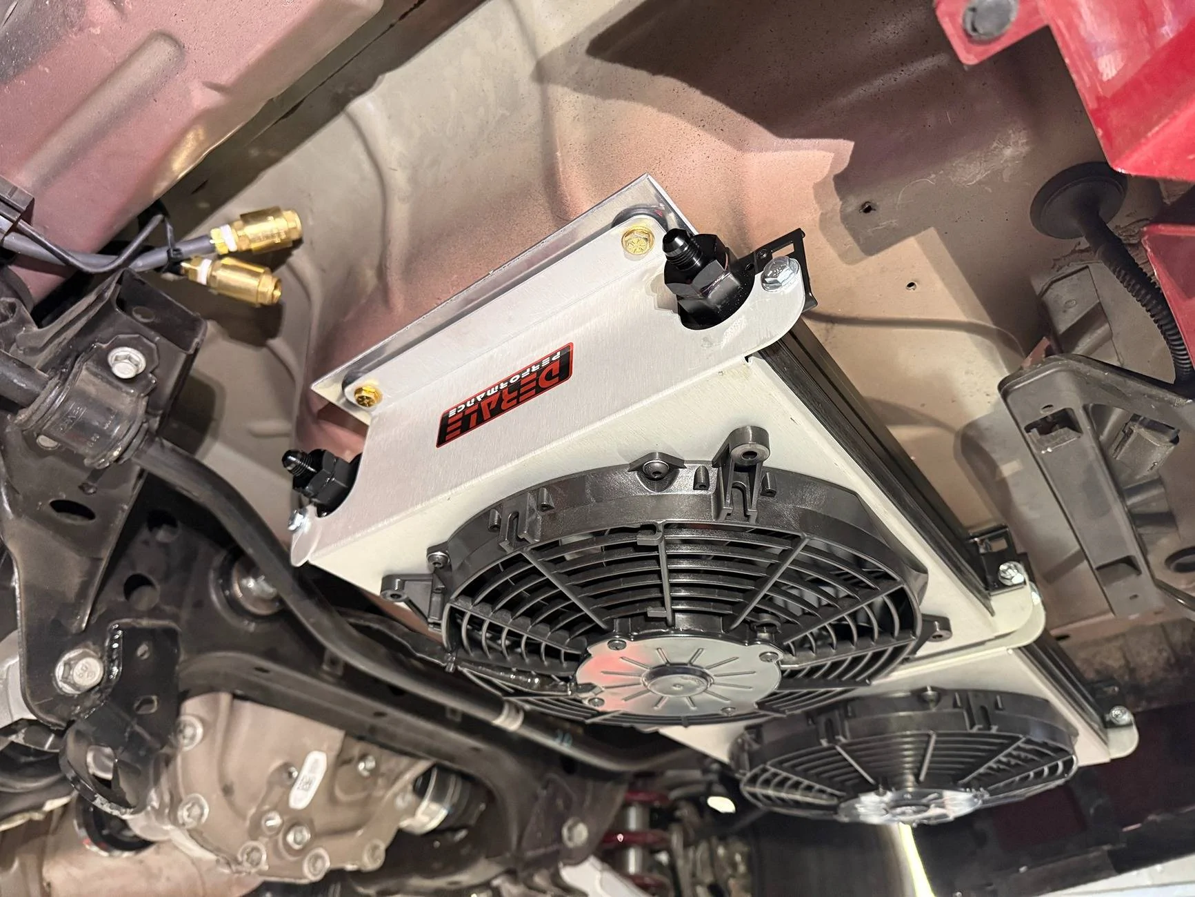

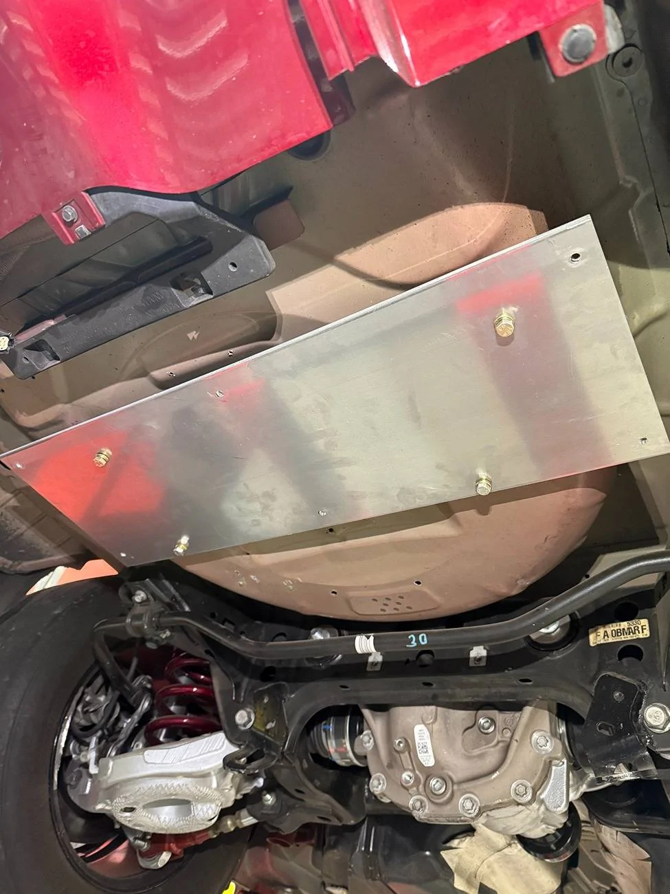

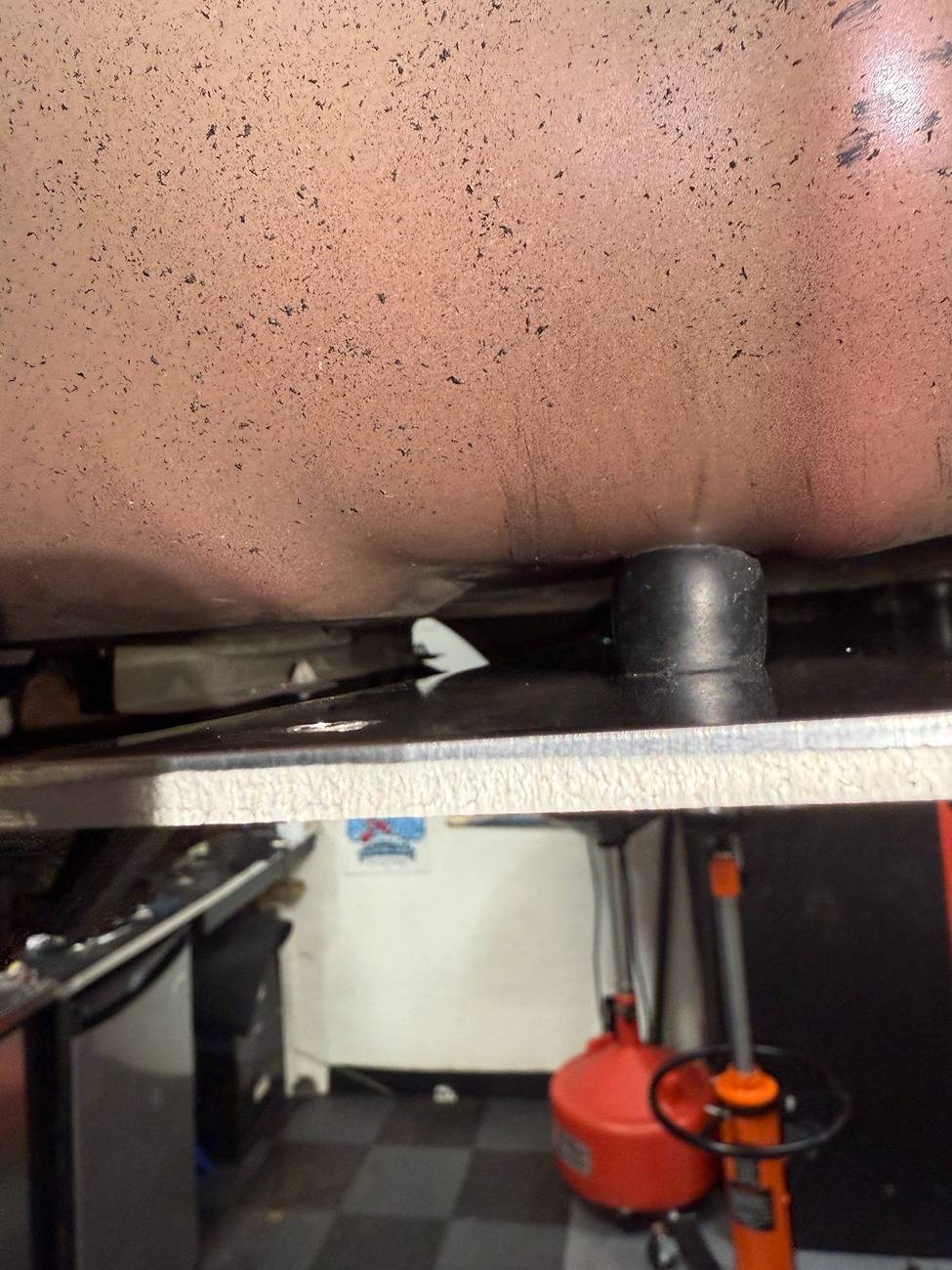

I went to a local fab shop and got them to cut me a 28.5x9.5" piece of 3/16" aluminum plate. I used 4 M8 rivetnuts in the spare tire well, used .5" rubber spacers to mount the plate where I wanted the coolers. Then mounted the coolers with more rubber spacers, now if I ever want to take a cooler off for any reason it simply pops right off without touching the mount.

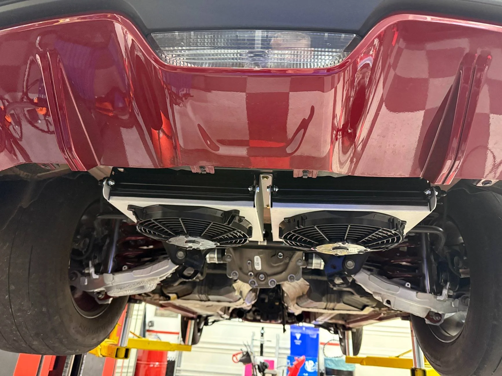

They tucked up very nicely out of the way, here it is from eye level:
I started plumbing and got the IN lines done to the Tee along with temperature switch, but waiting on my Racetronix order for more PTFE line an fittings for the OUT lines to the Tee. Also pressure testing all lines as I build them.

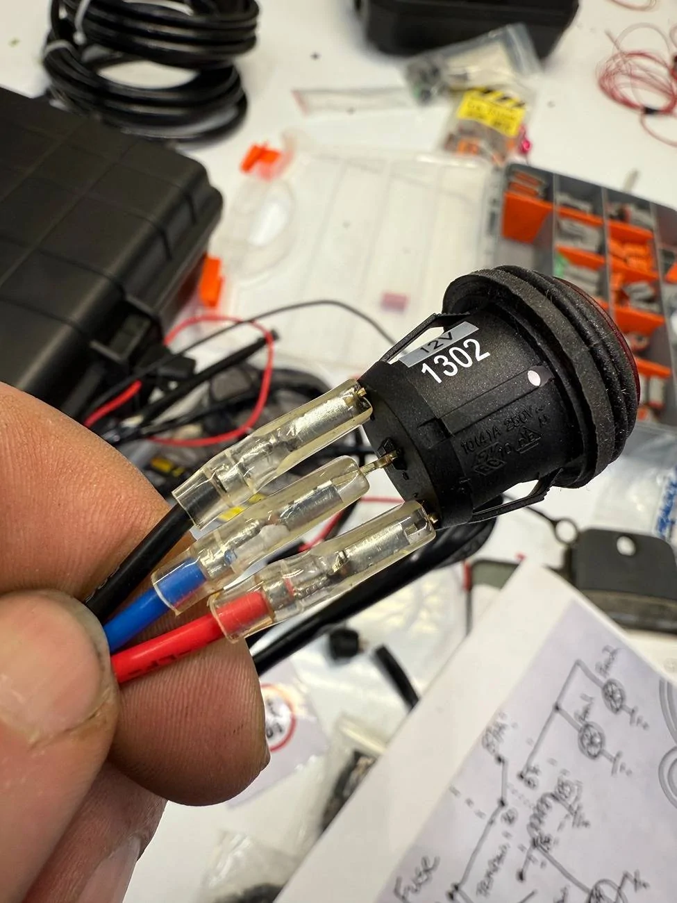

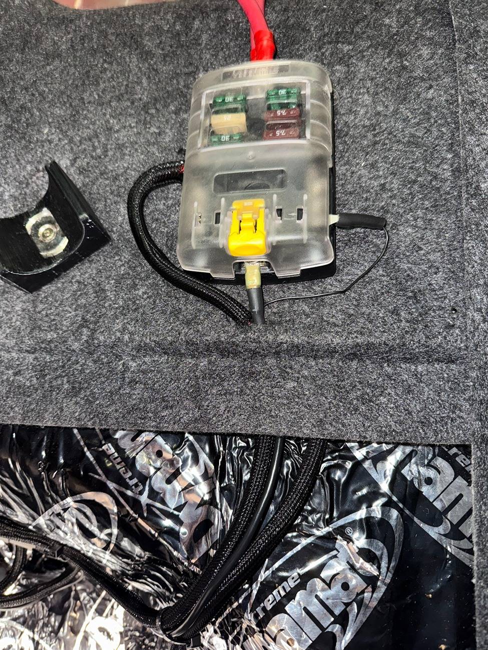

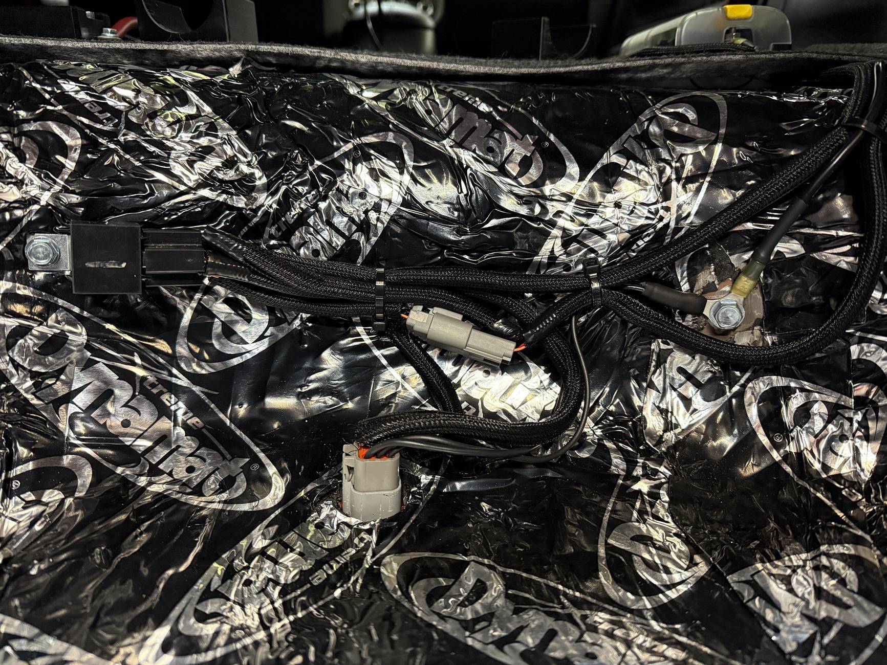

For the wiring as I said I wanted a switch that I could force the fans on and override the temperature switch as well as have an LED indicator. For that I built a relay which I'll post drawings of in the future.

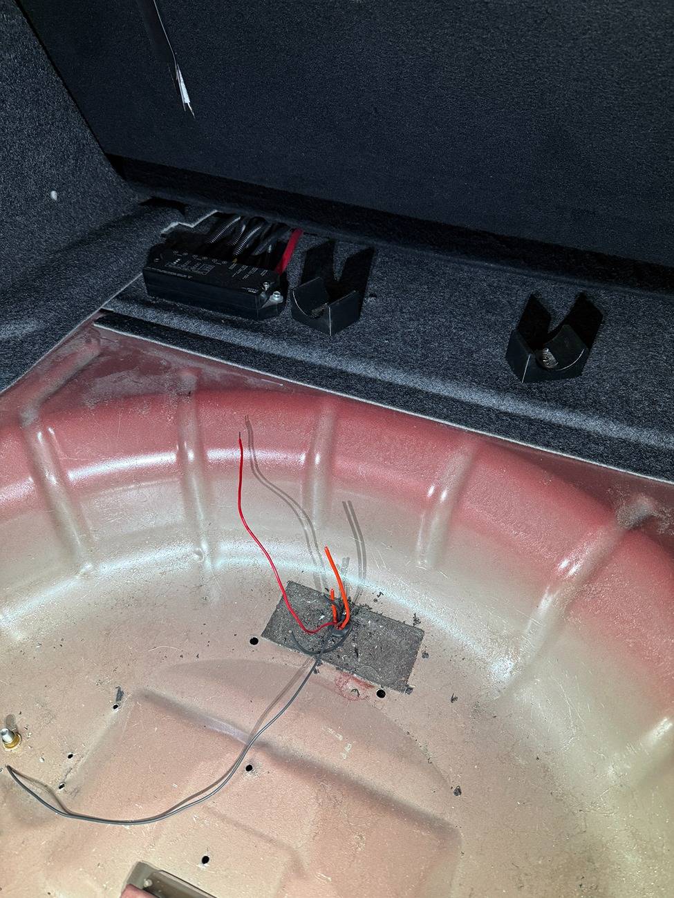

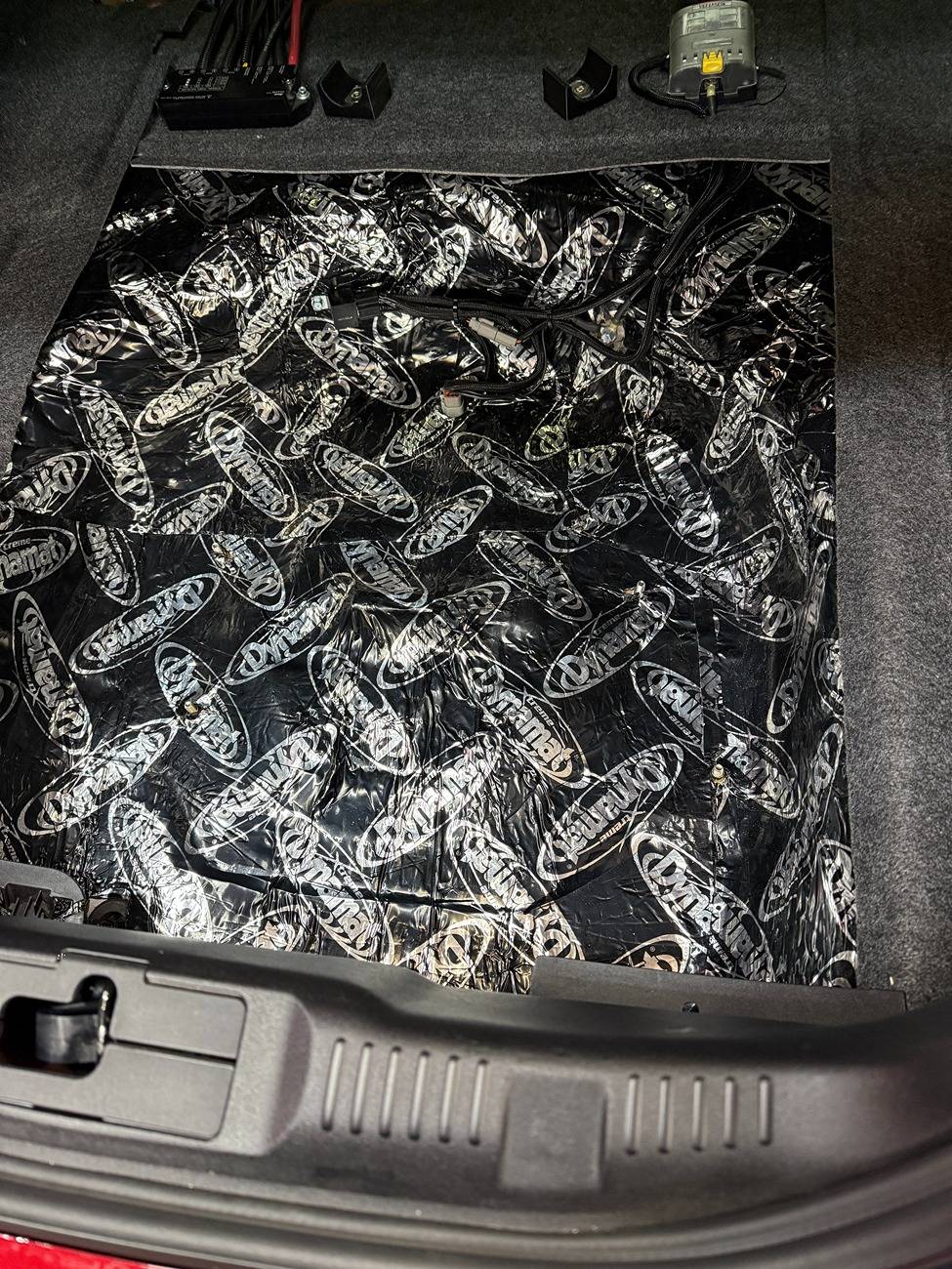

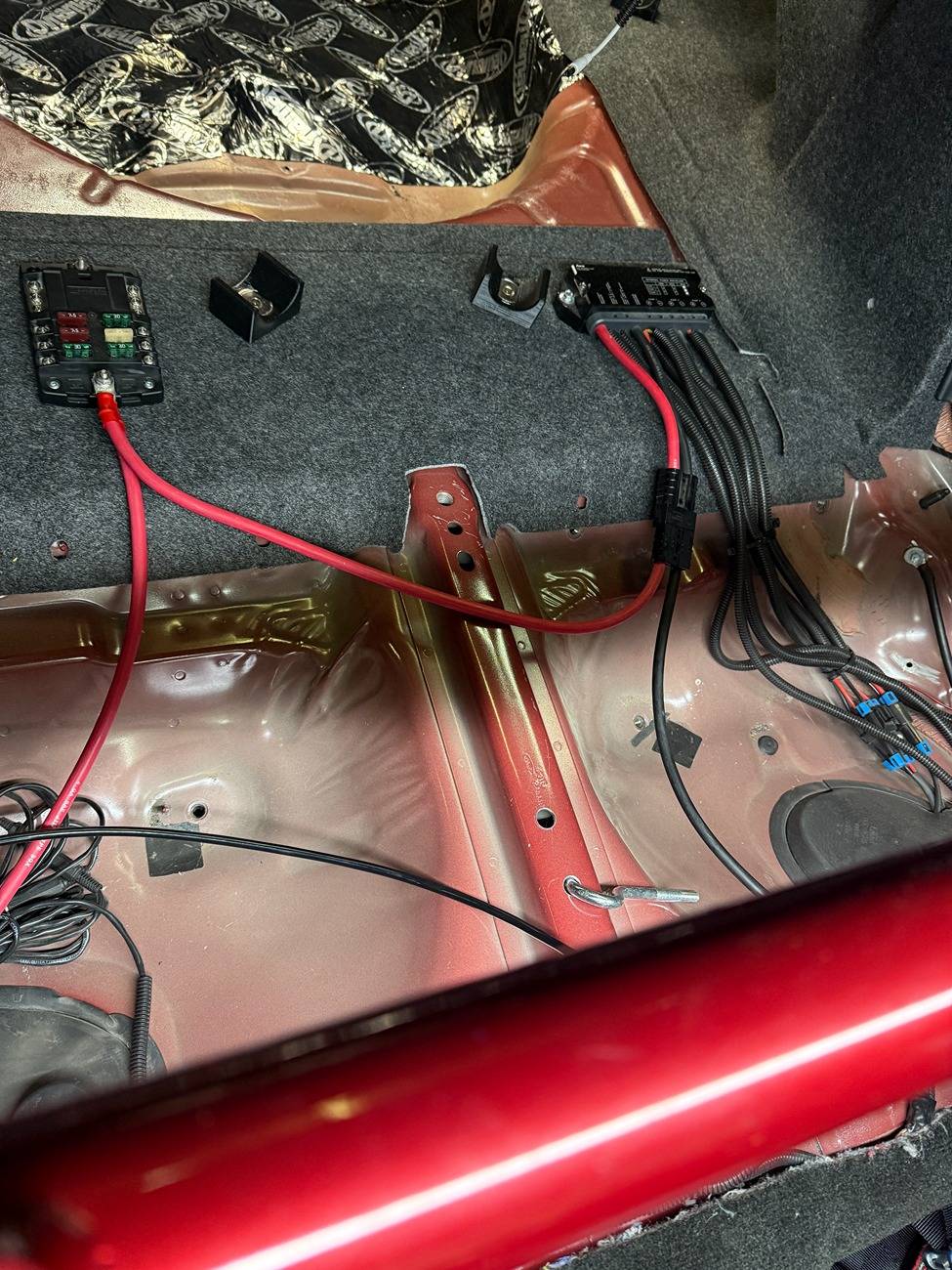

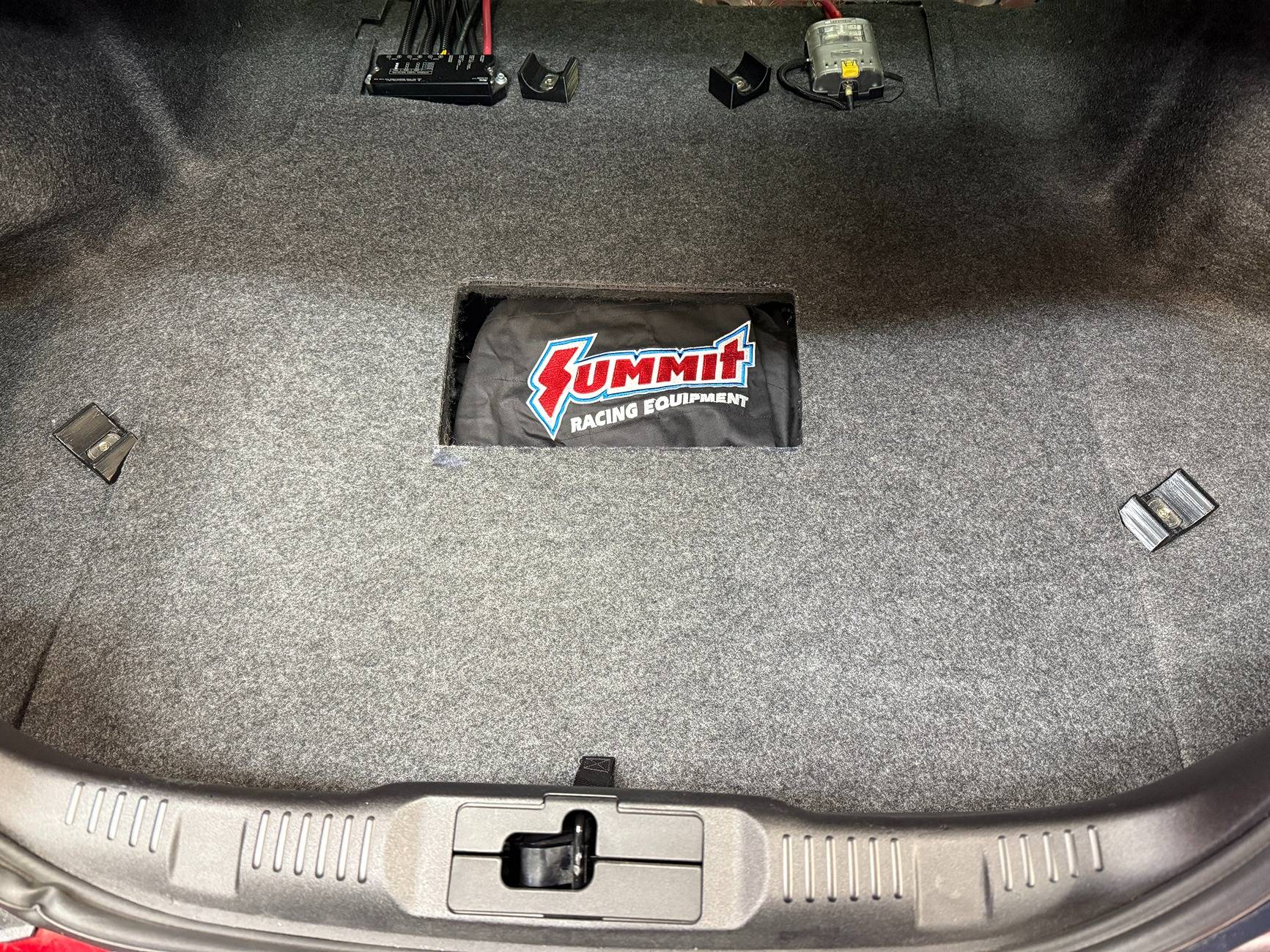

Since my Fore FR3 fuel pump controller was just behind my rear seat delete I figured that would be a perfect place to draw power from for the fans. In order to do that properly I added a power distribution box and cut my 4awg power wire before it gets to the fuel controller, then crimped on new terminals.
I then had old Dynamat Xtreme from my old terminator days so used that on the spare tire area, added like 1lb.

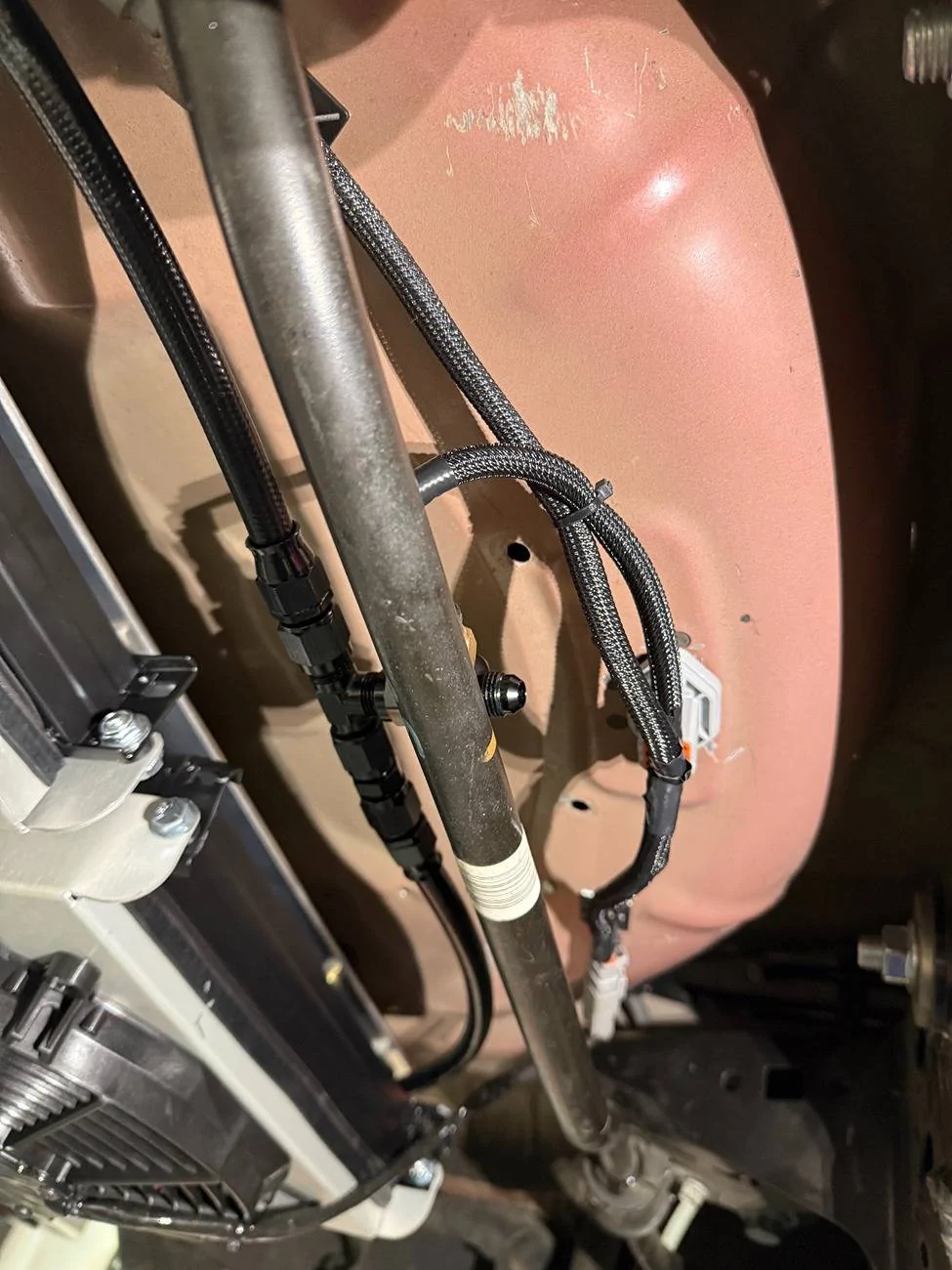

I used all Deutsch connectors as well as a 6-pin bulkhead connector for it to go through the floor. Now each fan has its own connector for easy removal underneath as well as the relay and wiring up top.
Finished product - The previous owner had an meth tank so when I'm on the street I use the opening to store my chute cable, race jacket, gloves, etc.
I'm happy so far with the turnout, there is so much more to go with this swap so stay tuned and I'll do my best to document it.
All the wiring is done from the trunk area, just plumbing to finish but that's for my next days off!
