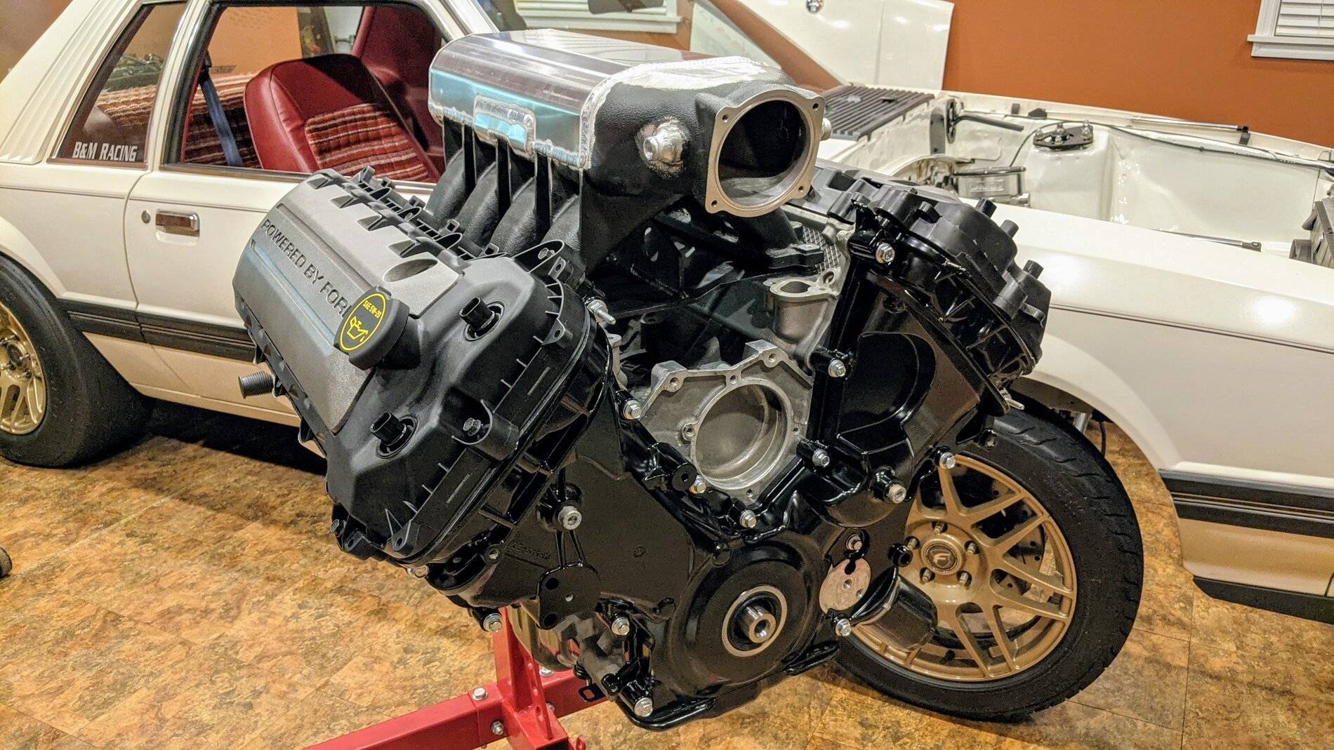

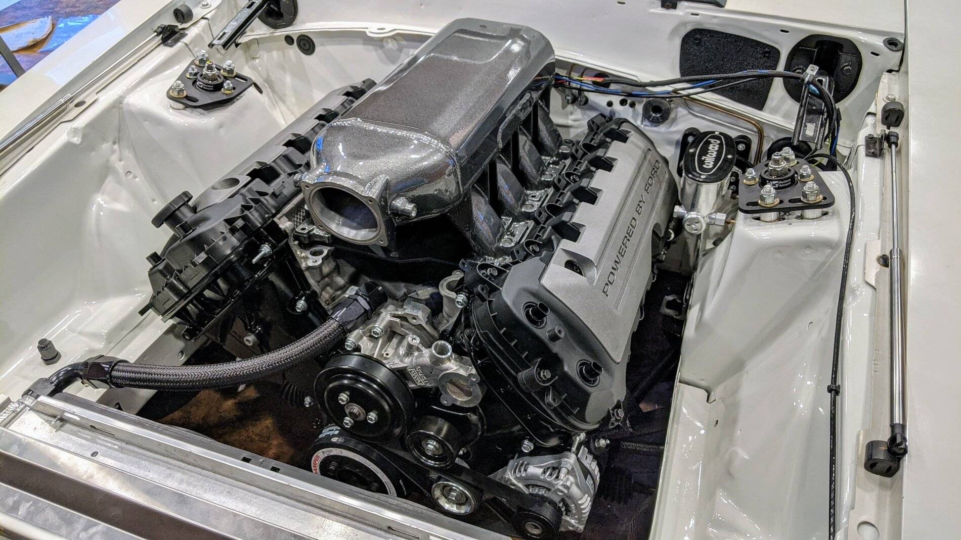

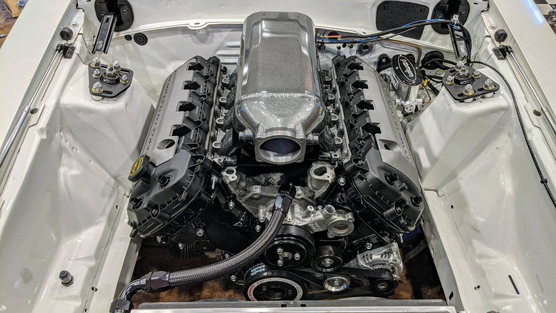

Induction anyone???
While this intake does look killer, it is for the 2016 car. Check out that thread for more info on the intake. The 2016 car has a ported 2018 intake that will be used on the fox coupe.

Is there anyway I can talk you into leaving it on there. It looks BA.
It will look the same on the 2016, just with a f1a94 haha. I think it's too much intake manifold for the coupe engine. The runners are fairly short and the cross section is large. I'm sure the efficiency range of this intake is really high in the RPM's. Mid-range performance may suffer. If this engine had ported heads, cams and more cubic inch that may be a different story.

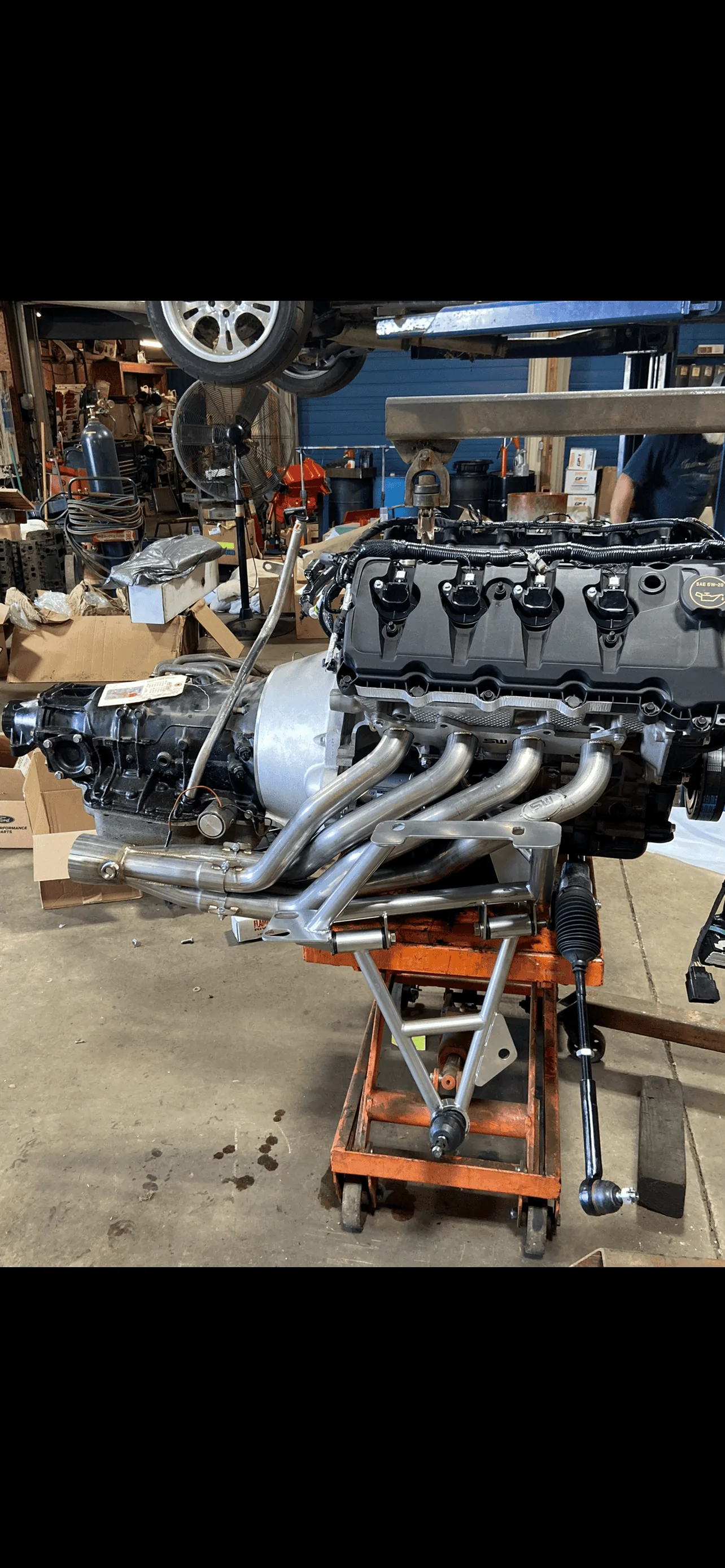

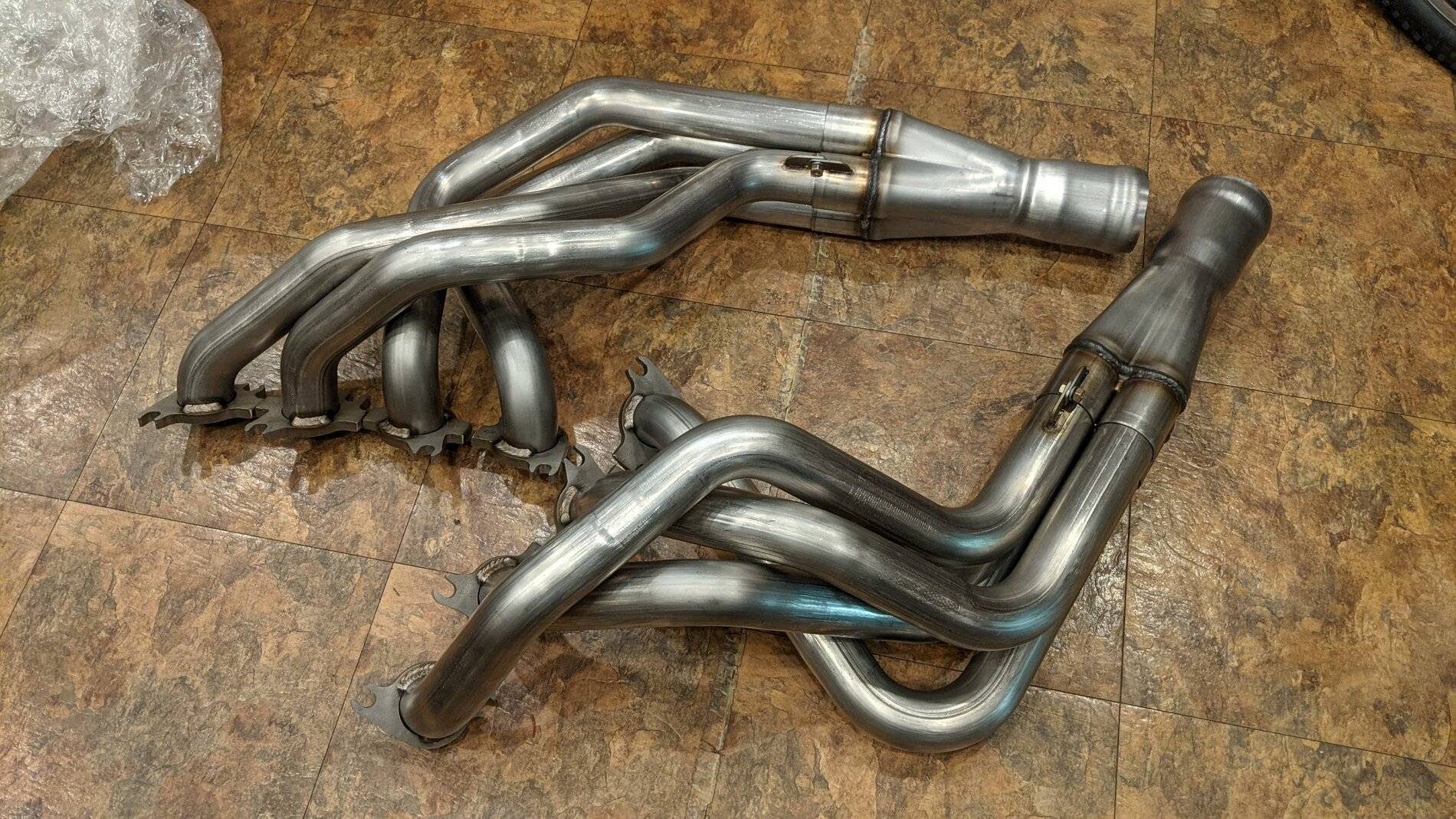

The Stainless Works headers are a work of art, but do not provide enough clearance for a clutch fork. Looking to get the ARH swap headers. Who has a good price on these???

Placed an order for ARH 1 7/8 coyote swap headers. Hopefully have them in a few weeks. In the meantime i wanted to get the engine in to get the control pack wired up. Im going to run this intake manifold on this car. It just looks right at home!

ARH headers in hand finally! Will be getting back on the horse soon.

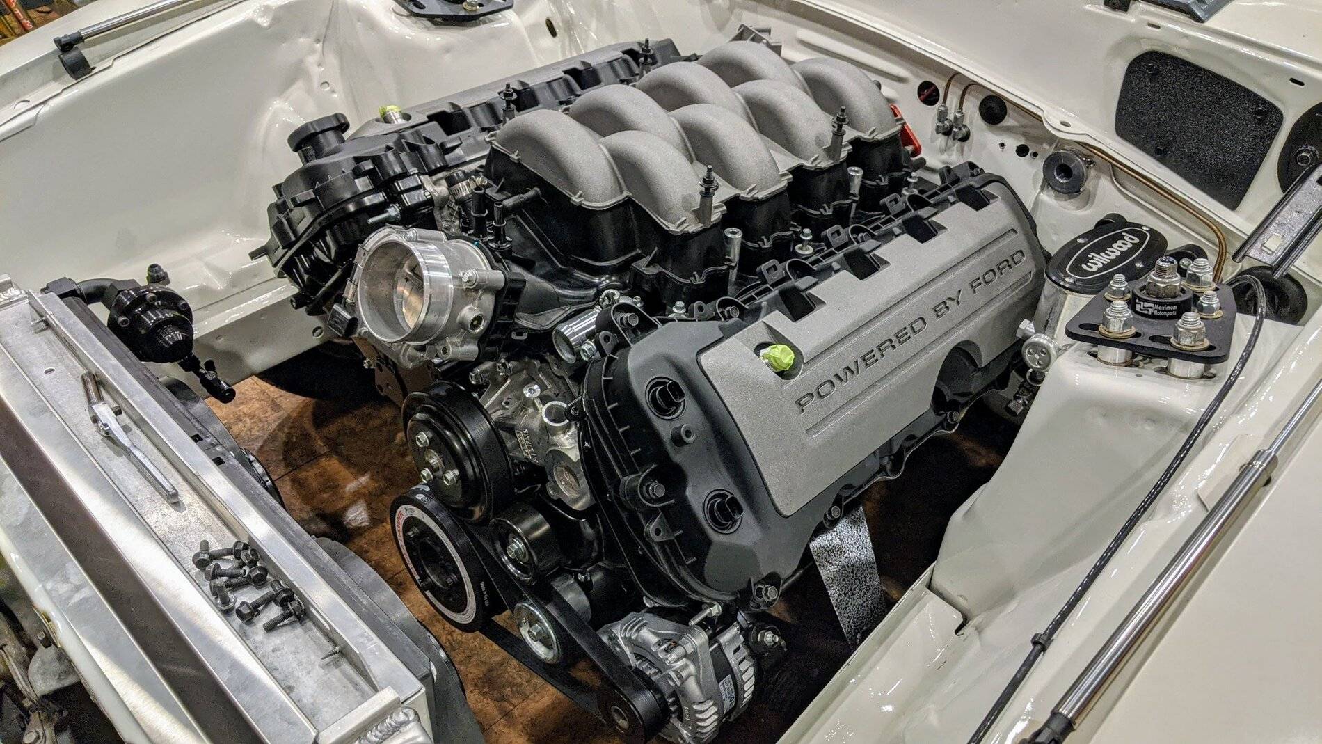

I took off the aluminum manifold and installed it on the 2016gt. Took the ported 2018 intake from that car and installed in the coupe. Not sure how i feel about it. I may sell the ported 18 and get a CJ...

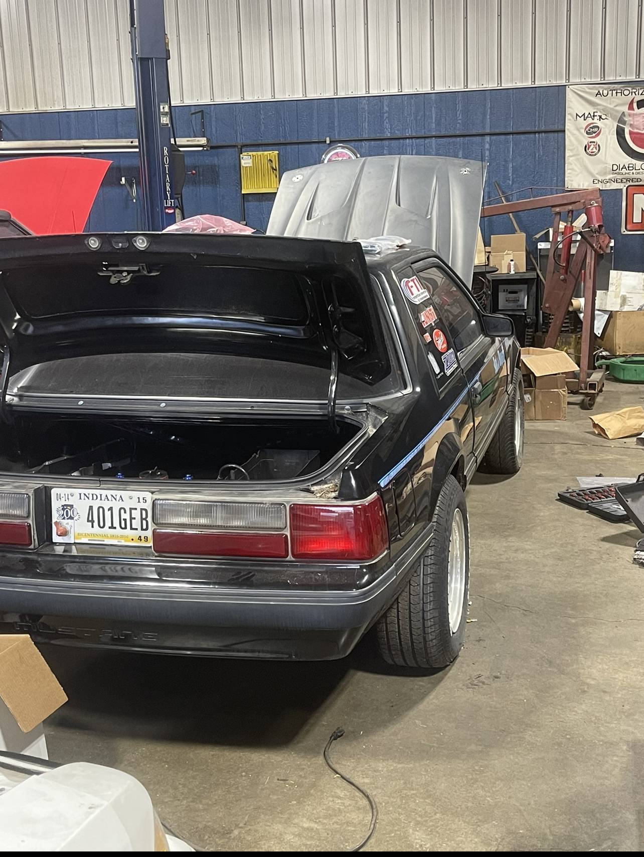

Long story and I will let Walter fill
in the blanks if he wants …. but it did get finished with a different power train .
I do have walters’s motor going in a different roller .
