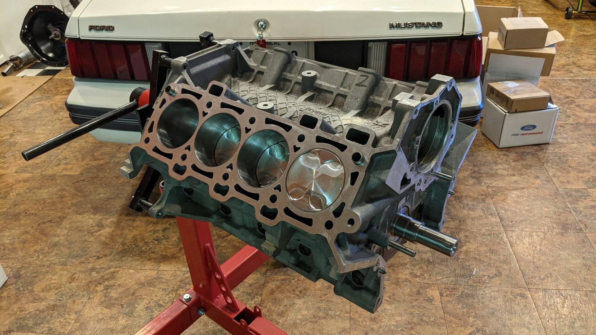

More parts arrived, boss alt kit, ford racing starter, gt350 cam phasers and and engine sensors. Plan to install heads tomorrow.

Did you install the heads ?
need pics !
need pics !
I didn't. Messed with those stupid predator coils on the other car. Then took that car to the track tonight and didn't do shit. Just blew the tires away. This track routinely does all that no prep shit so the track was garbage.

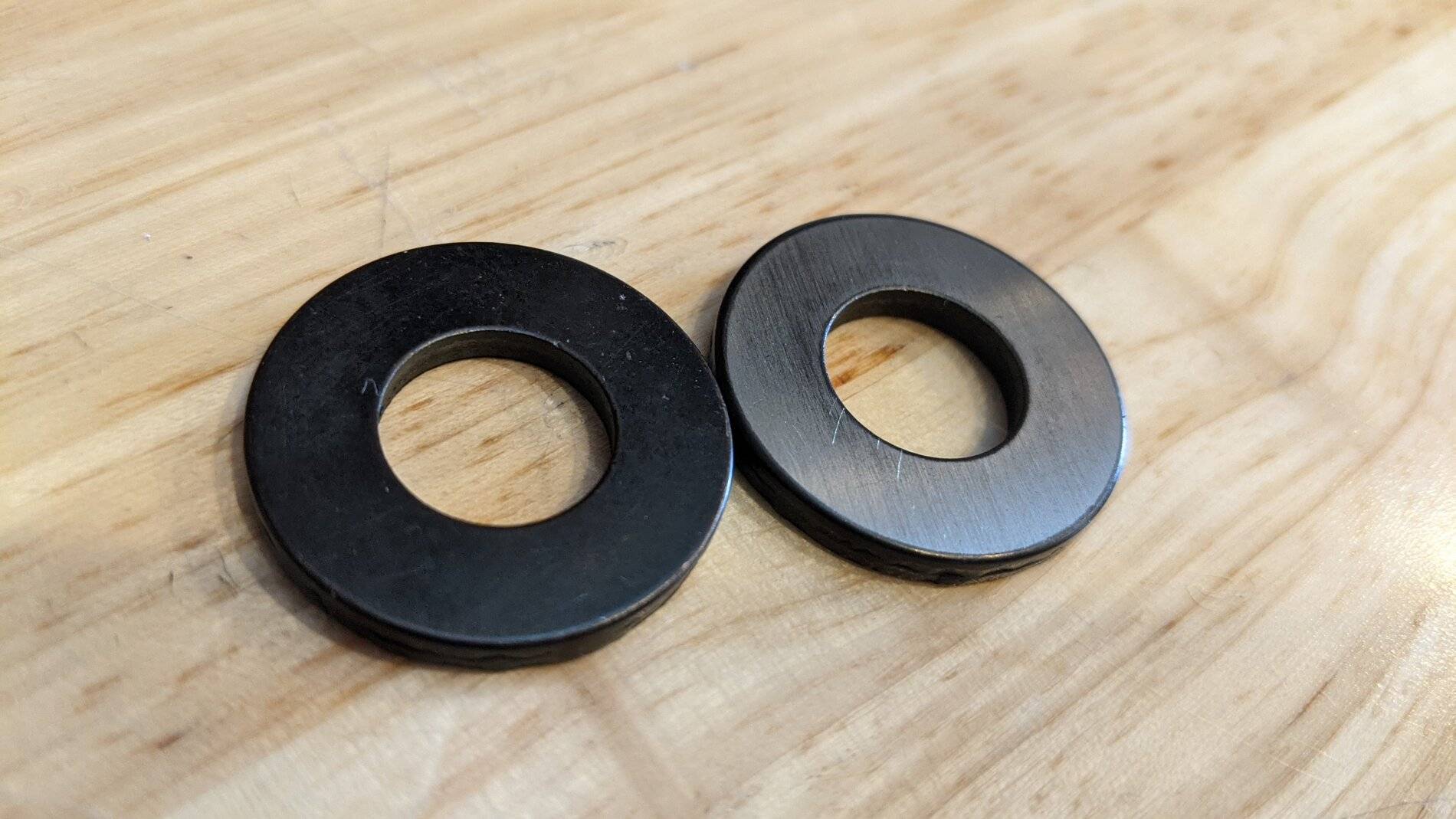

Got everything ready to put the heads on. First step is sand off the washer coating that will face the head. This is done to create friction between the head and the washer to ensure proper torque values. If the washer spins, you could torque the stud enough to snap it off. Bunch of articles out there if anyone want specifics. Anyhow, just run the washers over some 220 on the workbench.
