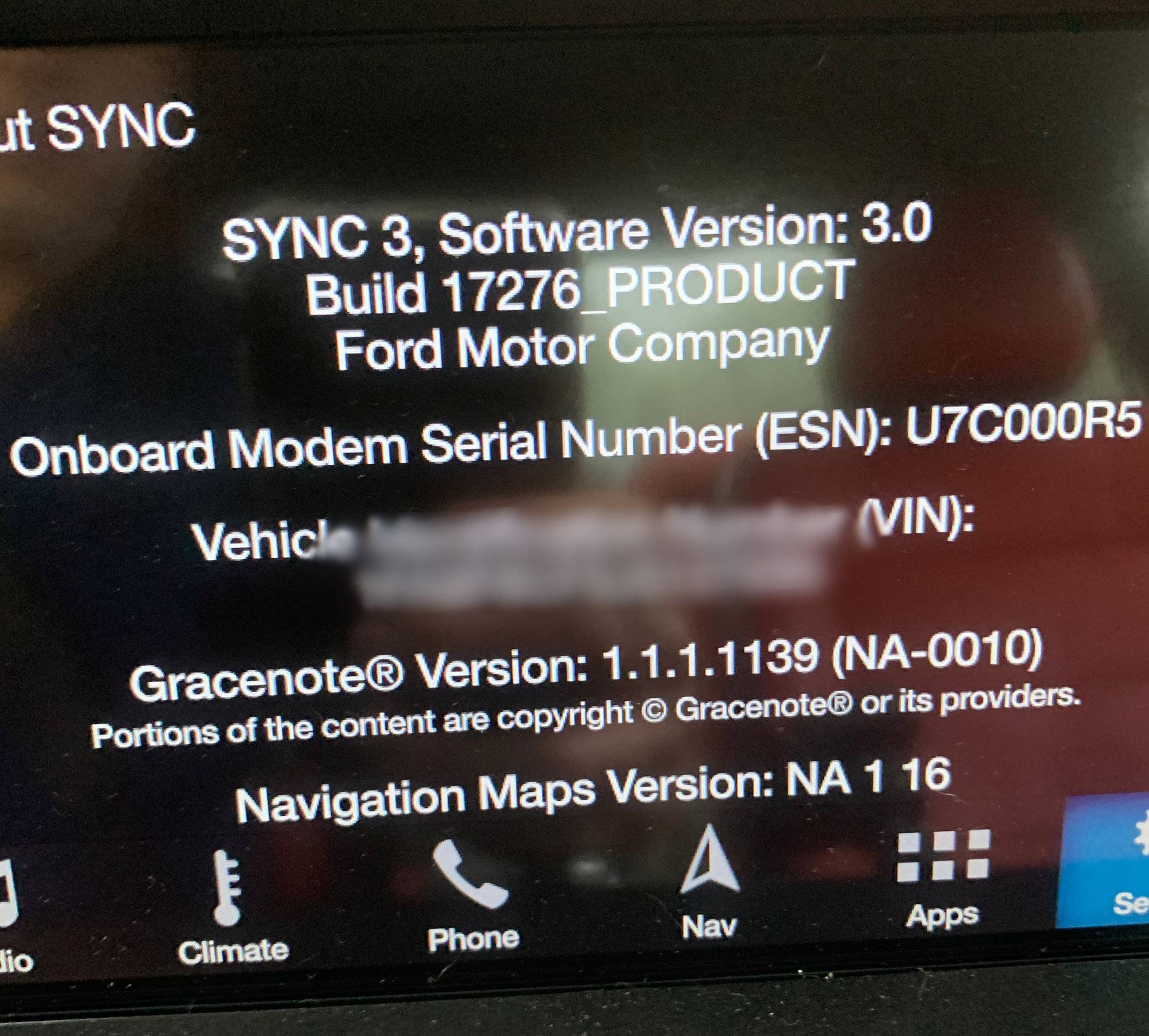

So this is interesting. I have heated and cooled seats but they do not appear on the second menu screen. Any ideas as to why?
I have Sync 3.4

So this is interesting. I have heated and cooled seats but they do not appear on the second menu screen. Any ideas as to why? I have Sync 3.4
It might have something to do with the setting to display the soft buttons on the home screen. Get on forscan and check APIM 7D0-01-01 xxxx xxxx x?xx The options are: Change ? To: 0-Disable (off), 1-Seat Cooling, 2-Seat Heating/Cooling, 3-Seat Heating, 4-Heated Steering Wheel, 6-All. I had 6 on 3.3 Did not make any changes after updating to 3.4. See what you have.
Thank you el. Didn’t even realize this was the Forscan thread. I do not use Forscan so I think I’ll just leave it as is. Honestly never use the soft buttons for climate so do not know what it looked like in 3.3.
