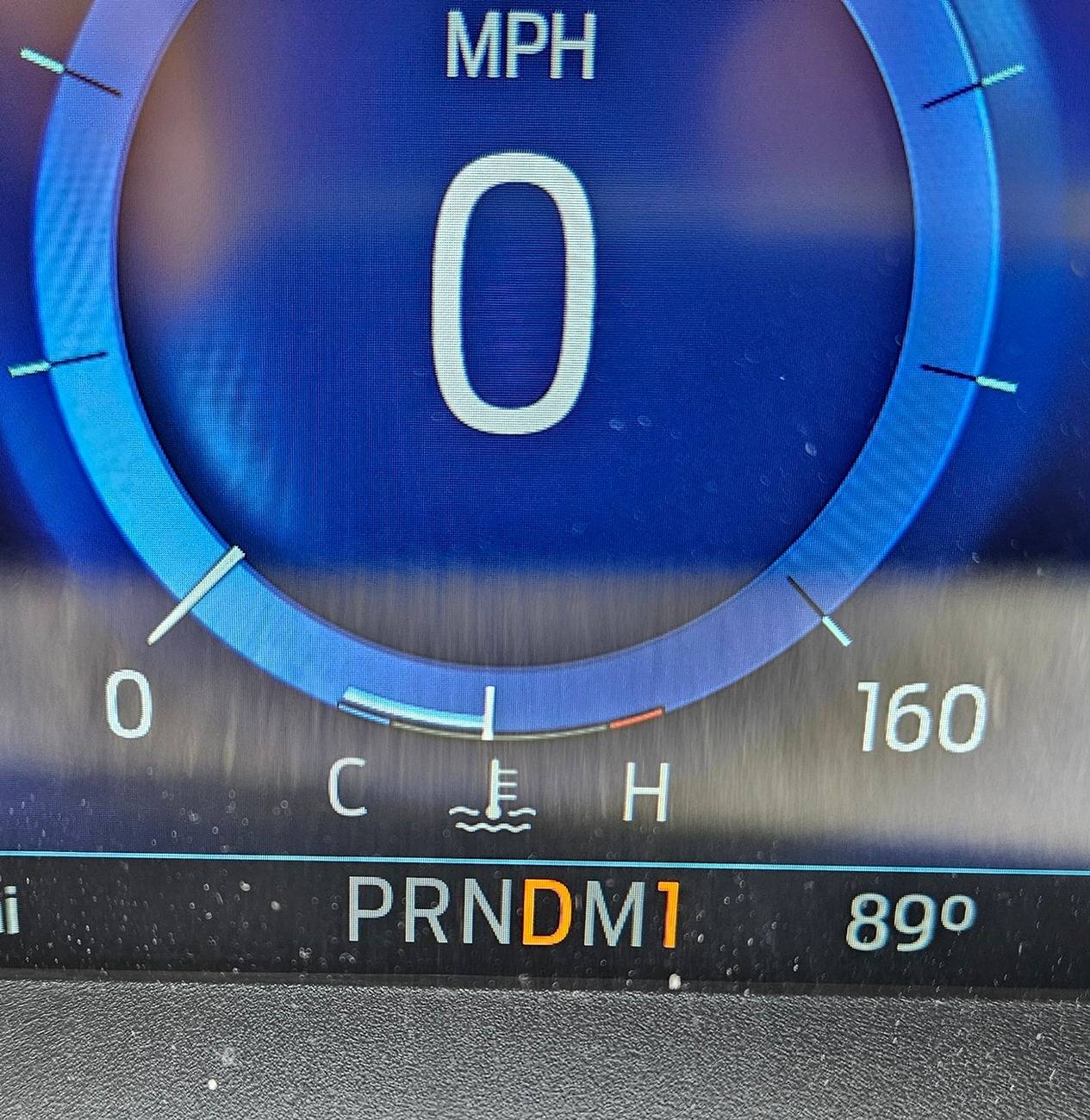

They do exactly that on the 2020+ explorers. Down at the bottom center of the screen where it has PRNDM you can get a gear display, 1 thru 10 in orange numbers. Talk to a tuner who does tunes for explorer ST's and see if they can do it for the mustang. I'll have to get a pic of it.
Notice that what ever gear your in is highlighted in orange and when your in drive or manual the number is also displayed right next to the PRNDM. With out the tweak in the tune, the orange numbers are not there.
