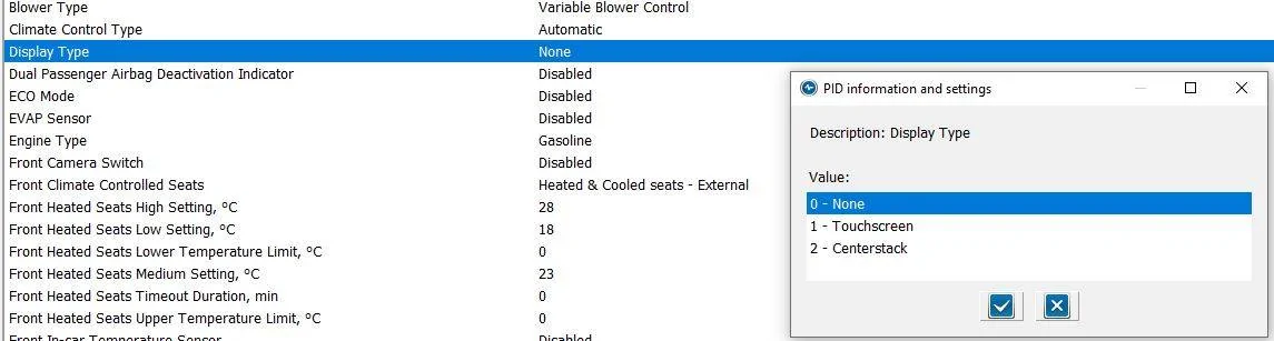

i only looked thru the non-as built configurations to see if there was anything relevant. second picture;fcim; i'm not sure why the display type is set to none ( i have touchscreen)
