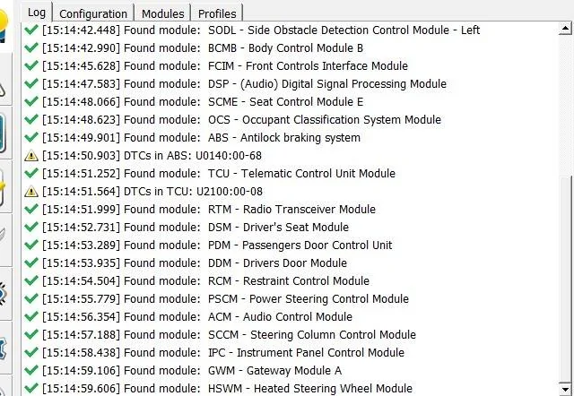

Finally got Forscan going and I'm slowly learning what everything is.
I checked for DTC's and there are none, everything shows ok, but noticed under log it shows DCT's in ABS and DCT's in TCU. Any idea what those mean? I assume since its in the log and there's nothing under DCT's its old?
Doesnt the TCU have something to do with navigation or the cloud?

U-codes are communication/configuration DTC's. Can't remember either off the top of my head, but a U0140 would be either lost communication with X module or invalid data received from X module (since no problems are occurring, probably a leftover historical DTC). I think the U2100 is an incorrect or not (properly) configured module, don't remember exactly. The TCU is the Telematics Control Unit, all it really does is send/receive data from the car to Ford's server's/FordPass (lock/unlock, remote start, oil life, fuel level, etc.).
Either way, if you're not having issues with anything, I wouldn't worry. It's pretty common to see some U-codes in modules that are historical.
