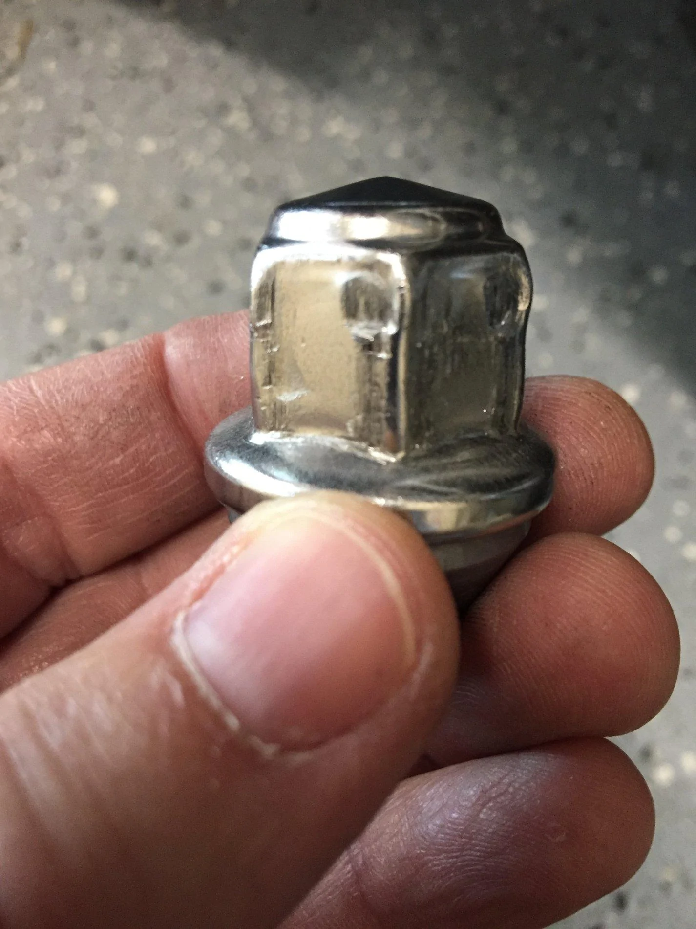

I've installed and uninstalled these more times than I can count.....each time, torqued to 150 ft lbs.
Has not failed or shown any signs of failure. No issues with these lug nuts.
Edit: Actually may need to replace them. The corners are rounding and get stuck in sockets as a result. Annoying but that's how much I've used them.....

I was at the dealership recently getting an oil change. The service adviser had a gimmick set up of a swollen lug nut and a socket showing folks why they needed a new set. Perhaps instead of showing the 3 customers in the waiting area the "problem" you'd push for Ford to fix it. Maybe?
In that vein, perhaps Mall of Georgia Ford needs to take RIBS's lug nut and set that up as a display in the employee break room as a reminder to do even the little details of the job correctly.
If anyone encounters a damaged lug nut and is under still under the Ford 3/36 Warranty - it should be replaced free of charge, period. Even if the Ford Service Center damages the lug upon R&R, it should be replaced.
Take pics of the wheels or lugs before the car gets serviced... this way IF the wheel or lugs get damaged during a visit, you have proof the car didn’t go into the bay with pre-existing damages.

To save your lug nuts from the damage you see on this thread, I would avoid using an impact gun to remove and recommend using a breaker bar and a good quality socket to loosen the nuts initially. The hammering of the impact gun, to break loose nuts torqued to 150ft/lbs, is what is probably deforming the ss covers. Good luck for those who take their car in for service and ask to have them broken loose by hand.
