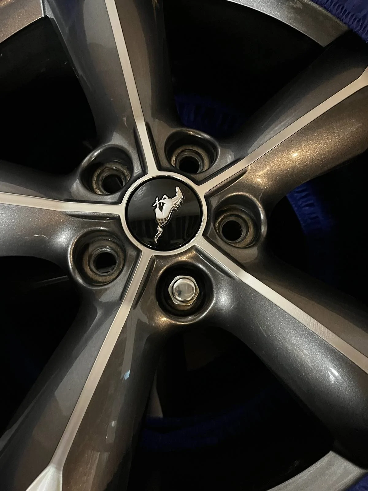

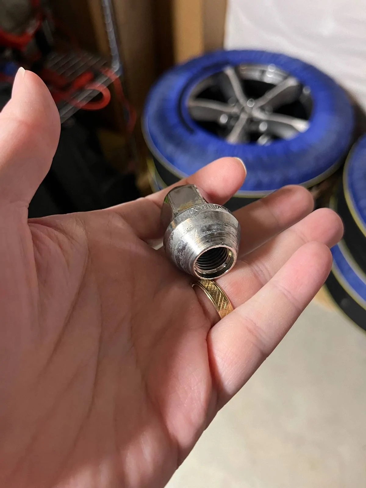

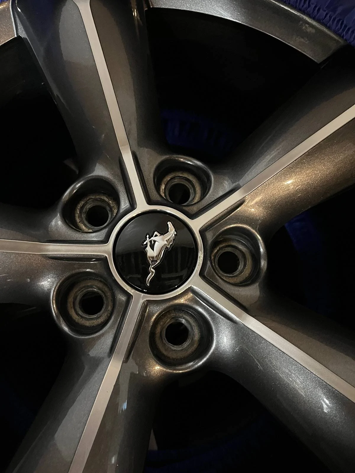

So, the cone of the lug nut (the end with the threads) should fit flush in the wheel. Easy to check with the wheel off the car, here’s my stock wheels (winter set) with the Gorilla factory-style lug nut. The acorn fills the seating area in the wheel and is perfectly flat against the wheel.

I use tuner nuts on my Ford daily wheels. Just because the OEM seat is larger doesn't mean the smaller tuner nuts won't work.
Obviously you couldn't use the OEM nuts on a tuner wheel.
