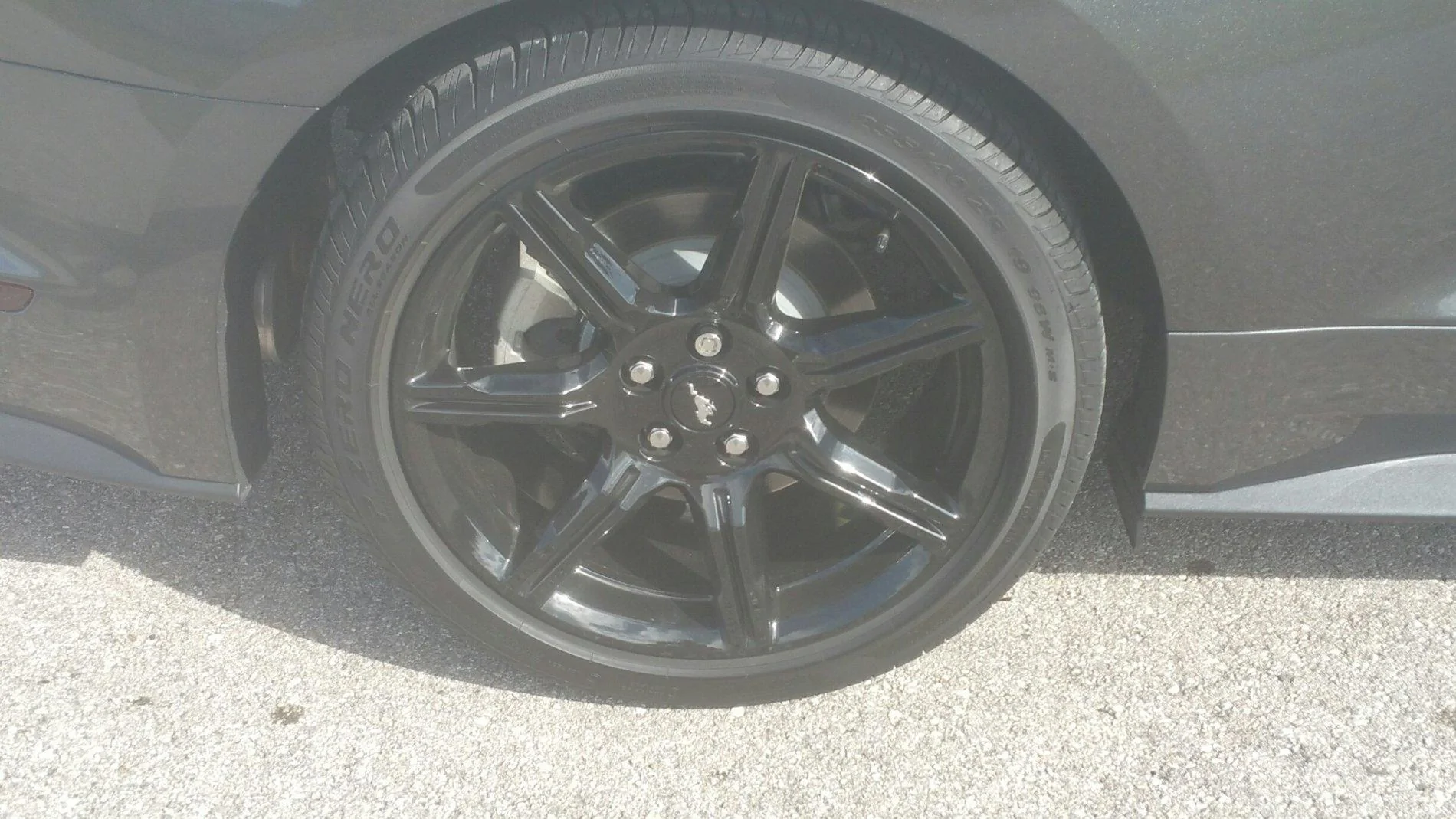

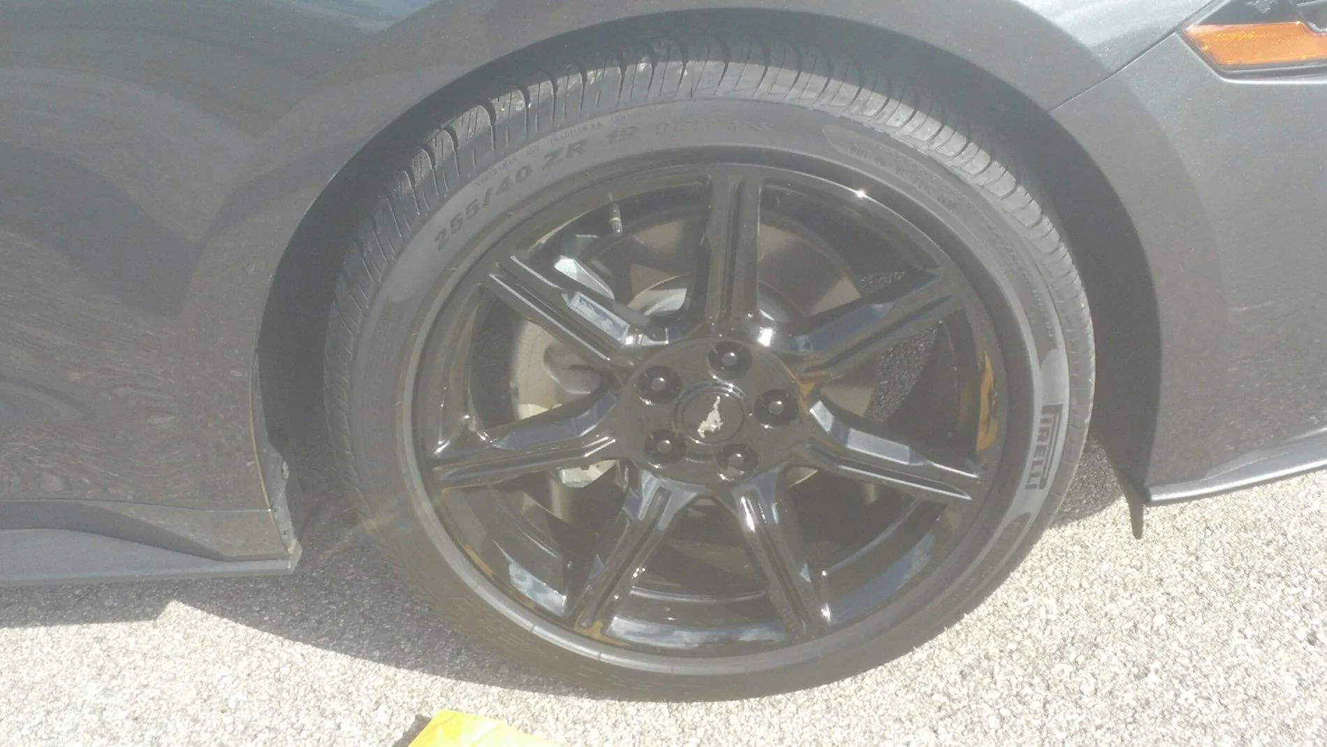

however, on our Mustang I followed 4 easy steps.
1) Remove factory lugnuts and throw away.
2) Install Gorilla lugnuts in black
3) Re-check torque after 50 and 150 miles
4) Never look back.
Before:
After:
