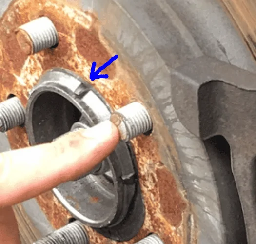

So, I re-listened to the voicemail, since I wasn't out to dinner.
Ford didn't blame the PP wheels, but the winter wheels, stating that the "Centric ring caused the damage, from friction, and was still left on." It literally sounds so made up, and doesn't make any sense. I'm going to call around to tire shops, and see what I can do about it. If nothing else, I know this is a 10 dollar in parts fix, and they've marked up labor considerably.

It sounds like you need to go in and have a rational (read: calm) discussion with them. I'm sure they would be happy to explain things for you so you're comfortable with the required repair. It actually sounds like they have already prepared to answer your potential questions since they said they have some photos for you. Maybe go in an hear them out versus going in for a fight?
It sounds like you're jumping to conclusions and working youself up. Only so much can be explained on a voicemail.
I mean you had already jumped to conclusions in another thread for the same topic that people were removing your lug nuts...

You can clearly see the crushed plastic hub centric ring stuck on the hub. Quite blaming Ford. Those are from your aftermarket wheels. You left them on and put the factory wheels back on at some point, thus not seating the wheel to the hub. This equals broken studs. Case closed.

I agree. Whomever did the swap back to summer tires/wheels overlooked the stuck centering ring. You really should check the other three wheels to make sure the rings are still in those wheels or better yet check the car itself and check the oem wheels to make sure no rings are stuck on the car or in the oem wheels. Be sure to torque the wheels to 150 lb-ft using a torque wrench.
FYI if you did the wheels swap don't feel bad since you don't have the background/experience to have "known any better". If a tire store did the work they have no excuse.

Also given how crashed the plastic looked at the bottom, the wheels never seated properly and probably thus putting extra force on the lugs when cornering.
I am amazed he didn't feel any horrible vibrations.
This ↑↑↑ . . . and I've been there too (with a Subaru dealership rotating aftermarket wheels as part of a normal periodic service). Somehow they ended up giving me two metal centering rings under the RR wheel (none on some other wheel). Ended up with three broken studs, same as in the picture, caught it just in time because there was no warning at all that something was about to go really wrong.

I needed a good laugh this morning! I saw the crushed spacer in the first pic and him claiming someone "stole" his lugs and was shocked how long it took someone to point out the ring.

This is a very simple mistake to make. Short story. I loaned a friend my skinny front runners. (Race Stars) well he call me after his night of racing. And says I'm going to need to hold on to your wheels. I'm like you liked them that much? He replys. NO I CANT GET MY STOCK WHEELS BACK ON NOW! I went to his house the next day and found that he forgot to remove the centering ring. Completely crushed it. And his stock wheels wouldn't mount flush. He felt pretty stupid when I pointed out the plastic ring!
