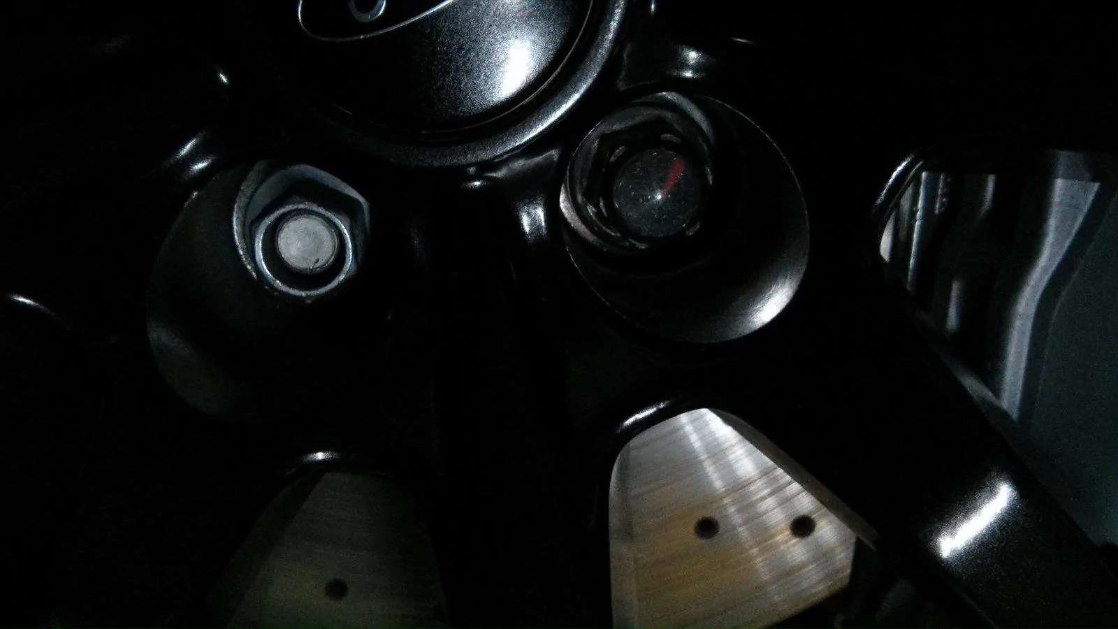

I just had this happen to me; the cap on the lug nut deformed and then started spinning. I was able to tear off the cap exposing the 'pot metal' nut below. question; what size socket is need to then remove this nut? It seems that the 21mm or 13/16" is a bit sloppy, I have not tried either yet, thought I'd ask first before wrenching....See attached image
