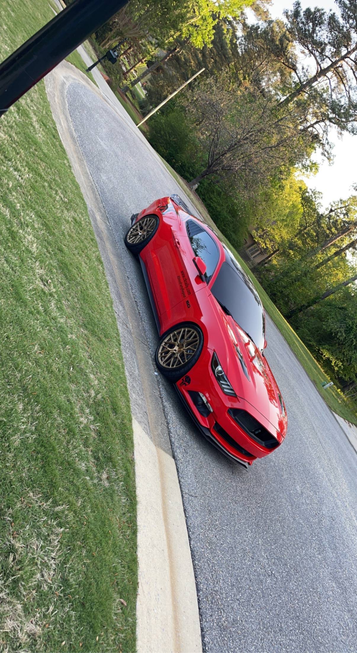

So I have a 2015 GT Premum. Just had the new dampening kit from eibach (shocks and struts) put on to go with the eibach sportline lowering springs. But a few weeks back after getting some tire work done I had the car re-aligned due to a very small and barely noticeable floating feeling and thought it was due to alignment. Went to Ford and they “aligned” the car and it drove worse than before. But in addition to the shocks, struts, and springs I have ford performance half shafts and rfx10 rims and nitro tires (rear: rim size 20x11 +48; tire: 305/30) (front: rim size 20x10.5 +38 tire: 285/30). So upon road check the car drives solid until the highway and then feels like it’s floating at high speeds. When doing the alignment they used the ford performance track pack specs to align the car and did not touch the camber or caster.
I feel if I can just find a better alignment shop to do the job right it would fix the issue, but was wondering if anyone has some input.
