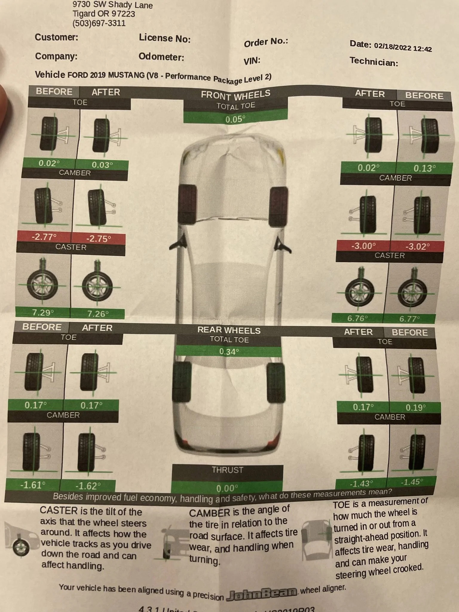

I’m getting another guy to take a look this morning but everything was set to track pack 2015 gt and he mentioned the front camber and caster are both off (red) because he did not mess with it.
I would find a dedicated alignment shop. If he only set the toe then he should have to change castor because when you mess with toe that changes castor also. So basically they did nothing but mess it up more.

Do you have the "after" alignment sheet specs they normally give to the customer? If you do maybe you can post it up so others can see/offer better advice.
It seems the alignment results could be the issue.
Did the car feel better before the alignment?
What brand tires?
If it does not have enough caster steering wheel will feel very light and floaty.

I did an alignment on my car (although probably poorly). If the car is lowered more than an inch you need camber bolts for the front.
If I remember right you can’t really adjust caster on these cars. It just is what it is.
What I would do is get some camber bolts. Find another dealership or a shop that mainly focuses on alignments, give them the camber bolts and have them install them and align the car properly. Then have them give you the printout so you can post it here. I would just tell them to align it to factory specs or if you want to look up some track or drag spec a reputable place has suggested.

You definitely need camber plates, or camber bolts to get that front back to where it needs to be. That's more negative camber than a lot of guys who road race their cars use.
