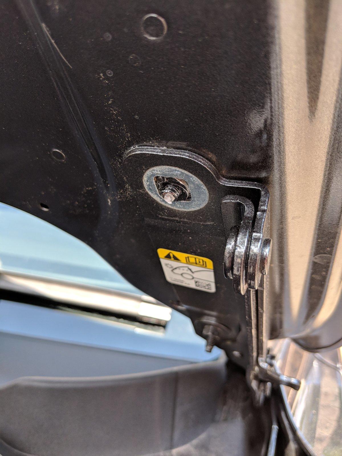

I wish I spotted this thread earlier. Exactly the same kit, exactly the same torque set on my (brand new wrench).... exactly the same outcome. Stud has snapped on the top right (UK RHD passenger side). Really really pissed off :( I literally just picked the car up a few days ago :(
Just to clarify... the fix is to remove the sheared stud and then cold-weld a new stud in? The stud, for me, sheared just under the bolt.
What a crappy design!

It's a good enough design for the job Ford intended them to do. Just maybe there wasn't enough margin built into it for the average DIY'er to work with at a later date. It's possible that these small bolts are inadvertently being placed in bending as well as torsion during both the loosening/removal and installing/tightening phases of this task.

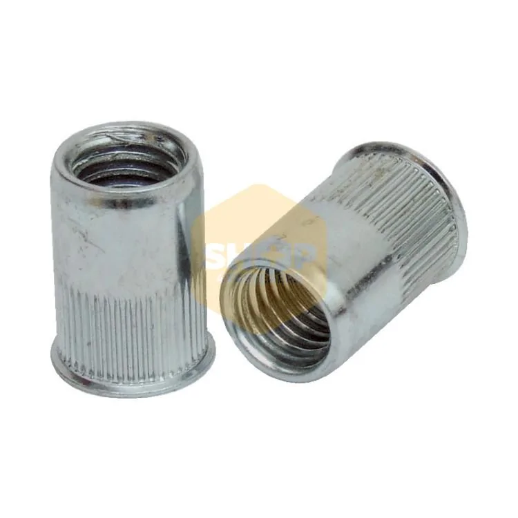

I just spoke with a friend of mine who owns a welding/metal working business and he believes the best fix is to drill the stud out and insert a press fit threaded insert like the following...
Would you guys potentially recommend away from this approach? Is cold weld a better solution? He didn't seem to like that idea and said it wouldn't be very durable.
He hasn't actually seen the issue yet, I've just described it to him. I'm taking it down tomorrow for him to take a look.

I spoke to a friend who has a welding shop and he's going to take a look at it tomorrow. I think he's thinking of press fitting a pre tapped steel sleeve, after removing the existing stud. He said metal epoxy wouldn't be a great solution. He may change his mind after he insepects it, who knows. He said he'll charge me ÂŁ30 give or take.
