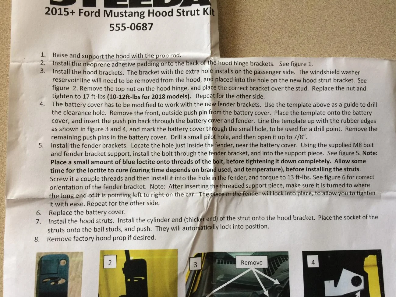

Just installed my Steeda hood strut kit. You may have been relying on youtube videos which all say 17 ft-lbs., but the instructions (see below) actually show 10-12 ft-lbs. for 2018 models. Since you had a faulty torque wrench, it may not have mattered. I decided to just hand tighten with a little blue loctite. As far as your missing bracket, I was a dumbass and dropped not one, but two screwdrivers down into the black hole of death. I was trying to use them to position and keep the fender bracket support crossways while tightening it. All you have to do is remove the three push pins in the bottom of the backside wheel well liner. Then you can pull the liner out far enough to reach up in there and get it out.
CAUTION: For anyone installing a hood strut kit on a 2018 model, most youtube videos say to tighten the hood bracket nut to 17 ft-lbs. The correct torque is 10-12 ft-lbs.
Thanks, my paper instructions didn't have the bolded 10-12 ft-lbs for 2018 line.
You may not have been the first to snap a bolt then since it seems they've had to update the installation procedures. Hope it works out to be an easy inexpensive fix with the dealer. Honestly, I'm really surprised a heavy ass hood is mounted with four bolts that small. Ford should have just put the damn hood struts on at the factory.
