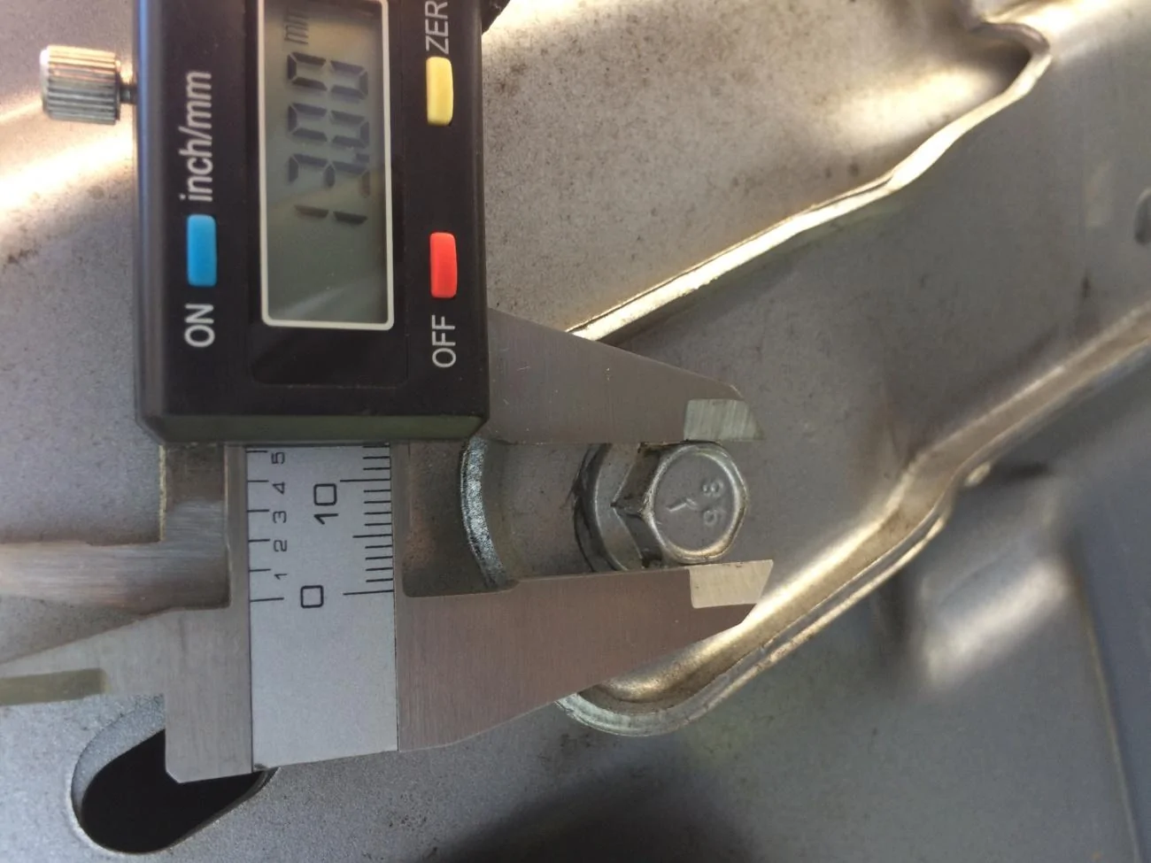

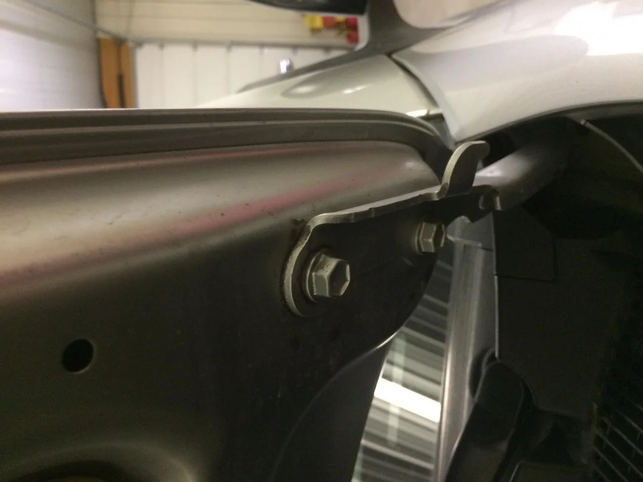

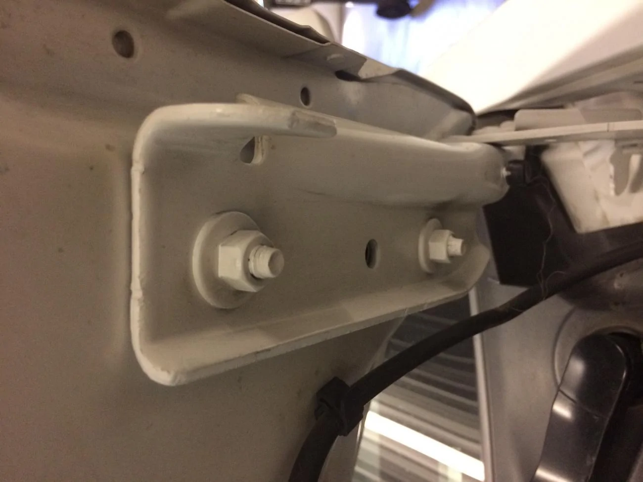

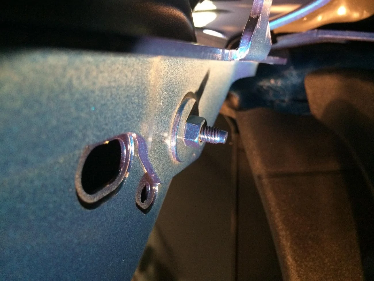

IMO, a 10mm bolt/stud is not big enough to properly support a hood. I checked a 2011 Camaro, 2017 Highlander, 2005 4Runner, 2003 Monte Carlo, and 2011 Tacoma. Everyone of those vehicles use a 13mm bolt/stud to support the hood. This is squarely on Ford.
2011 Camaro
All three Toyotas were the same (this is the 2005 4Runner)
2003 Monte Carlo
2018 Mustang

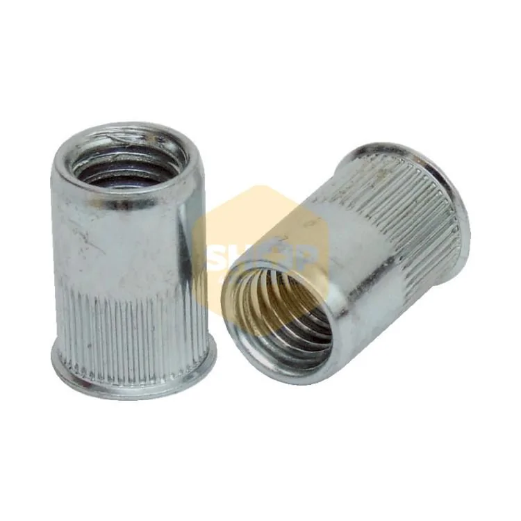

I just spoke with a friend of mine who owns a welding/metal working business and he believes the best fix is to drill the stud out and insert a press fit threaded insert like the following...
Would you guys potentially recommend away from this approach? Is cold weld a better solution? He didn't seem to like that idea and said it wouldn't be very durable.
He hasn't actually seen the issue yet, I've just described it to him. I'm taking it down tomorrow for him to take a look.
I think the term for those parts is “nutserts” and can be found on McMaster Carr website for misc hardware.
https://www.mcmaster.com
Home Depot supposedly has them via googling too, but not sure of proper size.
Can't go by the hex head size. Need to go by the diameter of the threaded portion of the stud or bolt. The torque a fastener can take is also dependent of the quality of the steel. Could be the steel used isn't as good as Ford thinks it is.

I spoke to a friend who has a welding shop and he's going to take a look at it tomorrow. I think he's thinking of press fitting a pre tapped steel sleeve, after removing the existing stud. He said metal epoxy wouldn't be a great solution. He may change his mind after he insepects it, who knows. He said he'll charge me ÂŁ30 give or take.
You need a decent depth hole to use those press in sleeves. I doubt there is anything more than some thin sheet metal on the hood to work with where the studs are located. It might work if there's enough sheet metal thickness. Might use some epoxy or JB Weld also to help secure the sleeve.
The size (width) of the threads is pretty standard with the size of the head. Compare the thread size then on the Camaro to the Mustang. The pics really don't even show the actual size difference between the two. Sure, metallurgy can definitely make a difference here, but the studs on the Mustang obviously aren't hardened enough to make a difference. The studs are too f***ing small! Period!
That's what concerns me, but we'll see for sure later on... maybe there's some magical slimline version he works with. Either way, I have some quiksteel arriving today from Amazon (JB Weld is a little harder to get hold of over here, but quicksteel is pretty much the same thing).
I took this a little further . . . a 13mm head belongs with M8 threads, and a 10mm head is what an M6 bolt gets.
From there, a Grade 10.9 M6 fastener torque is listed at 17 Nm, which corresponds to 12.5 ft*lbs.
I'm betting on there being a units confusion somewhere along the line.
FWIW, a 3mm fastener probably would be strong enough - under pure tensile loading. But add much of any bending during installation (from any cause, including angular mismatch between the parts being fastened together), quite possibly not. It's not like you're going to be sitting down at a workbench to tighten a hood attachment fastener.
