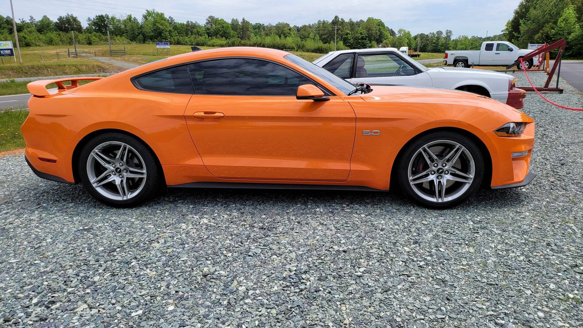

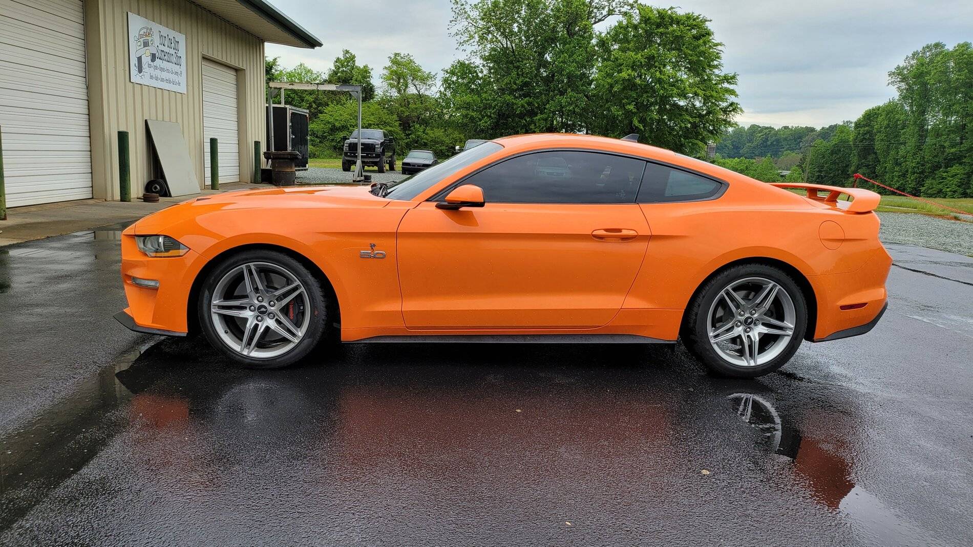

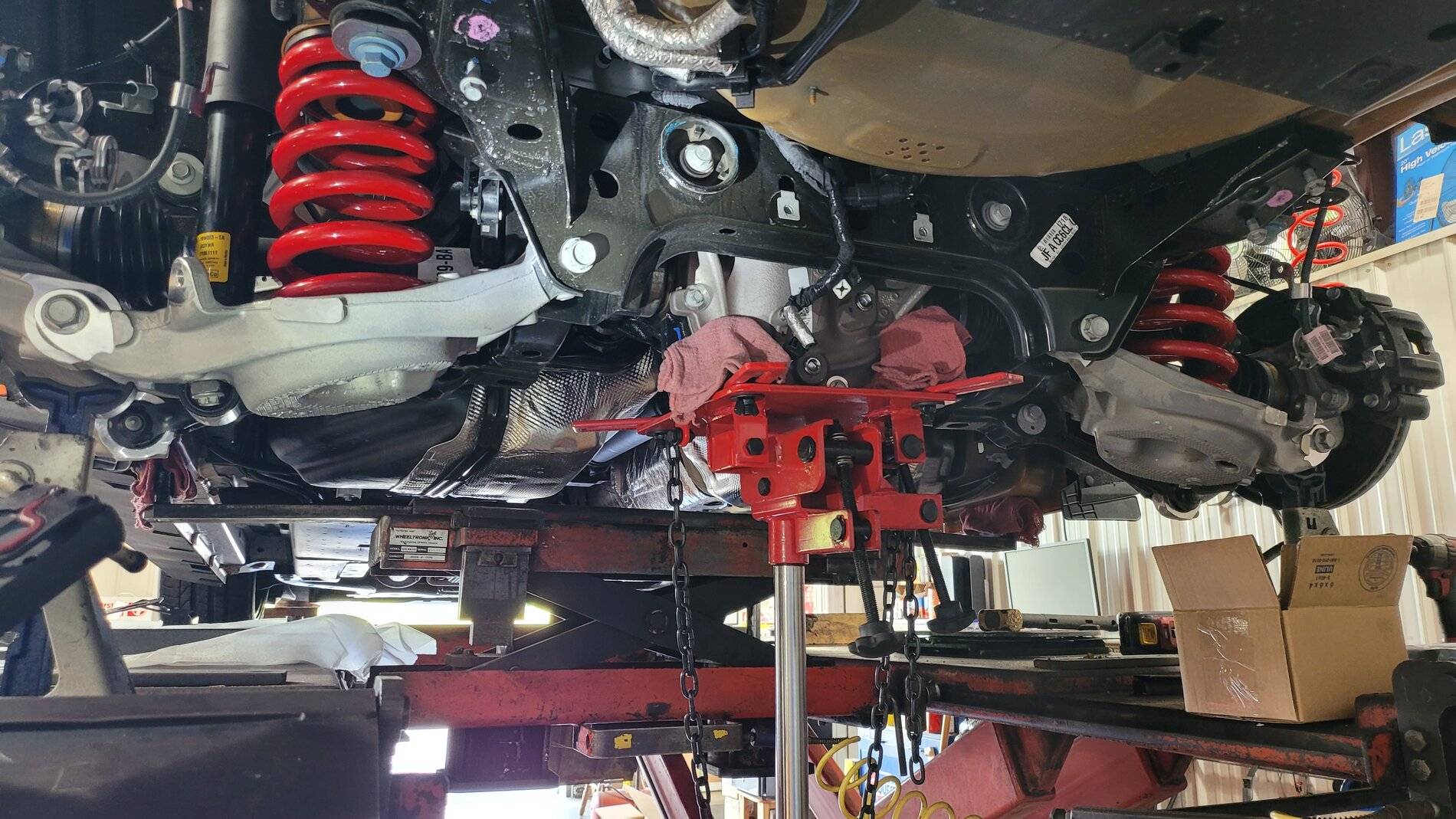

Started mods yesterday and picked up the car today. Suspension done by race car driver and best suspension guy in 6 states. Started with lowering springs.
It doesn't look like it in the photos but it's much lower.

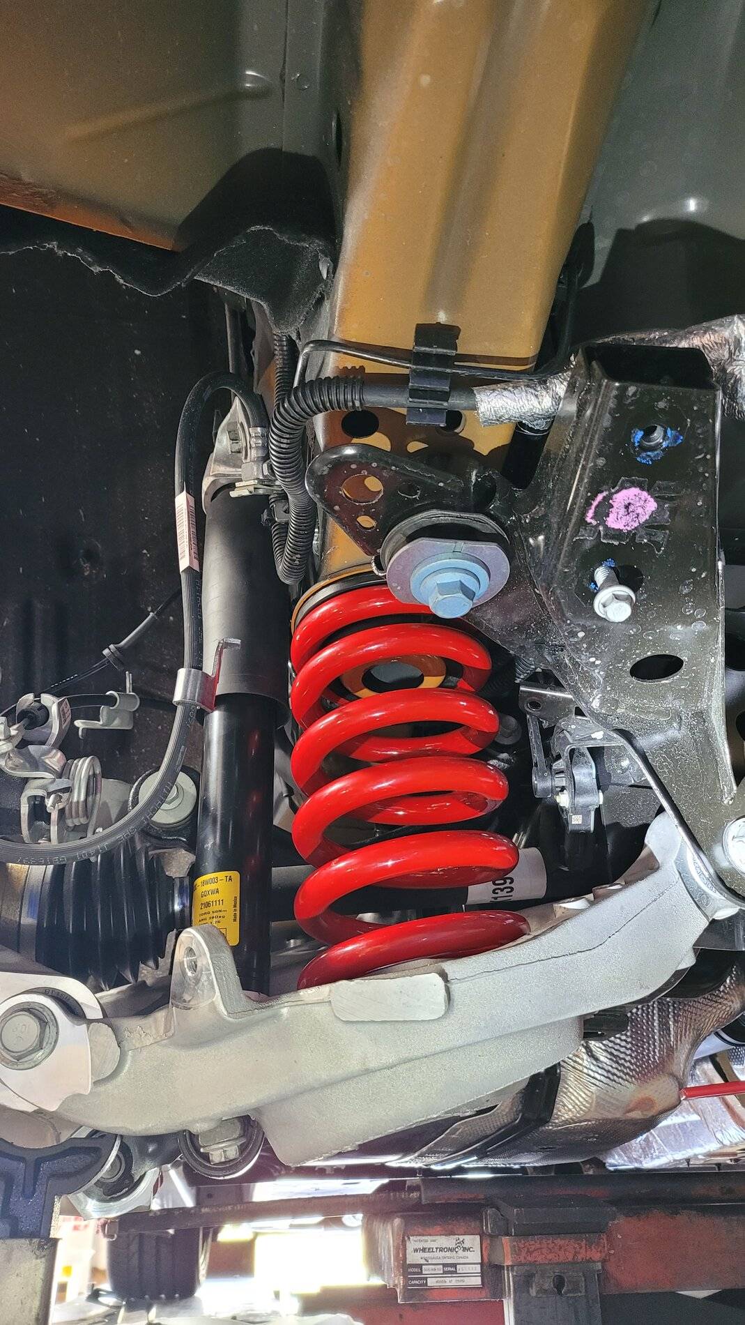

BMR Racing springs.

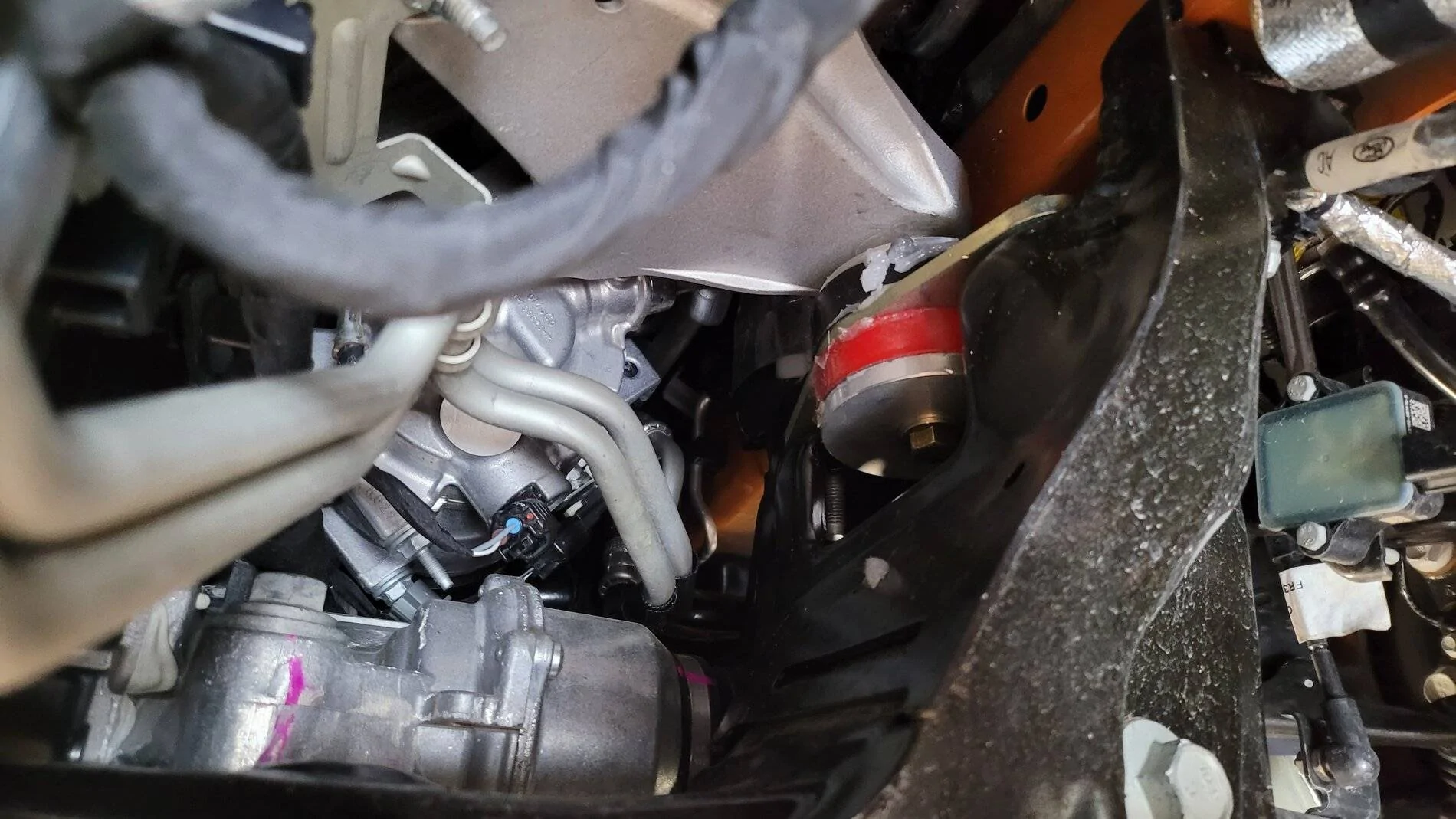

Did Steeda bushings.

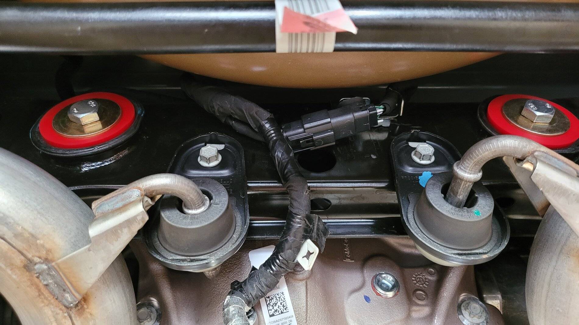

The dealer did the Steeda motor Mounts so the tower brace could be installed.

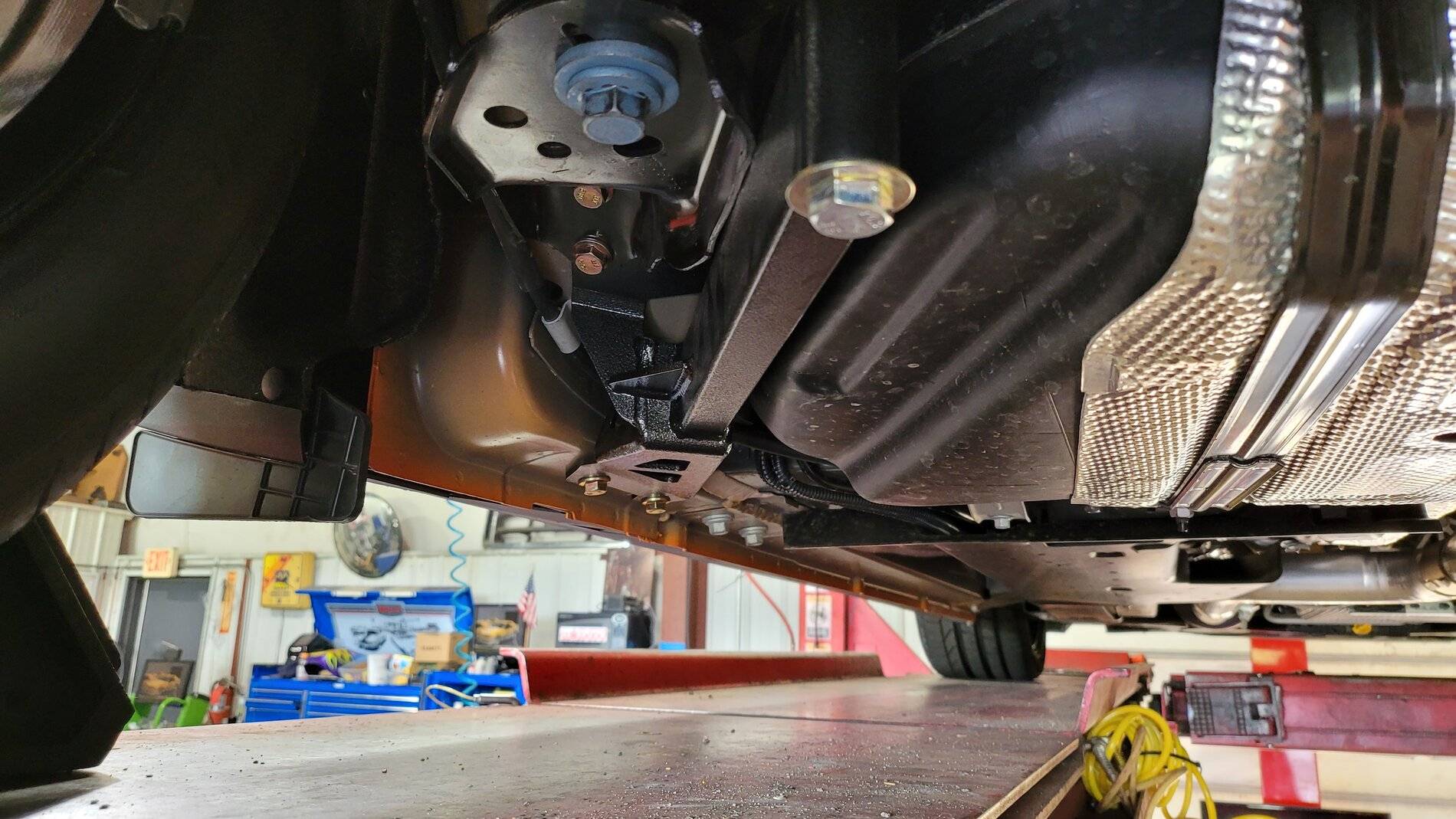

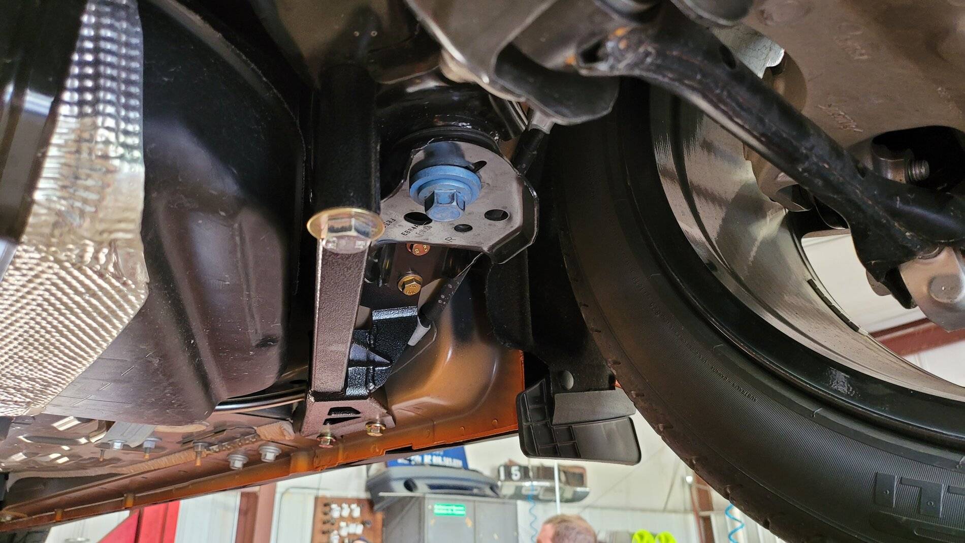

Got the Lethal Performance IRS brace kit.
