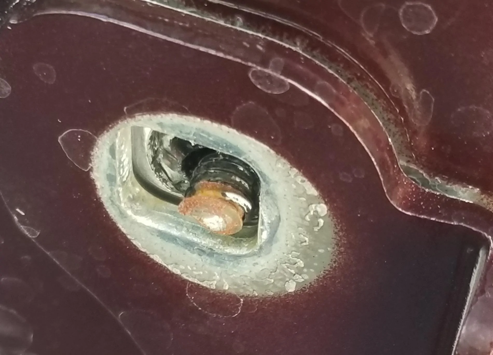

That's what concerns me, but we'll see for sure later on... maybe there's some magical slimline version he works with. Either way, I have some quiksteel arriving today from Amazon (JB Weld is a little harder to get hold of over here, but quicksteel is pretty much the same thing).
Watch this space. I don't intend to keep this broken for long. I'll post after pics etc.

Any update? I've been working too much the past few days.
Hey, I actually just got back from his shop (he had to delay for a few days due to other commitments).
First of all, he said in no way would he ever recommend using cold-weld products for such a job. He was very confident about this and I believe him.
Fortunately for me, I still had some thread left on the stud and he was able to tig weld a new thread on.
I wouldn't have even thought what he did was even possible (not that I have any clue about welding!), but he was super confident and did the job perfectly; I'm very impressed and as you can imagine, much less stressed knowing that it's fixed.
Steeda got back to me and apologised for the error and offered me a discount on further products and suggested that the best solution to a completely stripped stud, would be a rivet nut, but they couldn't be 100% certain of the interior construction of the bonnet so obviously said proceed with caution and YMMV.
I'll say this, my friend was quite nervous about drilling into the bonnet to re-thread or fit a rivet nut, as, like Steeda, it's impossible to know what's on the other side. I think we're pioneers here!
I wish you all the best of luck in fixing this, it's such a crappy situation.

Try an easy out/screw extractor. Use a high speed tool (Dremel) to smooth the end of the broken bolt and start a pilot hole, then drill the pilot and use the extractor. Take your time and go slow. Practice with the high speed tool on something you don't care about if you have no experience. Good luck!
I've never been able to get one of those to work. They hate me.

A rivet nut if inserted property will work just fine.

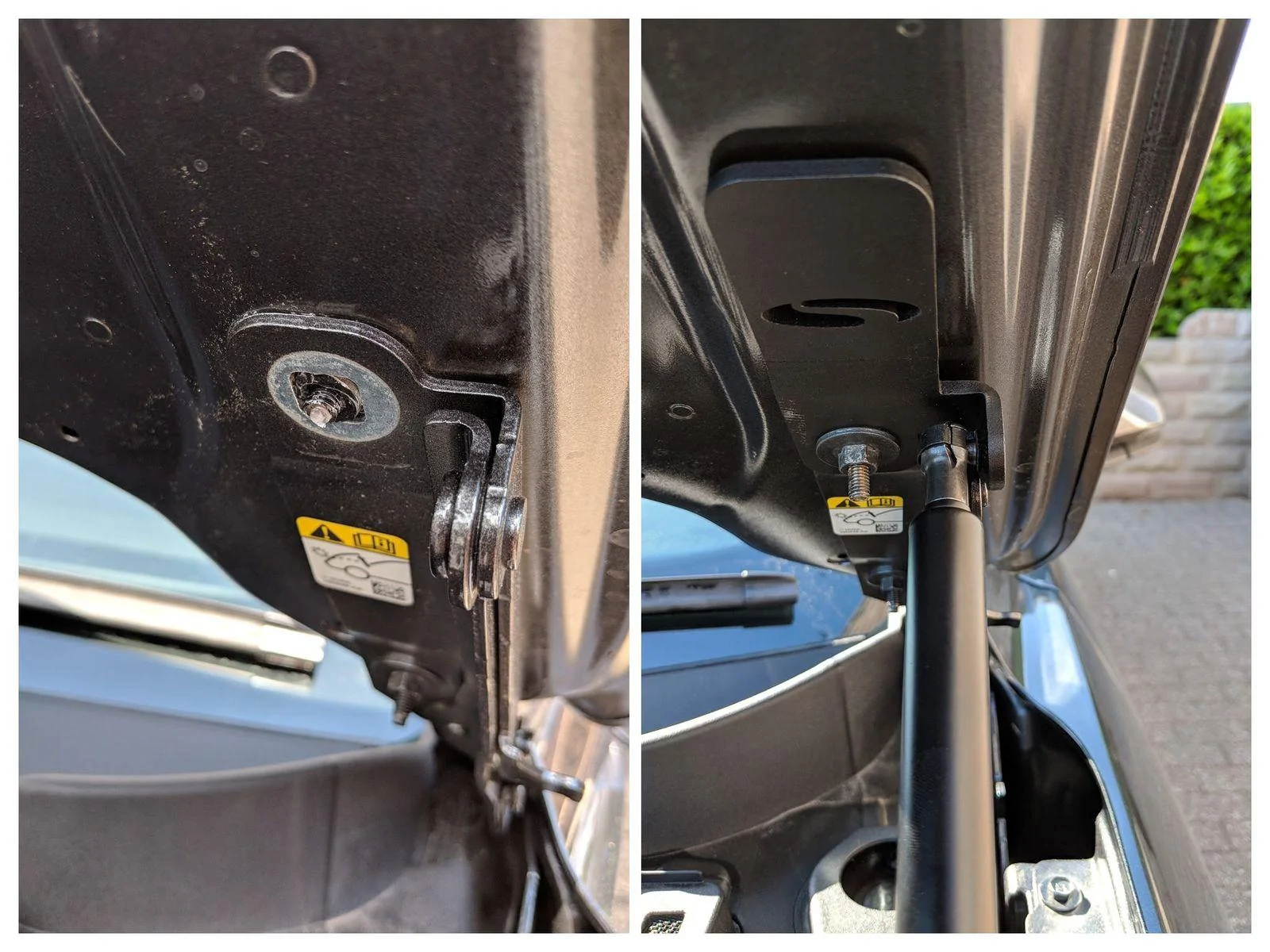

Did you keep the struts? I emailed Steeda before you even broke yours but I haven't heard back yet. I could take a drive over so they could get a closer look. Friendly shop!
How much thread was left? I have a little bit sticking up still. I'll post up a photo tonight.
I don't think that would be an option anyway. The stud isn't actually threaded in. You can't simply extract a stud in the way that you'd extract a broken bolt. It's press fitted.
Yes, the struts are actually really good and are now functioning great!
In regards to how much thread was left on, you can see from the left side of the image I just posted that there was very little left, maybe 4mm?

Very strange. I don't see an image in your post but I do see the image tag in there. I'll see if I can grab a quick shot of mine.
michail71
Apr 15, 2018
92
1,225
214
2018 GT 401a A10
Here is mine.
