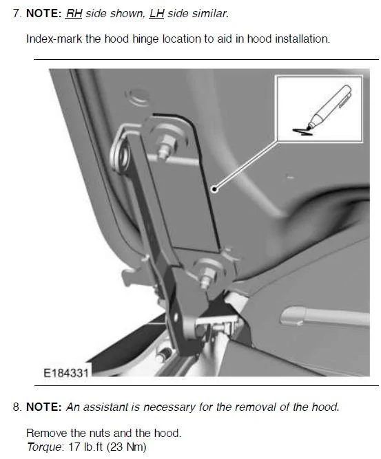

I was installing hood struts today and I snapped the driver's side top bolt on the hood. :(
I rechecked my torque setting several times at 17 lb. I'm not sure what went wrong.
Were the threads dry or lubricated?

The male threads are studs that are permanently attached to the hood, and nuts hold the hood on to the brackets. Not bolts.

The stud is probably welded into the hood ... can't tap anything.

This will only work if you have bolts going into the hood. If they are hood studs you will need to have a shop install a new stud and paint repair may be necessary.

>>>>>>its a carriage bolt flang installed inside before hood panels are bonded together. Its not threaded into the backing flange, just panel adhesived or spot welded. You cant “unscrew” it as tbe head is all one piece w bolt threads.
55-58 Chevy hood is real studs threaded into internal threaded flange.
