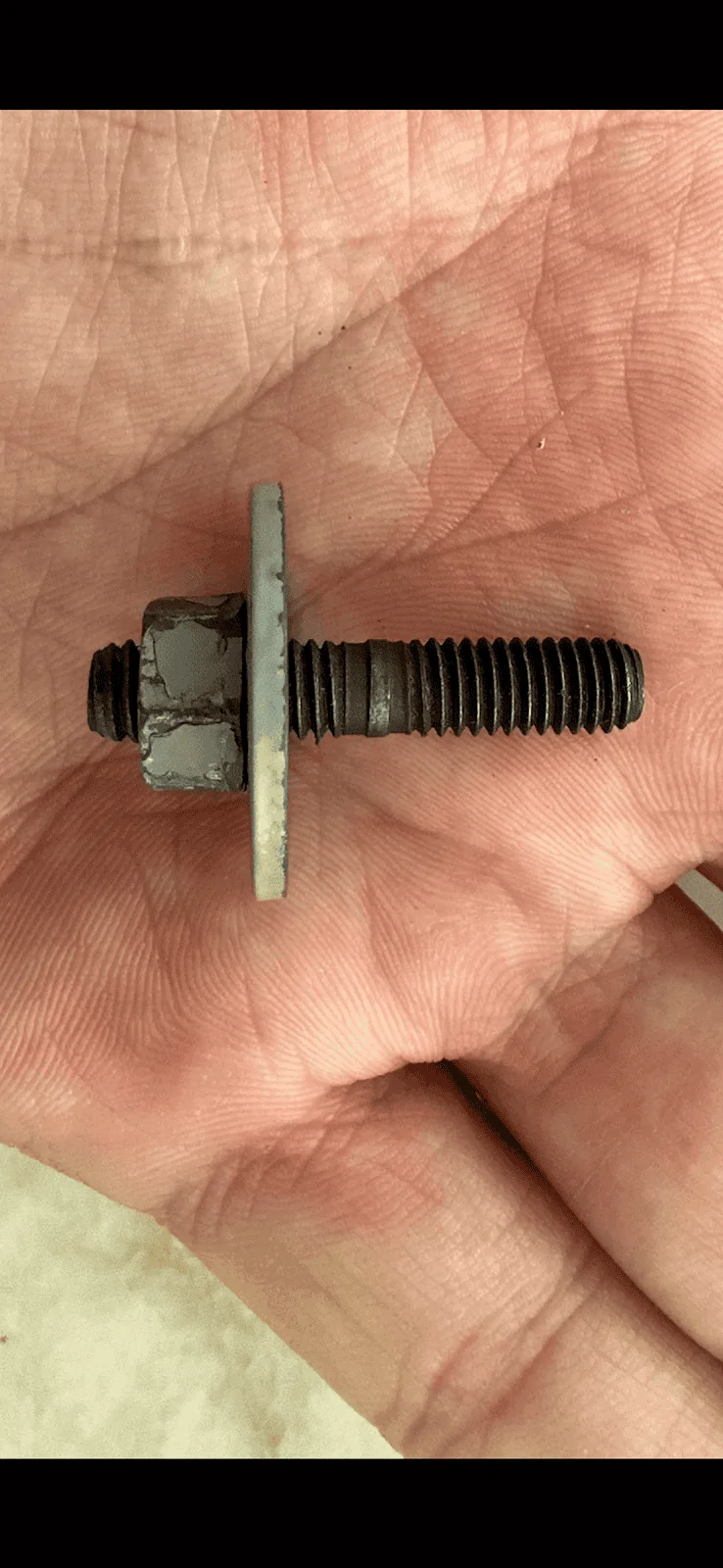

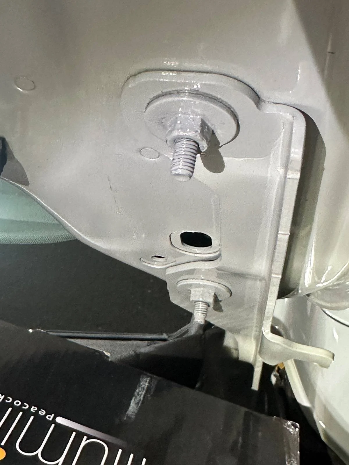

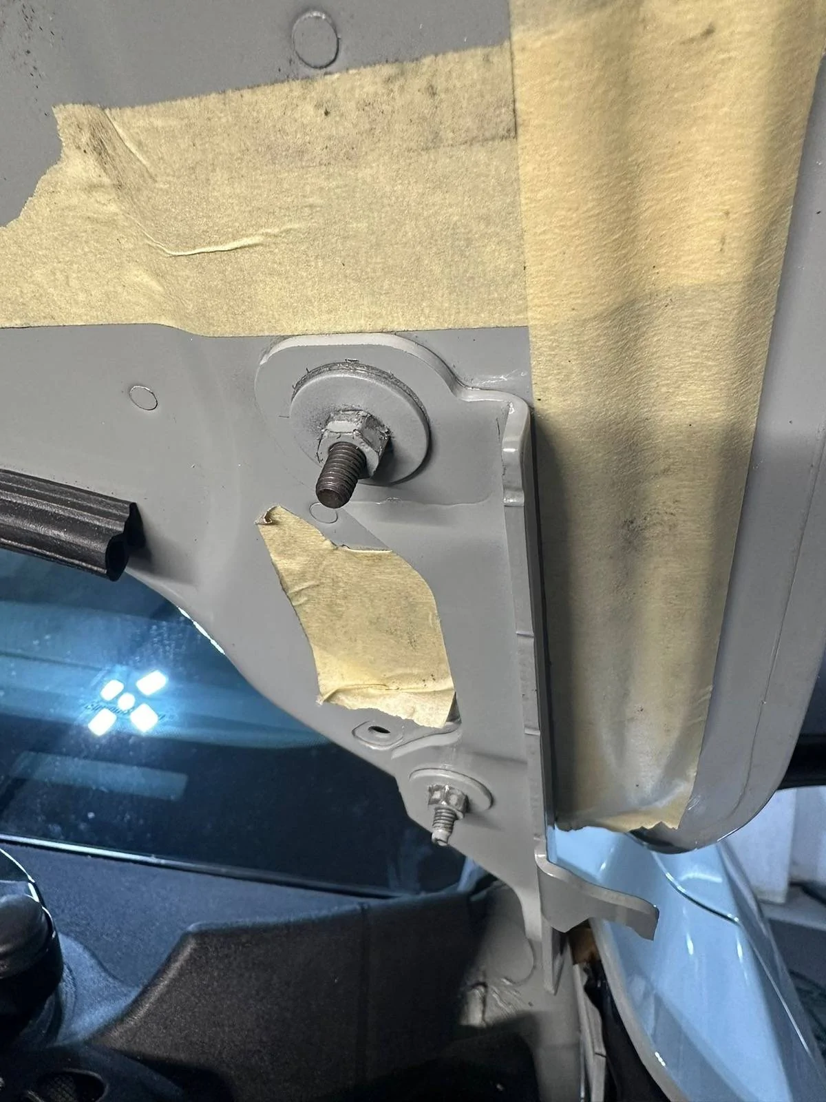

Hey all I have just been through this. planned to drill down the bolt, tap it out, re-thread it, and put in a double sided bolt so I can retain the some washer/nut. Turns out what's under there is a bolt and washer welded together so not thick enough...

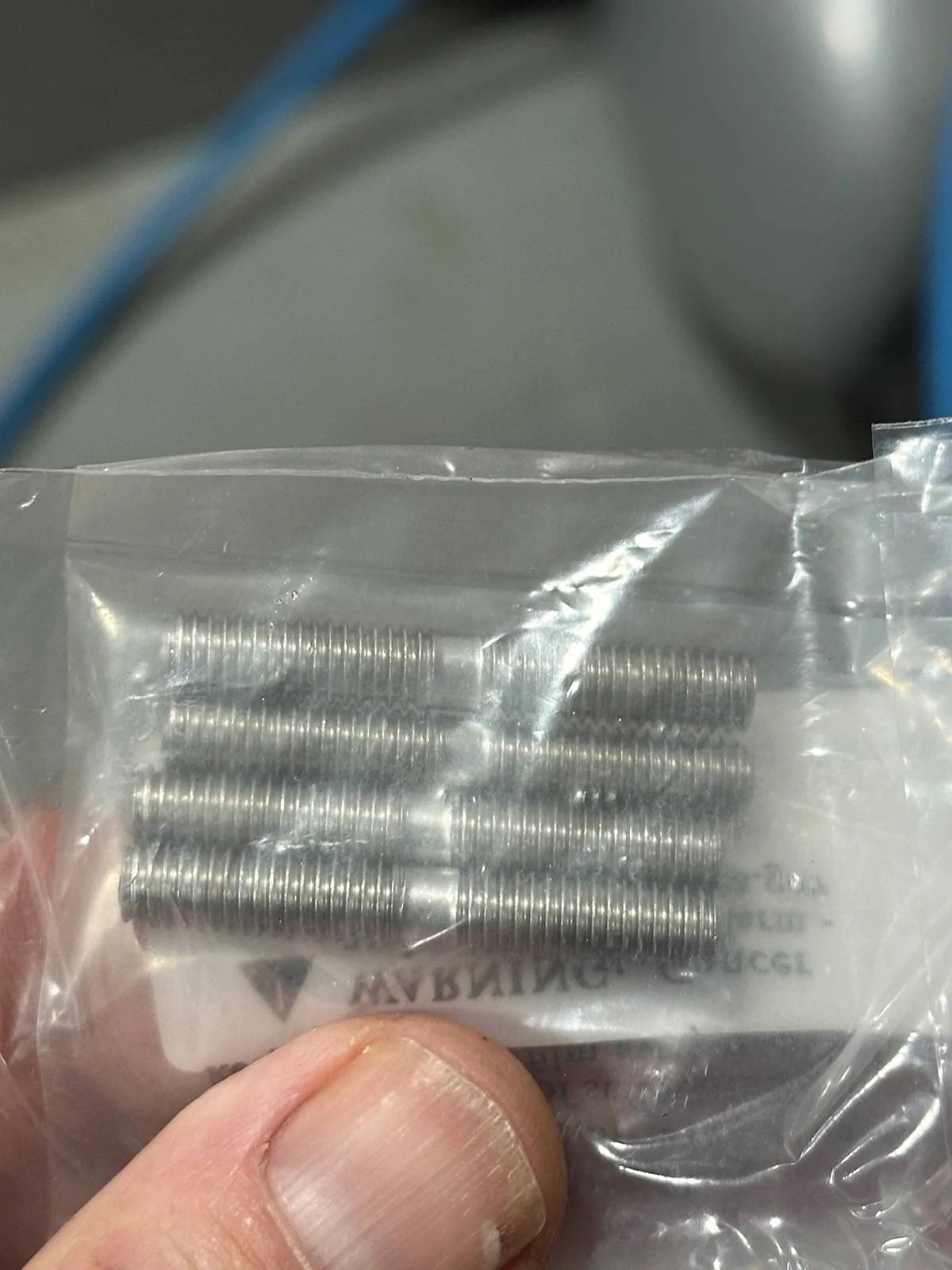

Plan B. drill out hole and use a M6 riv nut, then double sided m6 stud from ace hardware...
I then screwed the hem nut back on and used a paint pen to paint it up. looks like new!!
