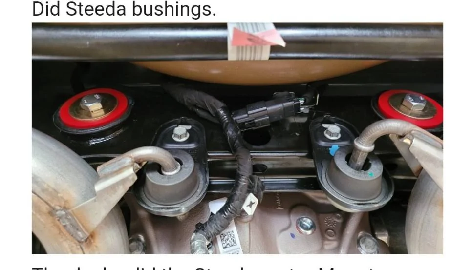

Started mods yesterday and picked up the car today. Suspension done by race car driver and best suspension guy in 6 states. Started with lowering springs.
It doesn't look like it in the photos but it's much lower.
BMR Racing springs.
Did Steeda bushings.
The dealer did the Steeda motor Mounts so the tower brace could be installed.
Damn local dealer charged me $75 to retorque them during oil change.
Got the Lethal Performance IRS brace kit.
Started driving the car along country twisties and suddenly I heard a grinding when I hit the brakes. Immediately headed back to the shop. Drove like 10mph and used paddle Shifters to slow down.
Turns out the right front caliper was coming off. The owner kinda freaked as he'd only seen that once and it was on a race car. They used blue locktite but the bolt came out and flew down the road somewhere.
The used another bolt and used red locktite on everything and rechecked the torque on every bolt.
Lemme tell ya I was shaking a little as it scared me so bad.
The car also had huge noises from the suspension which the guy said was normal.
After 20 miles all the noises went away. It's super quiet. But it drives like a demon glued to the road.
That was my day.
How was yours?
So you didn't get any NVH from adding these Polyurethane bushings?
Matthewstorm
Matthewstorm
Jan 31, 2021
87
1,763
815
NC
Matthew
2021 Mustang GT Premium
No, none that I could tell. For the first 20 miles the car was creaking pretty badly. But after it settled it's great. That's probably more due to the springs.
