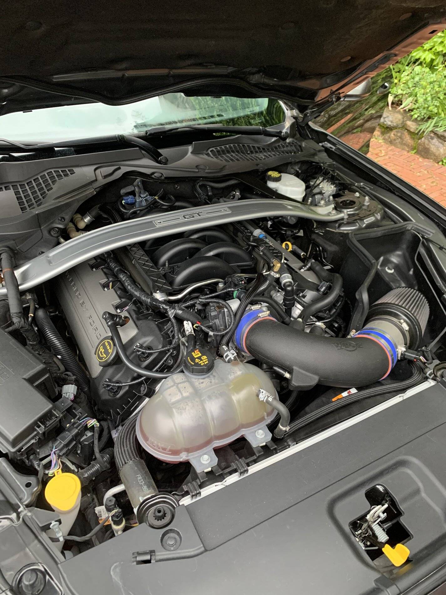

Stock tune + your mods is gonna be a problem. With the mods you have, it should run like complete shit if the mods are on the car. TB, CAI and IMRC locked out is a big issue for the stock tune. Take a picture of your engine bay with the engine cover removed. You need to confirm what's on the car before you go much further.

Car has C&L CAI, GT350 throttle body and intake manifold and MBRP long tubes. Thinking I am just going to get an OEM exhaust and a new tune. Seems like the easiest option

WTF would any tuner lock out CMCV (IMRC) on a gt350 intake manifold on a 2nd gen?
Oh Bama. Get a tune from someplace good
Look at the rear of the manifold and see if the CMCV control canisters are on it.
If they are I would opt for the Ford performance 3 tune. Then add plug foulers for the rear o2's. That tune carries the CARB eo#

Well roll that back, you would also need the gt 350 CAI. They sometimes become available in the classifieds.

I zoomed in on your engine and the control canisters are there but the vacuum lines are not. The accumulator is also missing.
Take it to a good mustang shop preferably one that tunes and get it sorted out.

Idle bypass is MIA as well, it's very much needed. His C&L is a no tune required CAI iirc.
