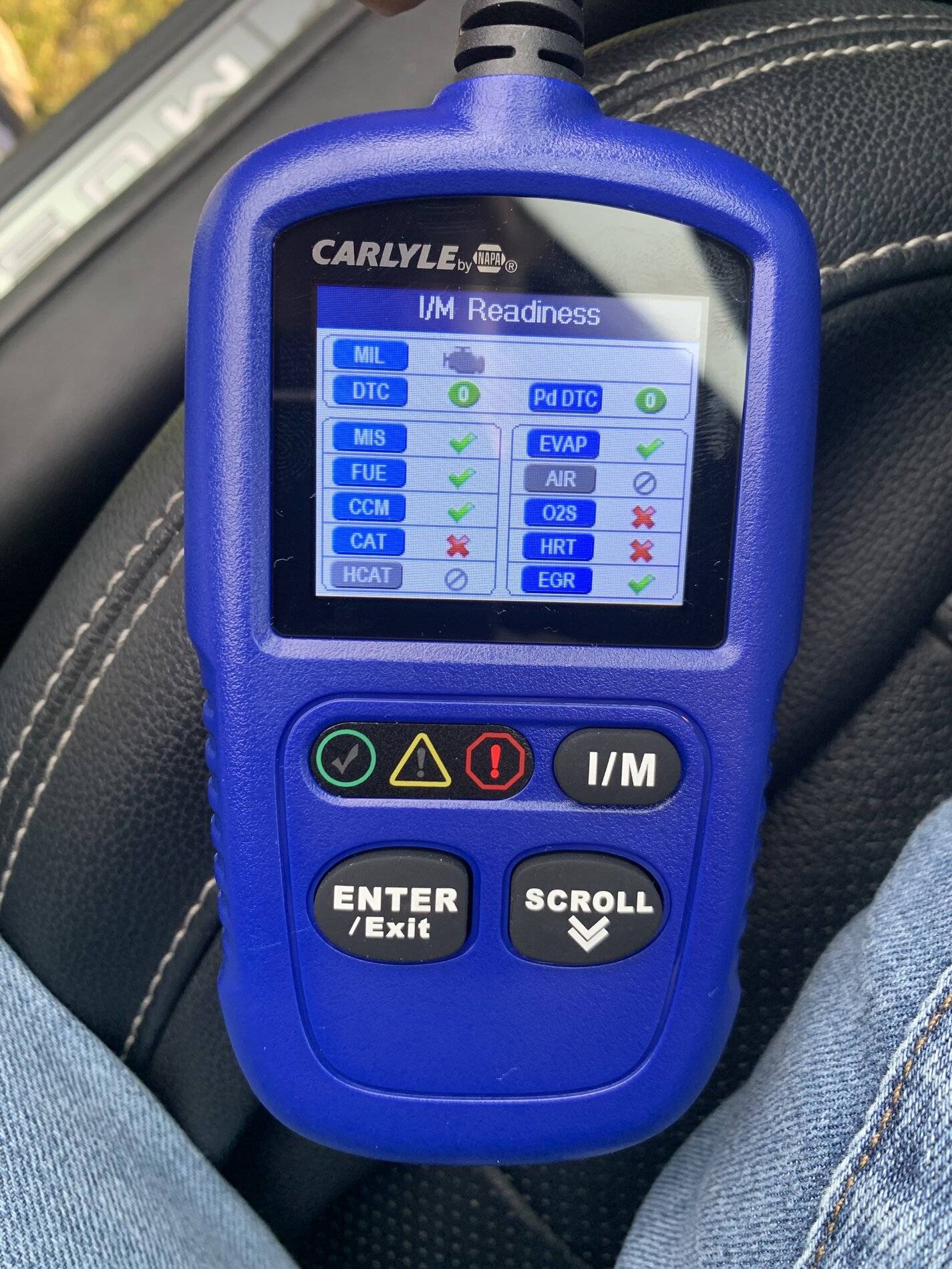

I just need 7 out of the 8 monitors ready so if o2 defoulers would solve O2S and HRT that would get me there

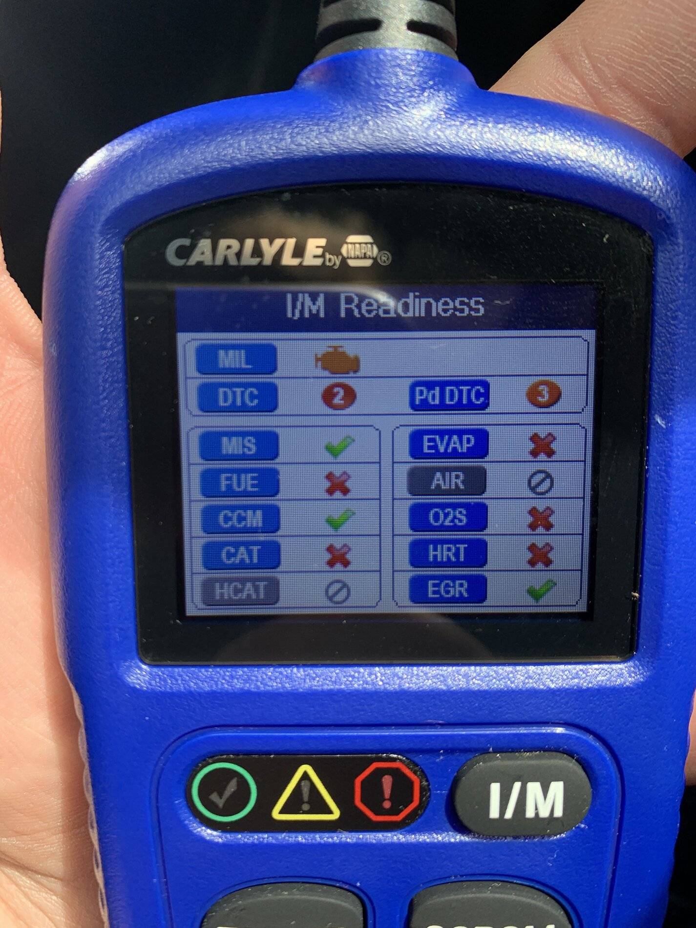

It's showing DTC's and pending DTC's I believe. It will not pass with those.
Only shows those on the stock tune. When driving on the custom tune this is the result
What are the DTC's and Pending DTC's? Something in your tune is causing the monitors not to run. Short of a different tune, nothing you do is likely to change that.

Post drive cycle on the stock tune. Seems looks like I may just need to pick up stock headers/cats and an inspection specific tune
2 of those will go ready with more driving and a cold start or 2. It just took me 161 miles over the weekend for my CAT monitor (no cats), and EVAP to go ready. I would keep driving the car, and wait long enough to either see a few more go ready, or a CEL to pop up, and then you’ll know what your next step should be.

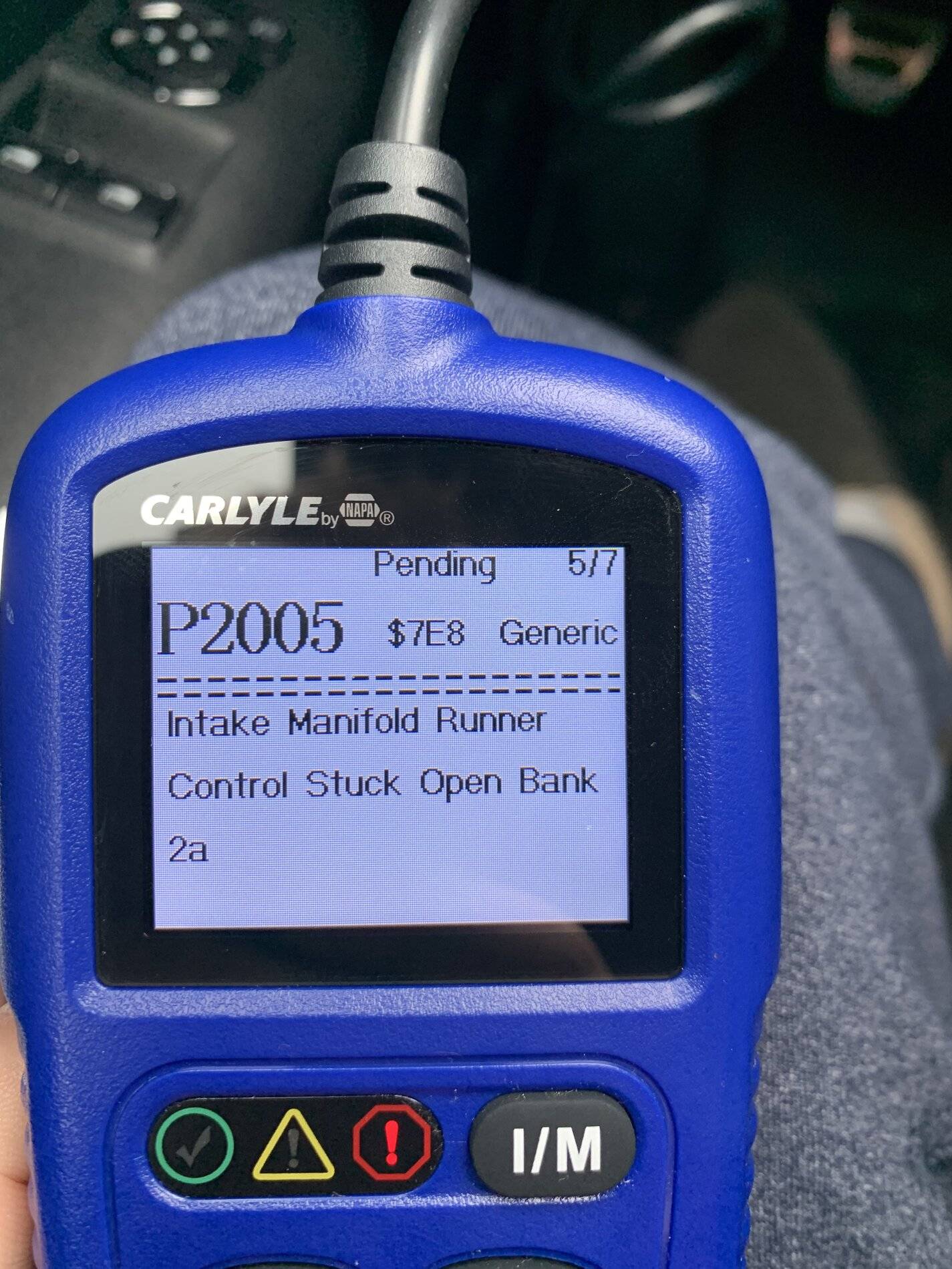

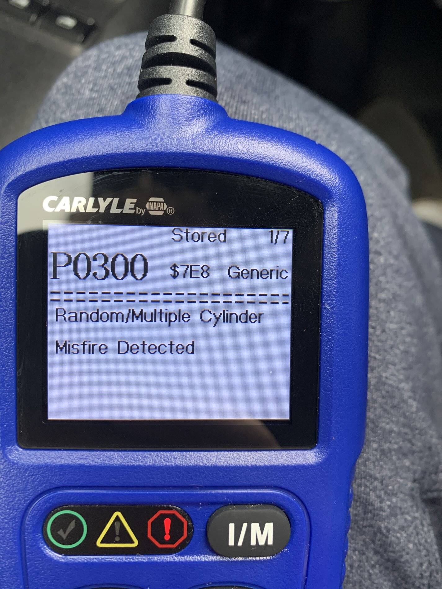

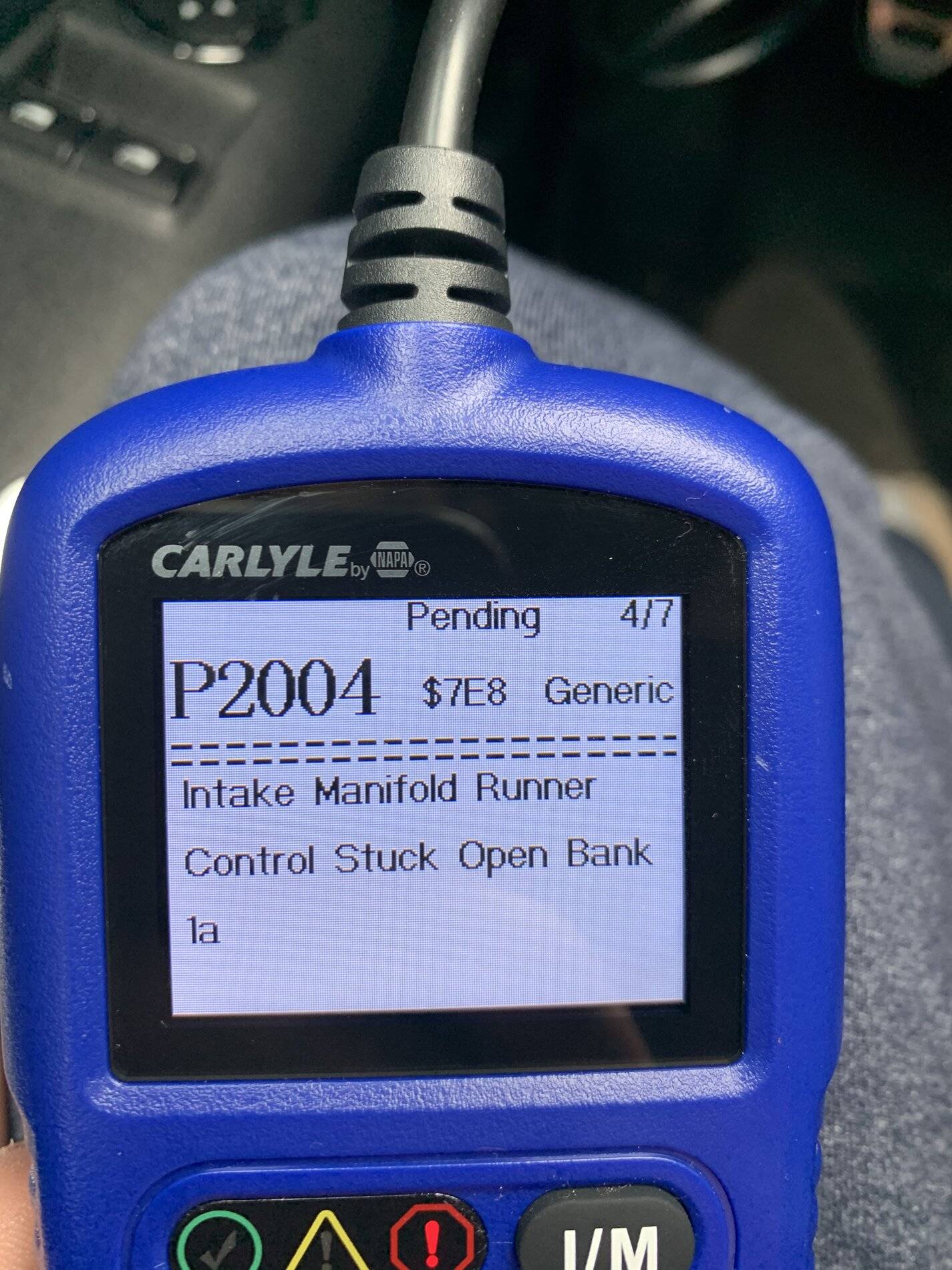

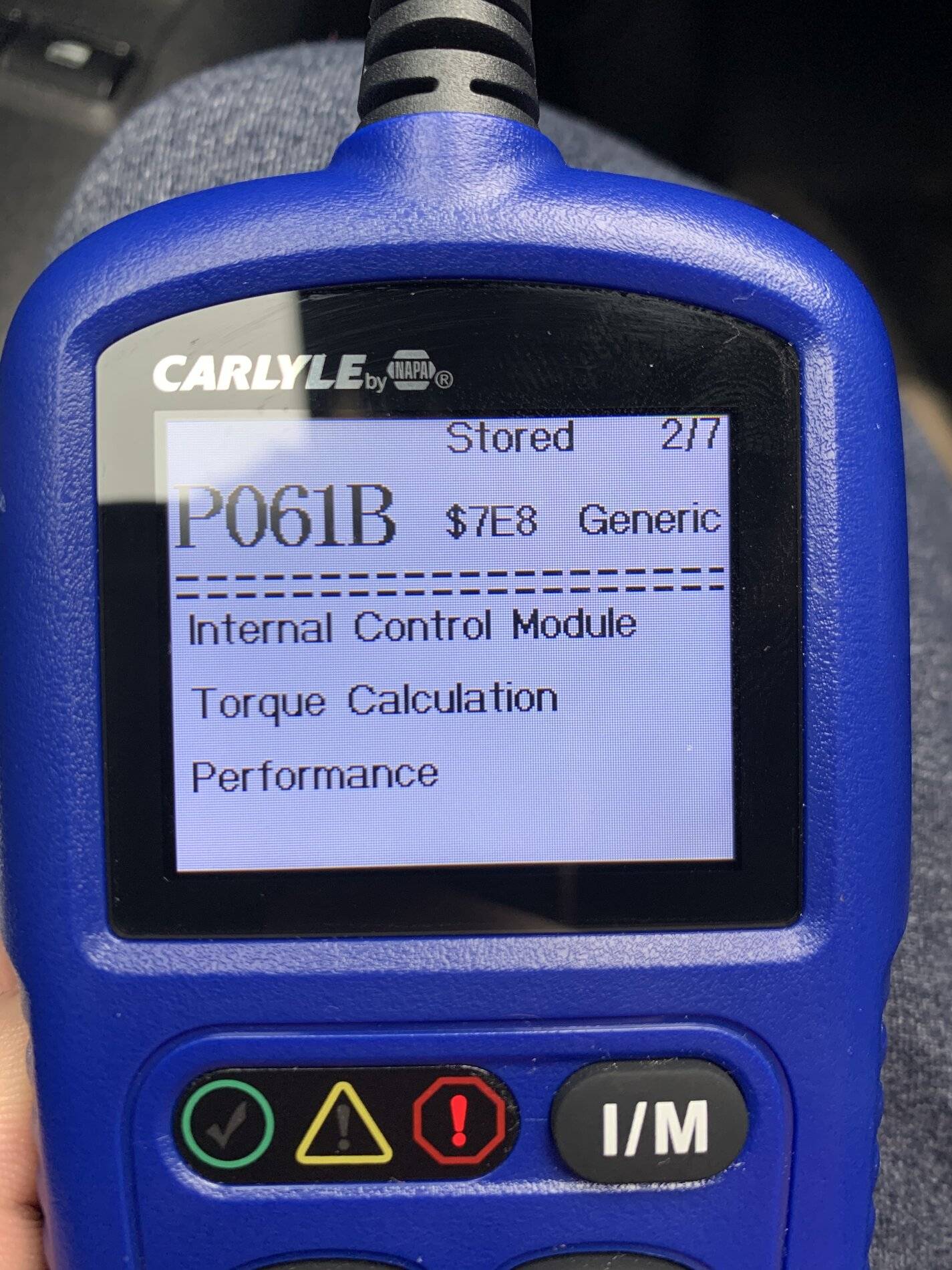

Check engine light is on, pictures of codes are attached
Those are mostly all tune related. Looks like you’ll definitely need to contact your tuner to enable all emission systems or go back to stock.
